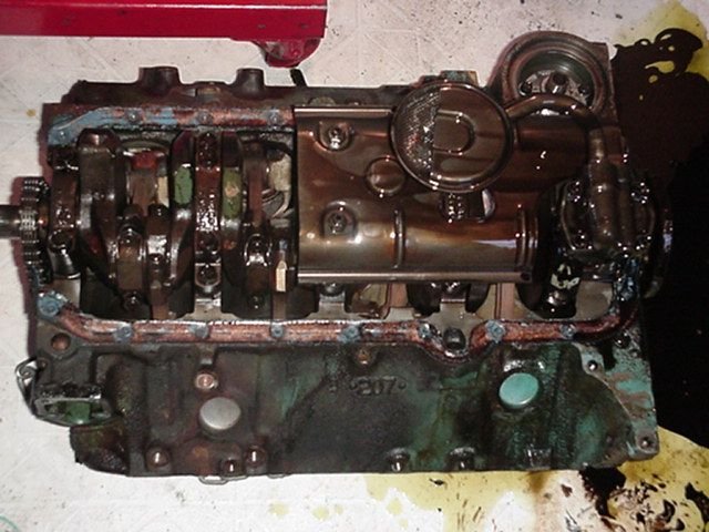

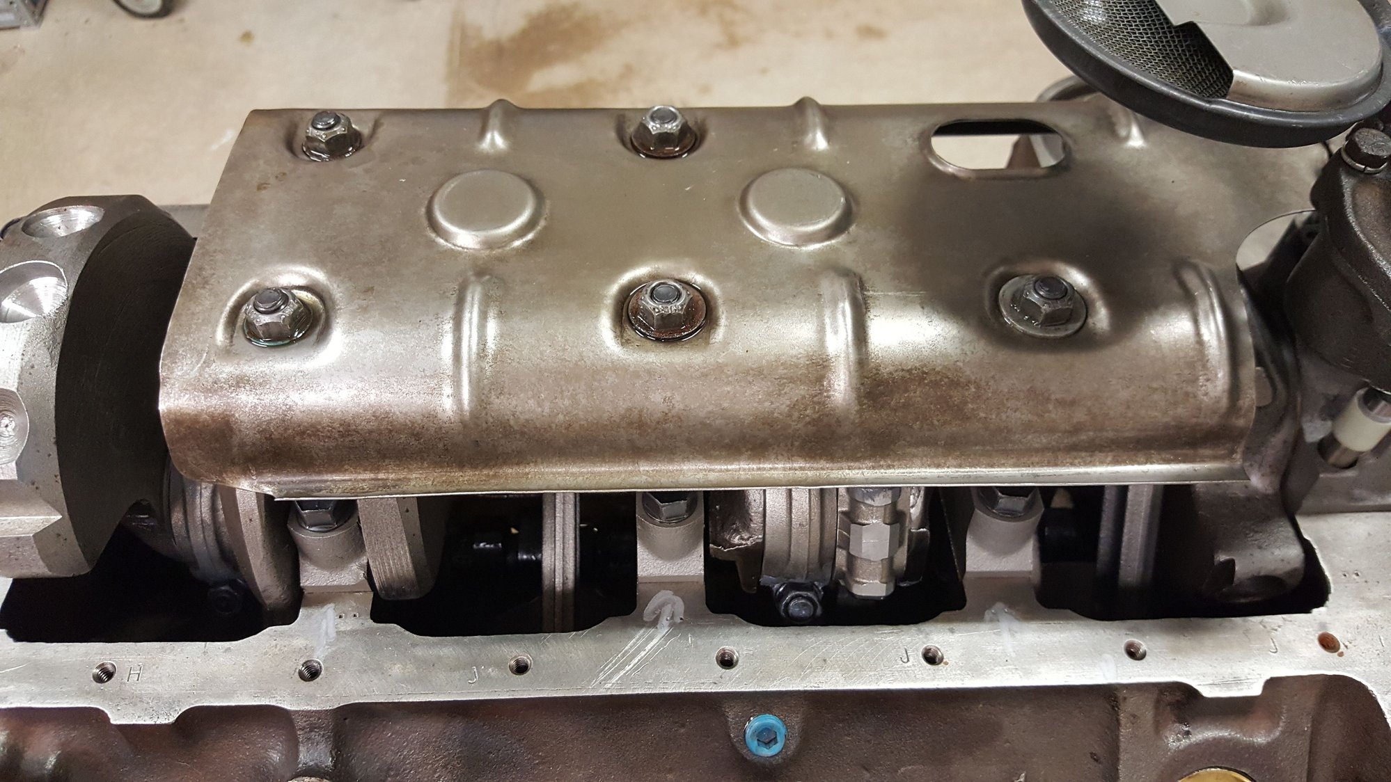

There are 2 different oil pump pickup screens - one "regular" small block, and one Corvette-unique that fits the L79 and L82. The length, angle, and curve of the pickup tube is completely different on the two different pickups, and they will not interchange. You have the "regular" pickup, and it's not going to fit your baffled L82 pan.
Standard SBC pickup:
Corvette Pickup:

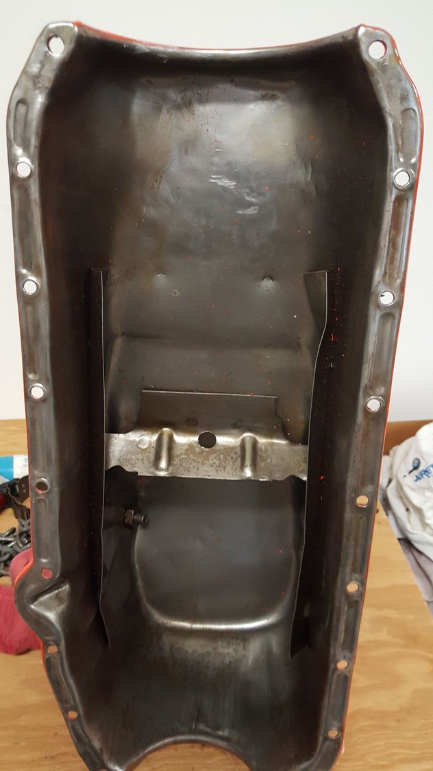

From an '80 L-82, uses the long reach pickup
It is year specific depending on the year of the pan. ....There is a Melling 55-S1 which is shorter reach forward used in the earlier Vettes while the Melling 55-S3 (which is the longer reach forward) is used on an '80-82. Note the short length windage tray as the earlier full length tray will not fit the late C3 pan. Melling has a good lookup feature on the web site that has pictures and part numbers for the different applications.

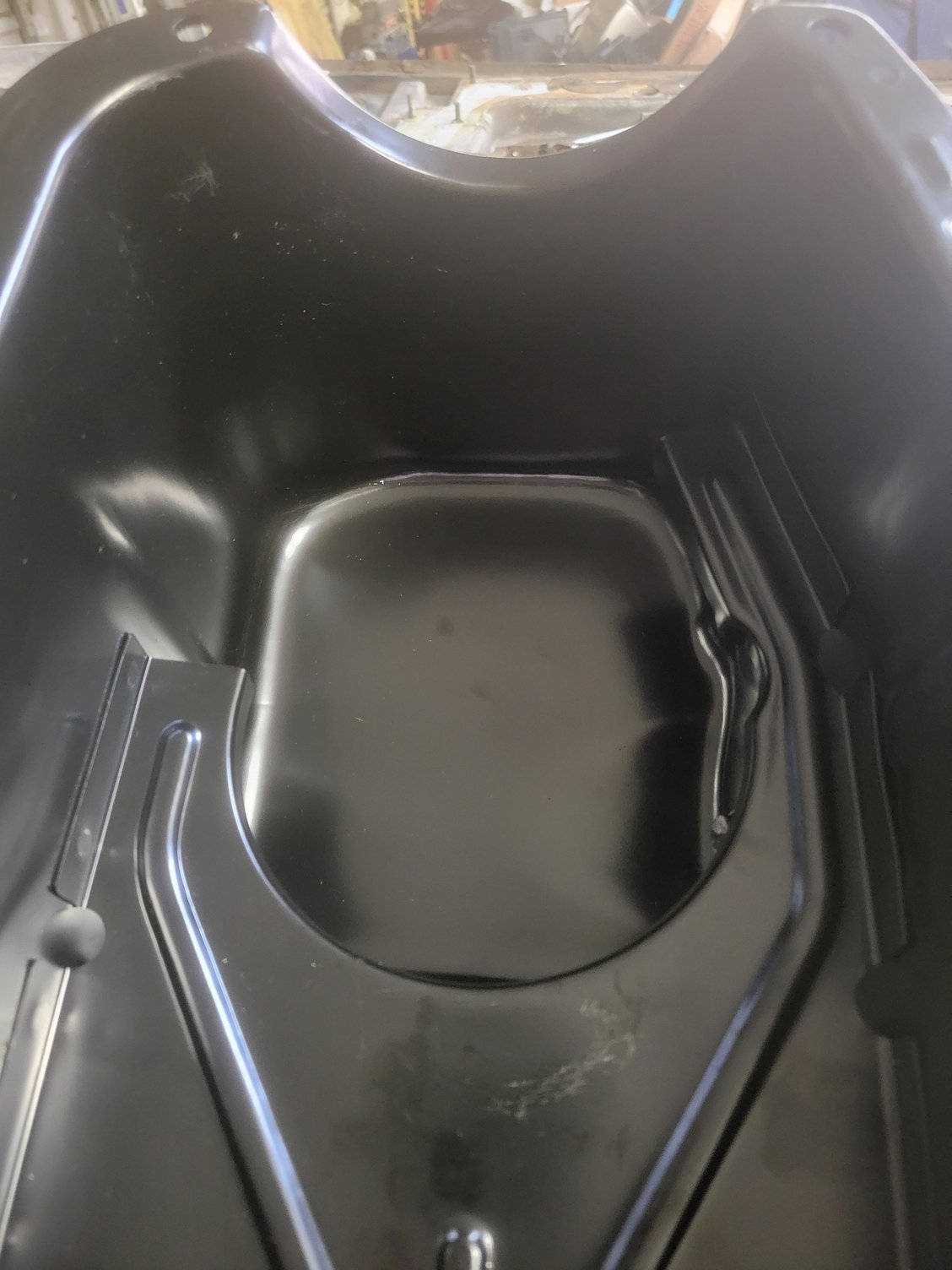

The '79 L-82 uses a different pan with a full length windage tray and a short reach to the front pickup. The sump is not as long as the earlier Corvette pans.
Long windage tray used on a '79 L-82. Many other applications.
Short length front to back sump uses shorter reach to the front pickup. Note the 2 rails on either side to mate up with the long windage tray.
Short length front to back sump. '79 L-82 pan. Requires the short reach front to back pickup.

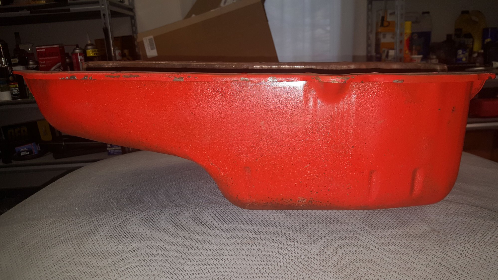

Note the longer sump length front to back. 1970 Corvette pan. Requires the long reach to the front oil pump pickup.

I get the longer sump for more oil capacity at a higher ground clearance, but pairing that with a farther forward pickup seems counterintuitive for oil starvation under hard acceleration.
