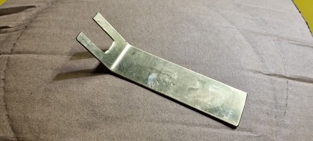

on my '72 i made my own tool for the "jesus" clips removal on the lock *****.
I just used a thin 1mm thick 25mm wide piece of brass shim (just what i had laying around) and cut a 12mm wide 18mm deep groove.
slight bend in the handle to enable slide it in behind.
place a rag over the **** when you push the clip out otherwise you'll know why it's called a "jesus" clip, jesus where the f'k did that go......
