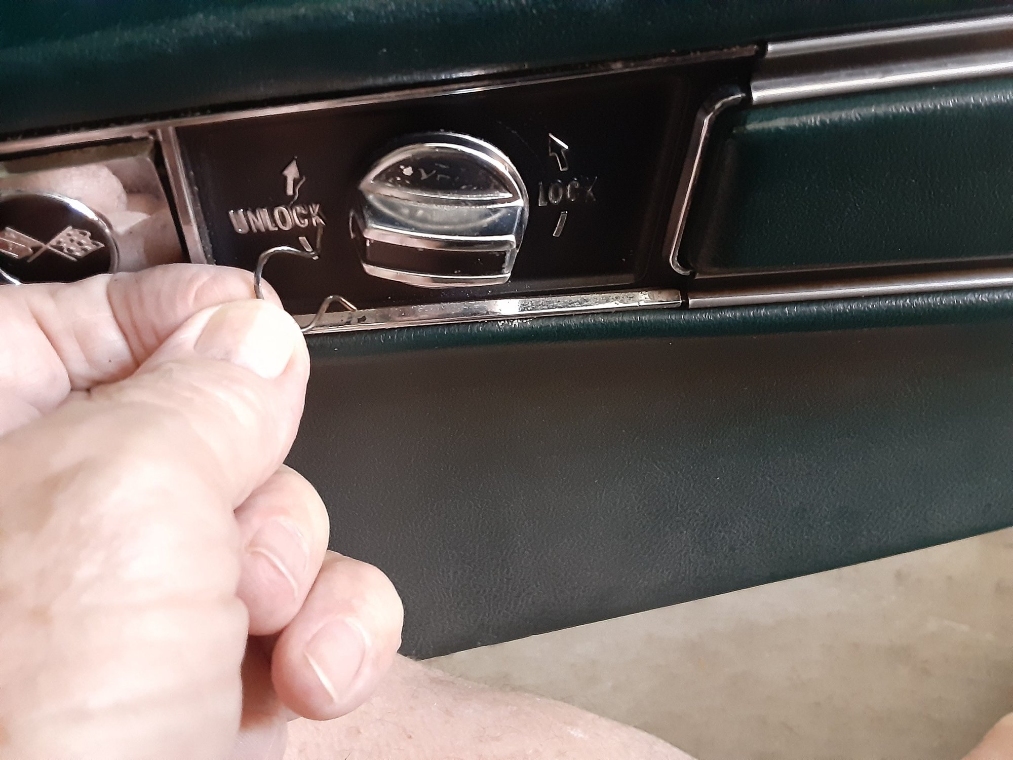

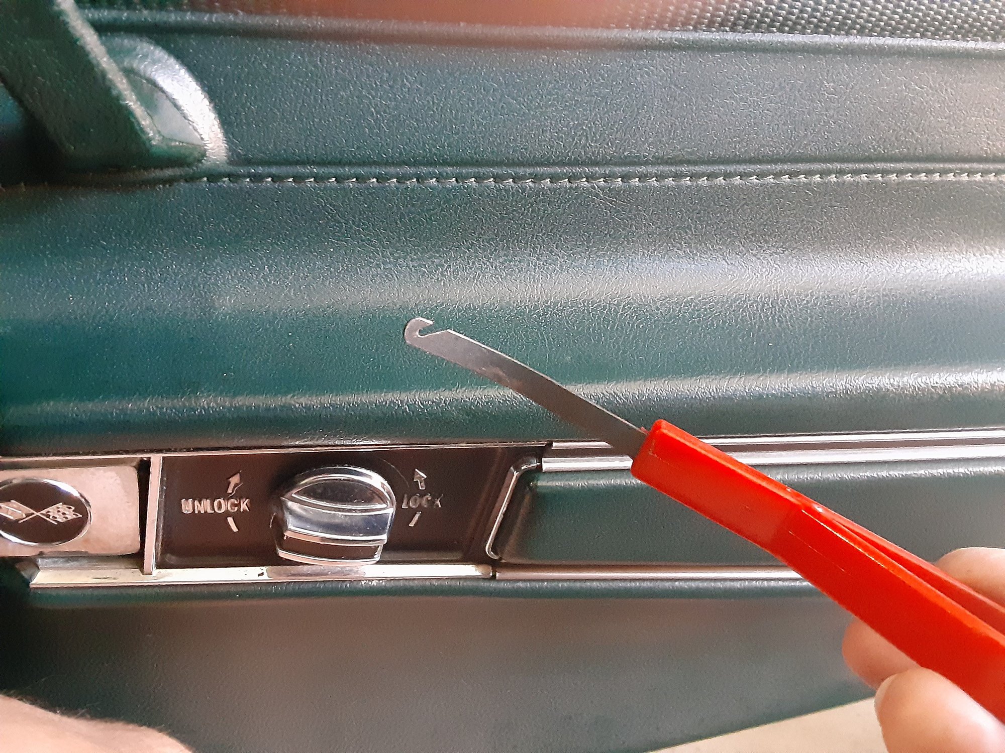

In case you've never removed the door lock **** before, here's a visual of how I remove mine with my sewing needle.
I just went out to the garage and removed it for a demonstration.

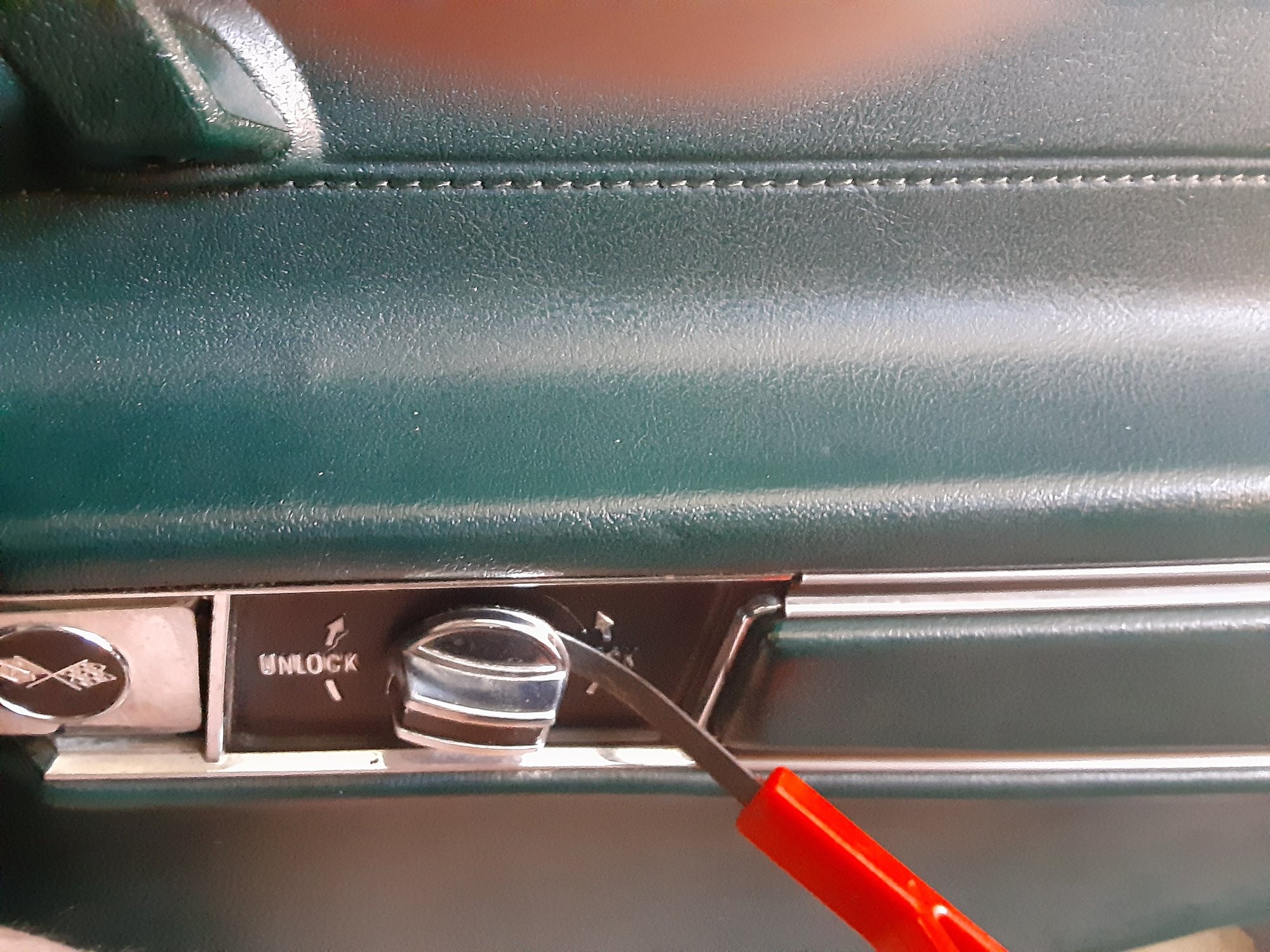

The blade fits into the slot and pushes the clip outward.

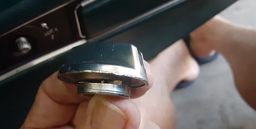

With clip back into position, push it back on to the lock stem to secure it.
