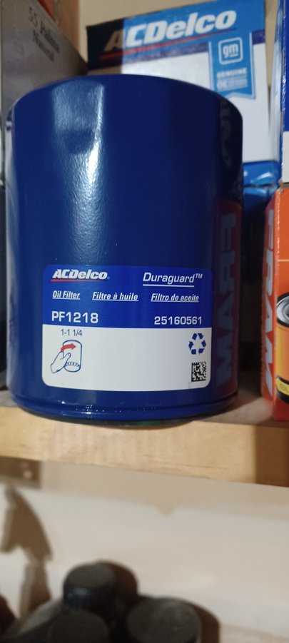

PF1218 for me, please.
exactly the one i use..last 3 changes anyway..
USA made..6 bucks on amazon ..gm oe brand.
the last wix i got was chinesium so no more for me.
ac 25 micron…wix 21 as stated.

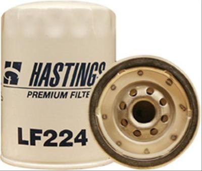

Ummmm….Hastings LF224… I believe that’s the number.
Steve O.

Didn't know Hastings was still out there. I wonder if they still have the densite media and the heavy case.. always used the 2 qt truck filter
