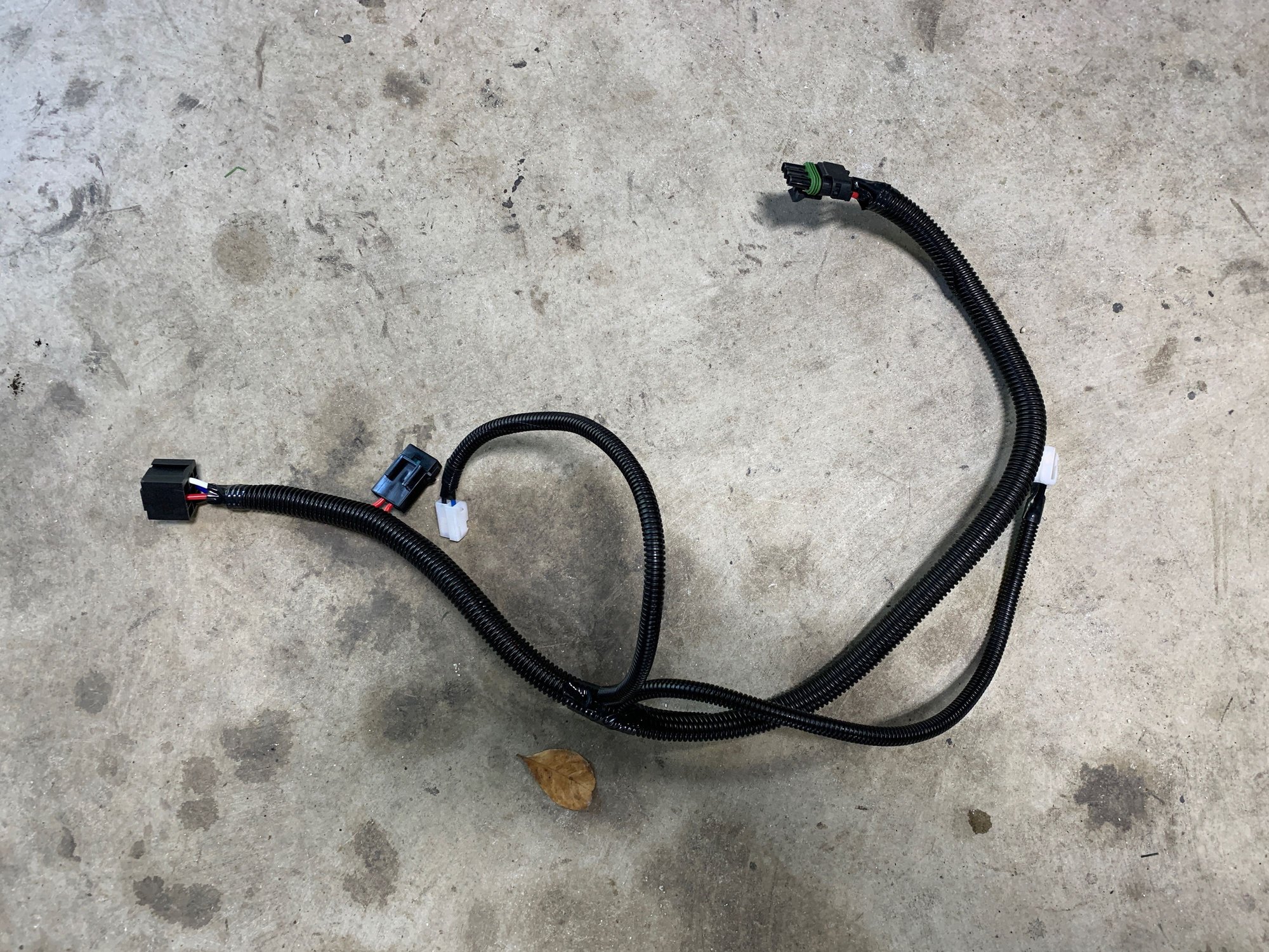

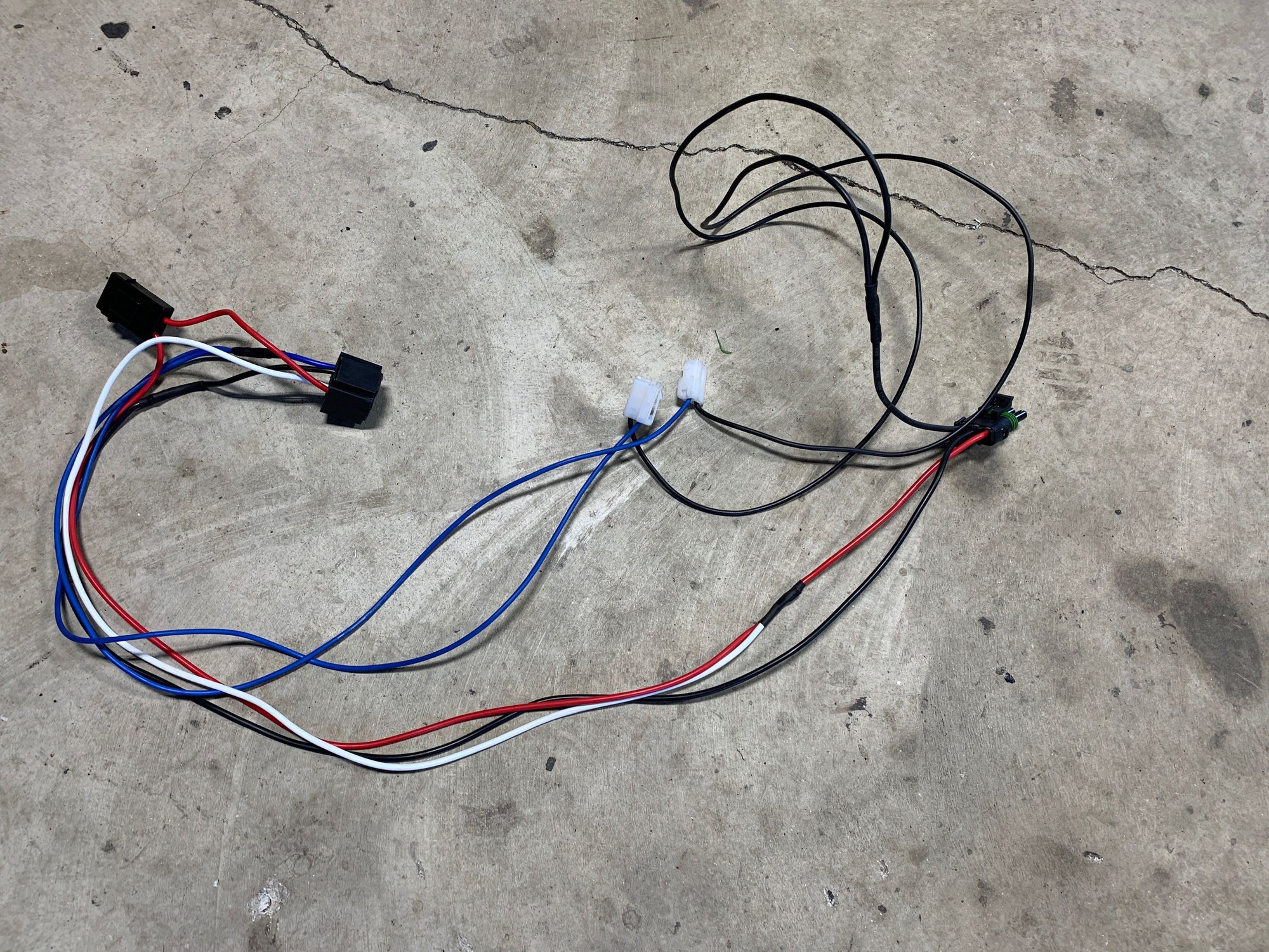

Thanks for the input! Why two relays? The radiator manufacturer says that one relay is enough for two 12" fans, and supplies one relay with the radiator. (They call for two relays for two 16" fans.) And why two temp sensors? Do you use one per fan?
As far as the hose and filter, that replaces the glass filter that was there when I got the car. The hose is new high pressure (I forget how much) injection hose that will handle the 50 psi going to the fuel pressure regulator. I wasn't able to reuse the stock metal line when I removed the mechanical fuel pump (which didn't work with the Vortec engine). Is there a danger from the hose? I suppose I could replace the filter with a metal one, and the hose with braided line.
In my setup, the fans draw a lot of current. 12 to 14 Amps each just spinning while the car is not moving. The startup current is even higher, which is one reason folks sometimes use a PWM fan controller. At any rate, folks with dual fan setups have reported failures of the single relay, so the second relay is for redundancy. If you are monitoring your gauges, you should be able to make it home on one fan. You will NOT make it home on zero fans in stop-and-go traffic. Of course, in zero traffic, if your car is tuned properly and you are always moving, you don't need any fans at all!
Two temp sensors, or a fan controller, would let the fans come on in sequence. This reduces load on the electrical system. Modern cars do this, at least ones with two fans. It also reduces the single point of failure that my system currently has: If the switch fails, or the connector brakes, I will have zero fans. But I'll hear the silence, even over my headers, and I'll notice the gauge climbing. At least, I hope so.

That makes sense about the fans, and I ordered the Mitsubishi fan PWM fan controller described in another thread here, along with the temp sensor. But for now I just used the single relay so I can get this car driving! I made a simple harness and plugged everything in -- worked the first time! I also got new bleeder screws for the left rear caliper, and was able to easily bleed the brake. The old screws must have been plugged up. I replaced the factory temp sensor in the passenger side of the block with the sensor that came with the radiator. But I still can't drive the car! I cross-threaded the radiator overflow fitting, and stripped the threads on the fitting. The fitting is made of soft aluminum, roughly the same hardness as cheese. So I got a 1/16" NPT tap to clean the threads in the radiator filler neck, and am still waiting on a replacement overflow fitting. Hopefully tomorrow I can drive it. I also have a new eBay special HEI distributor to go in, although the car should drive without it. I also cut out all of the remaining computer controlled carburetor wiring under the hood -- I still need to do a little cleanup on it. I continue to remove paint anything that is bolted down, like hood prop, underhood light, wiper motor, etc. I also wiped down the underside of the hood, not shown in these photos. It cleaned up surprisingly well, and makes things look a lot better. I'll hit it with the pressure washer once I can drive the car out of the garage.

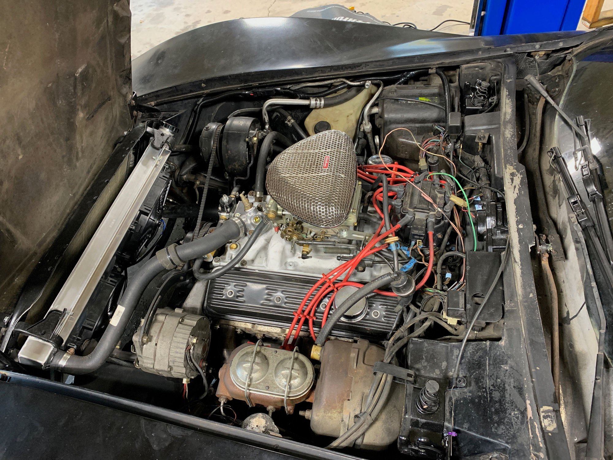

The new radiator/shroud/fan combo is in. It bolted in with no extra work at all. And I see the price is down to $219 on Amazon.

This car did not come with the stock air cleaner, so I can't be sure, but the dimensions of the aluminum radiator seem to be identical to the stock radiator, so I would guess yes. I bought the foam seals for the top of the radiator, but I think I need some more foam to go across the top of the rad. I guess normally the air cleaner would be there? Also I saw that the radiator/shroud/fan setup is down to $209 on eBay.
Also, yesterday I had to move the car off the lift, so I fired it up thinking I would take it out of the garage and around the block. As I started it, I wondered, "how will it fail me this time?". I drove forward about five feet, and the car died and wouldn't restart. Eventually I figured out the fuel pump wasn't running and the float bowls were empty. Later that day I got out the Power Probe and injected 12v+ to the pump and found it still worked. Then I found no 12v battery power to the controller, and finally found a blown fuse for whatever unused computer circuit I used for the pump. That is a really inaccessible fuse panel. I think I popped the fuse when I cut out the computer wiring under the hood without disconnecting the battery. I must have shorted power to ground with the cutters. Hopefully today I'll get a chance to drive it.

hey man, I was sorting out the radiator and only review was the rad is 1/2 inch short in height.
I saw where you ordered bigger rubber but ended up using
orig rubber.
would you say the rad is in firmly or do I have to bend the top mounts.

I did bend the top mounts slightly to make the fit a little tighter. Yes, the rad is mounted securely. I didn't measure the top or bottom of the radiator tanks before ordering the rubber mounts. I should have gotten 2" instead of 2 5/8".

Or, you should have gotten a 2 5/8" radiator.
But if this works, that's great! That whole setup is half the price of just the fans that many of us run.

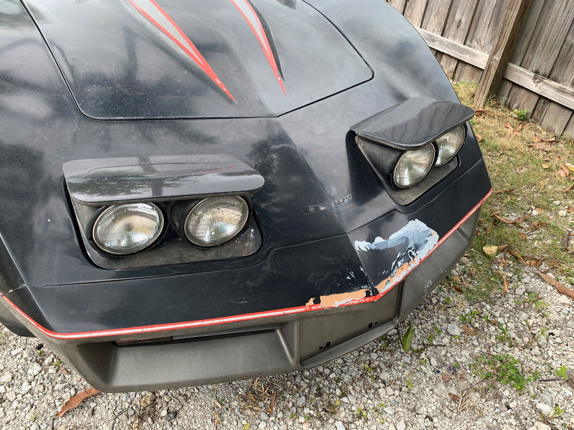

On the minus side, the headlights are now stuck up. I really didn't make any changes in the vacuum system. After some googling I read about the switch under the dash, but that didn't help. I haven't had time to diagnose it, because I've been replacing the passenger window motor. Of course, I didn't read up on it before remove the motor, and now the regulator spring has come unwound because I didn't pin it. I spent quite a while messing with it without success, so I'll watch some videos today and see if I can figure it out. I suspect I'll have to remove the glass.

  • You can operate the headlights manually until you fix them, or upgrade to electric. Reach up behind under the front bumper.
