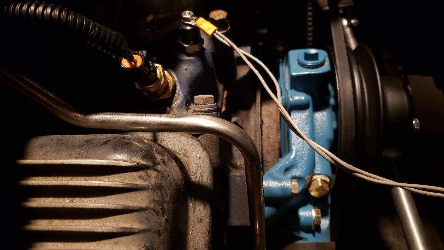

Are you putting the heater core back in service for some reason?
This might be slightly less Bubba, but, on a brand new water pump. The hose outlet on the intake was a great place to add a second calibrated water temperature sensor.

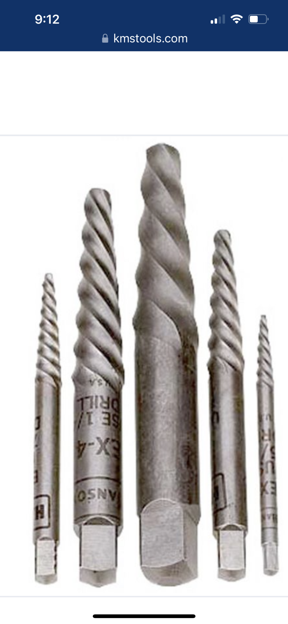

Originally Posted by rpiechowski
So here is the answer you have been waiting for..... Remove the square pipe plug... Get a set of internal pipe wrenches from Home depot. Use appropriate size and back it out... Under $20..
This is the best way.
An EZ-Out of the proper size might work, too. Worst case, you wreck your water pump, and are out $50.

Likes: 10
No different than removing a “close” pipe nipple.
use an easy out
