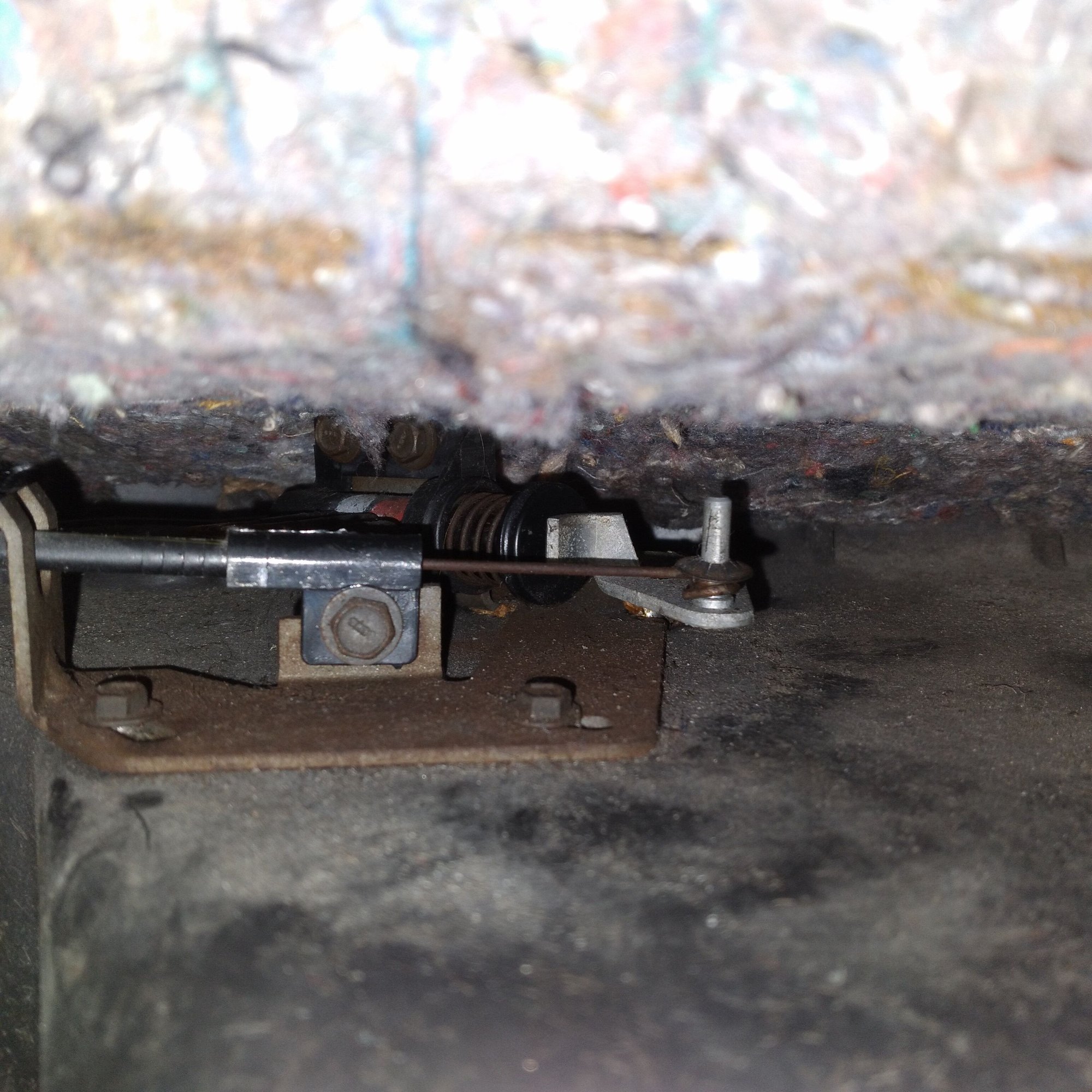

Hopefully you can see in the picture how far away the arm is with the cable pulled directly on too cold. It is not depressing the plunger at all

There is no set depth on how far the plunger should travel, the vacuum switch either sends a vacuum signal or it doesn't.
Cut a wedge from whatever handy so the hot water shutoff vacuum valve button is depressed.
Set the slider function lever to AC MAX fan speed switch to High Speed and try again...

FYI, looking at your hot water vacuum switch you have a early build 1979...Those vacuum switches are available through various vendors, late 79-82 vacuum switches are harder to find...

It may also be the cable is just stretched and there is just no adjustment left.
You could always remove the vacuum switch and with a round file slot the existing holes so when adjusted the switch sits closer to the arm..

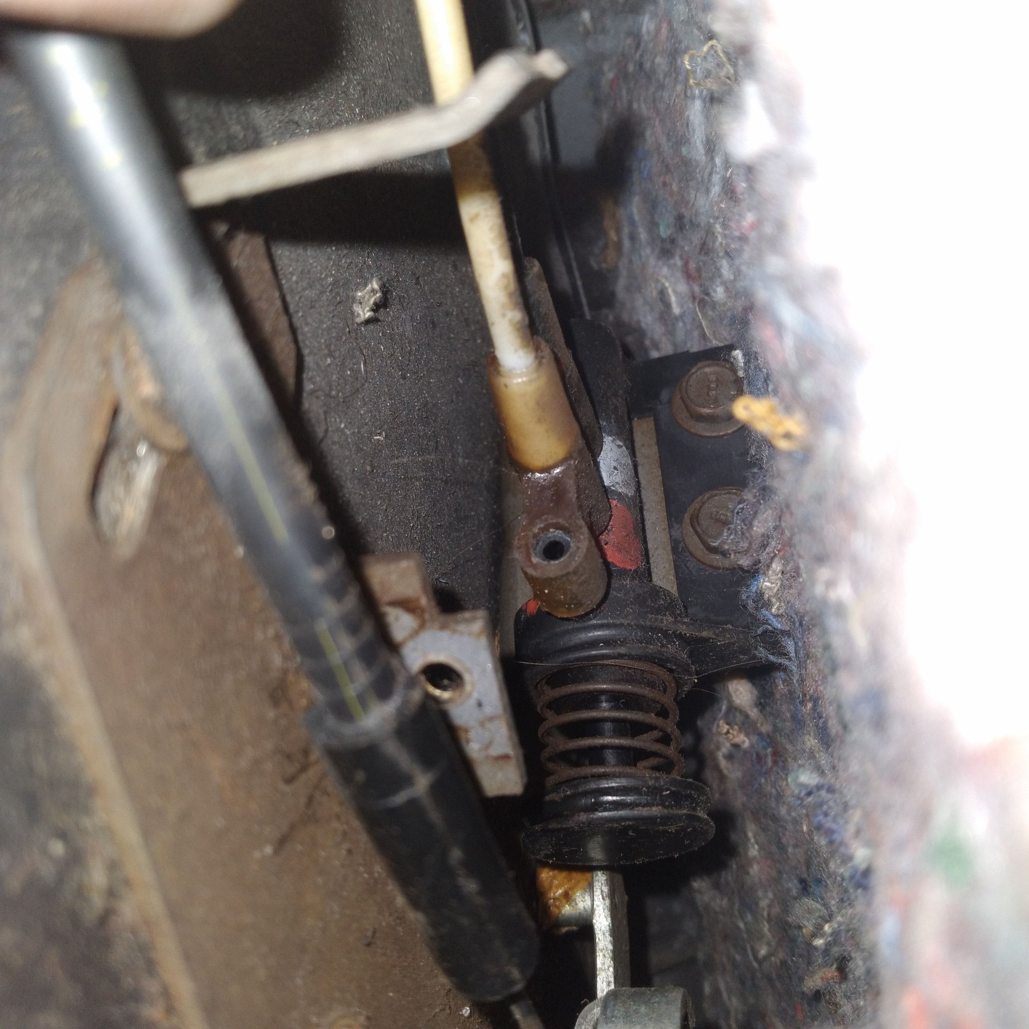

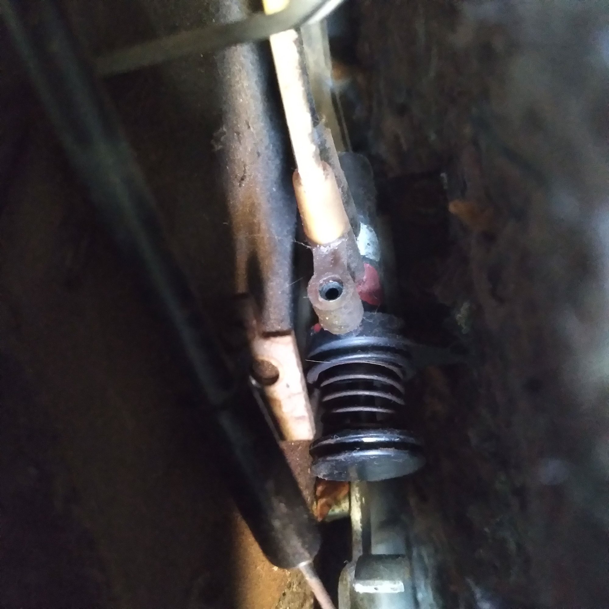

Am I supposed to adjust the two screws on the base or the single screw on the cable? Also upon removing the cable to adjust it I am looking at the plunger is there supposed to be three vacuum lines attached to it? Empty space in the front or is that just for air? And see
the picture

There is a black vacuum line going to where is marked white, and there is a white vacuum line going to where it is marked red right next to that is another spot right above the plunger that is empty with no line. If there is a line that is supposed to be attached to that where would it be coming from?
THINK I FOUND IT . Hard to see but the rubber grommet coming through the firewall has the three vacuum lines everybody's been telling me about the bottom vacuum line white is missing where would that vacuum line go to this is probably the problem hopefully.
