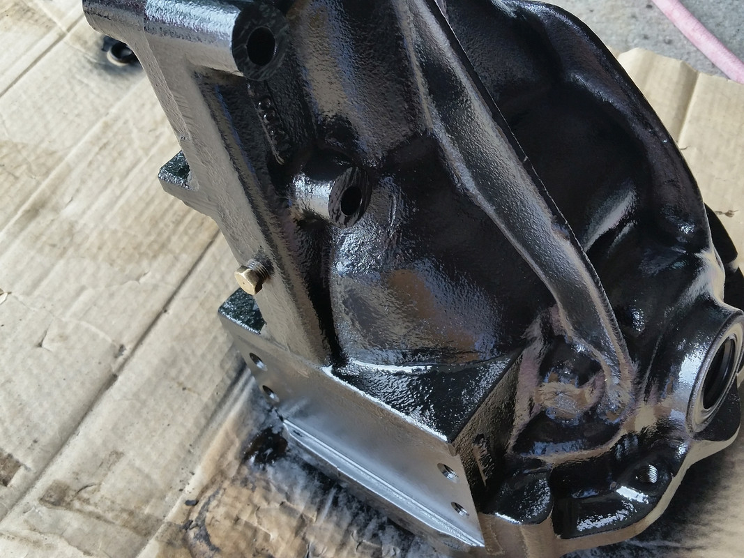

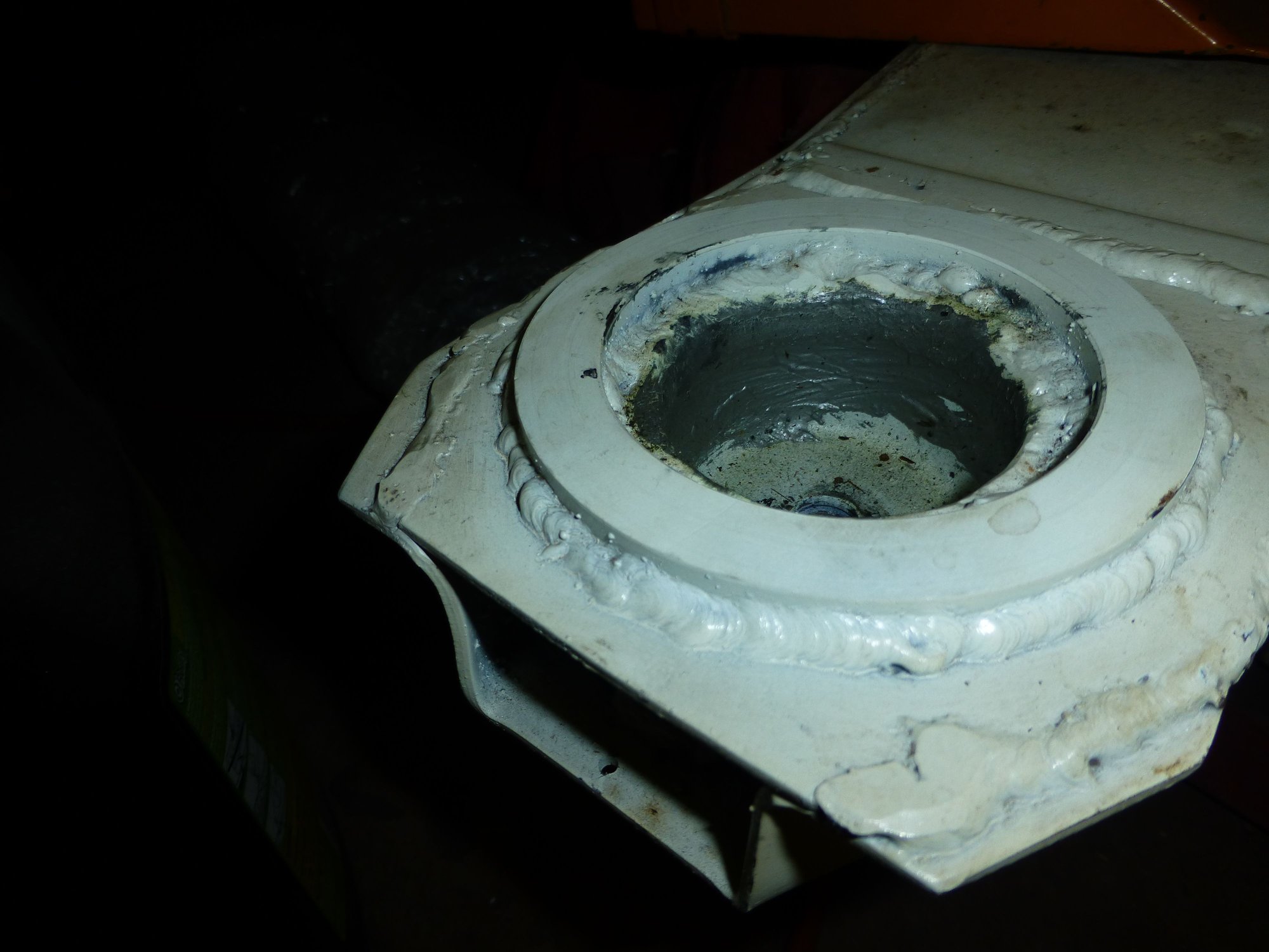

What have you tried in the way of gearing? I finally broke down and bought a second rear end with different gearing all done with the best internal parts on both. So I would have only a few hours of down time.
Anyway you want to get rid of the rubber mounting. I air chiseled and ground away the tabs to make the rearend solid mounted and differential raised using the crossmember end bolt and aluminum disk kits.
My exhaust is a one piece because of my cross over "H" pipe. So, I unbolt at the headers and then just two hanger points on each side to remove the exhaust. I just lean it up against the wall to do any power train work. Oh, I made the tranny crossmember to be an exhaust pass under to make it all less complicated. You can just buy those type of cross members
