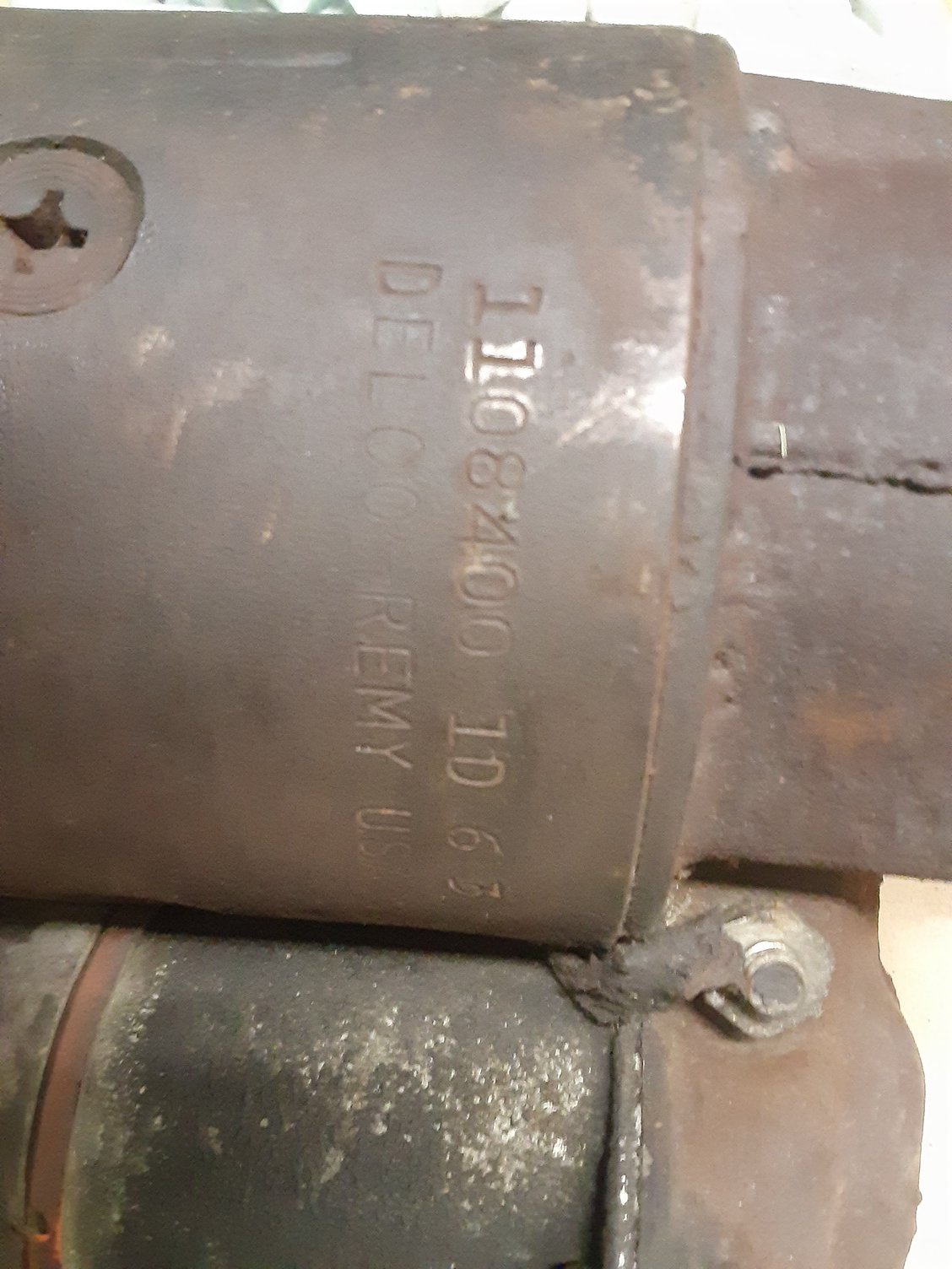

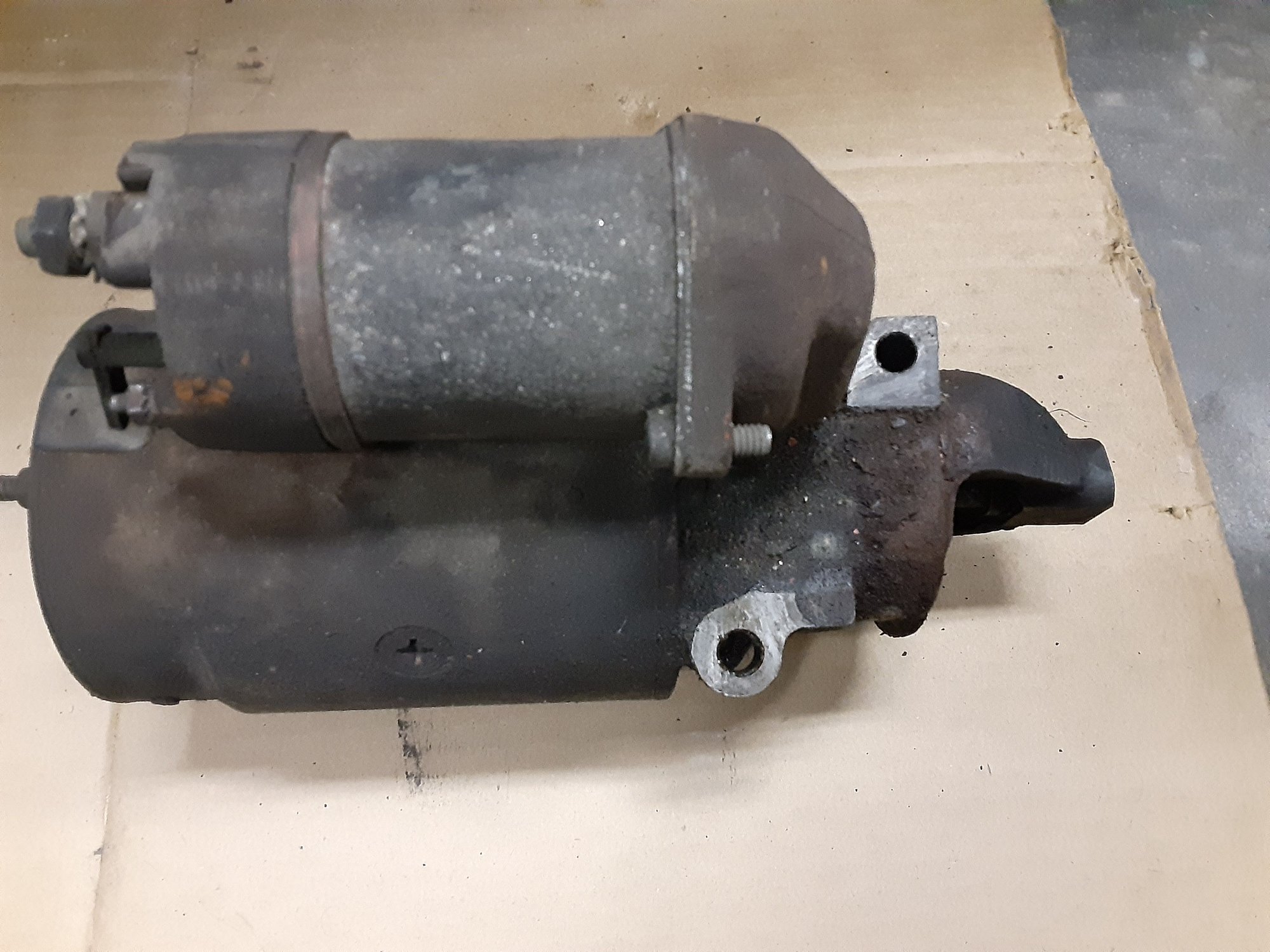

Here's the original starter I removed from my '71 454. I kept it when I installed a rebuilt starter from NAPA.

The bell for a 14 inch, 168 tooth flywheel fits the starter with a cast iron nose and bolts in a diagonal pattern like in the pic. The bell for the 12 7/8 153 tooth flywheel needs the aluminum nose, straight across bolt pattern starter. If you're using the starter stud to engine block bracket, you will need the bracket from a 65 396 or 67 L88 for you LS5. Otherwise the regular big block starter brace will work.
If you get the wrong starter, the noses are fully interchangeable.

I've got a 1970 454 LS5 with extra compression and it is very tough to restart when it's hot. Sounds like the same problem you had. Could you provide the Brand Name of the starter you bought along with the part number? Does this one have a nose cone like the original? I tried buying one from Amazon but it didn't fit at all. Thanks.
Mine looks like the picture above posted by Green 71 - with the diagonal mounting holes.
