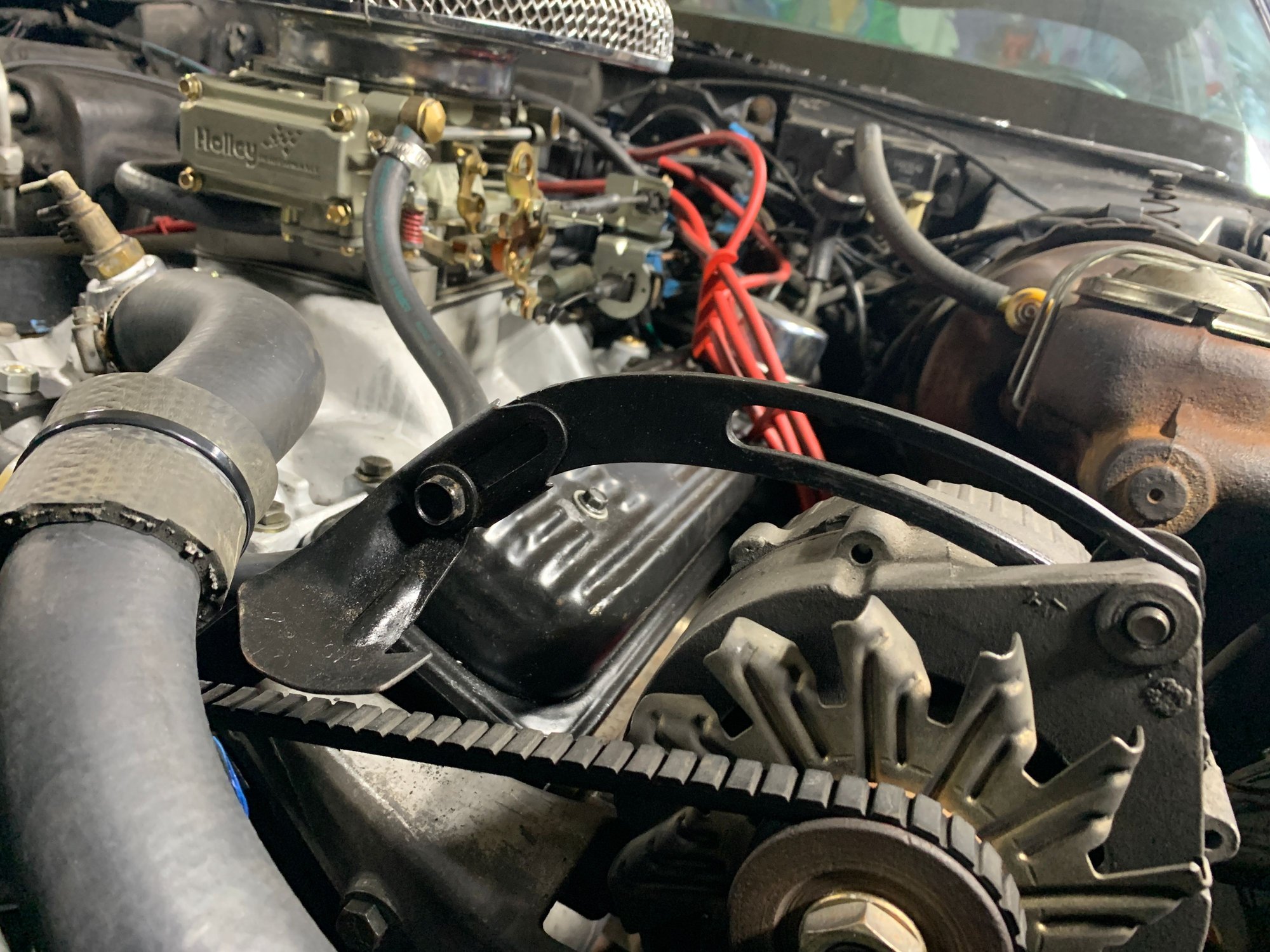

thanks sig. ill have to work on getting things back together a bit and take a photo of what it looks like. I have maybe a 1/2” in/out for adjustment.

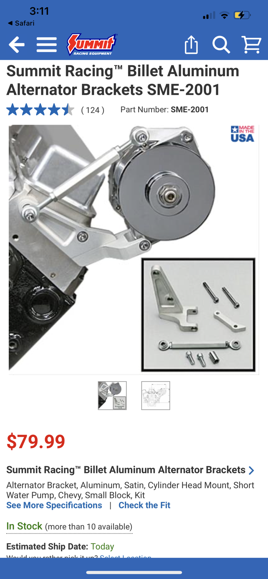

So looking though jegs, summit, google in general - this popped up.
in the comments someone specifically mentioned sbc, vortec heads and tall valve covers and it working.
what are your thoughts? Kinda seems too good to be true?
so far, its the best lead yet

That looks like a good option, but the only question would be is how much threaded movement does the bar have to adjust.
Old Dec 9, 2022 | 03:24 PM
Whelen1's Avatar
Whelen1
Joined: Nov 2013
Posts: 49
Likes: 7
I was thinking the same thing! nNow how easy would it be to source a new turnbuckle if the one supplied with the kit is too short?

My local Home Depot has them, but not that nice looking. Makes me wonder if maybe you can modify what you have now with one from Home Depot.

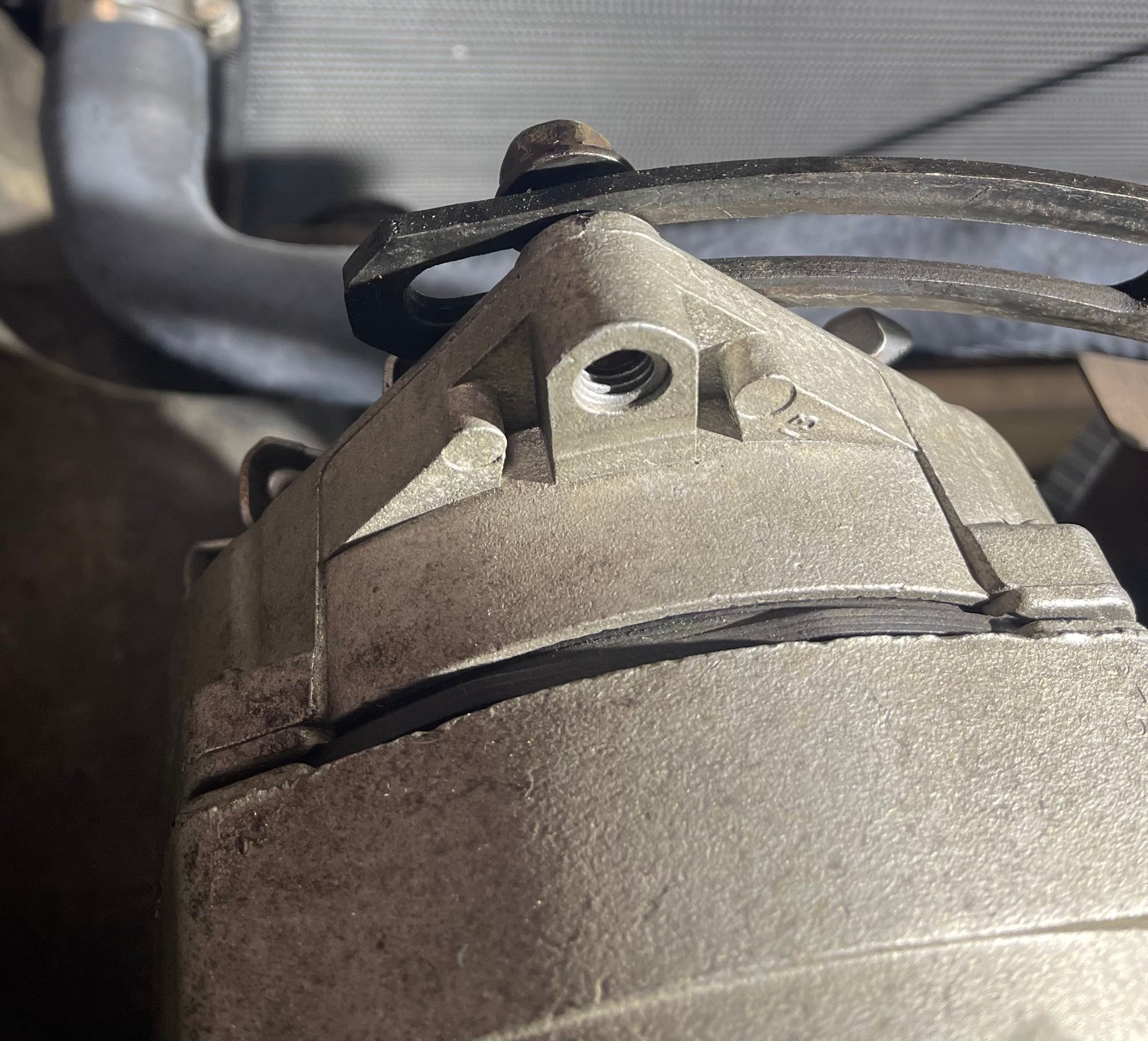

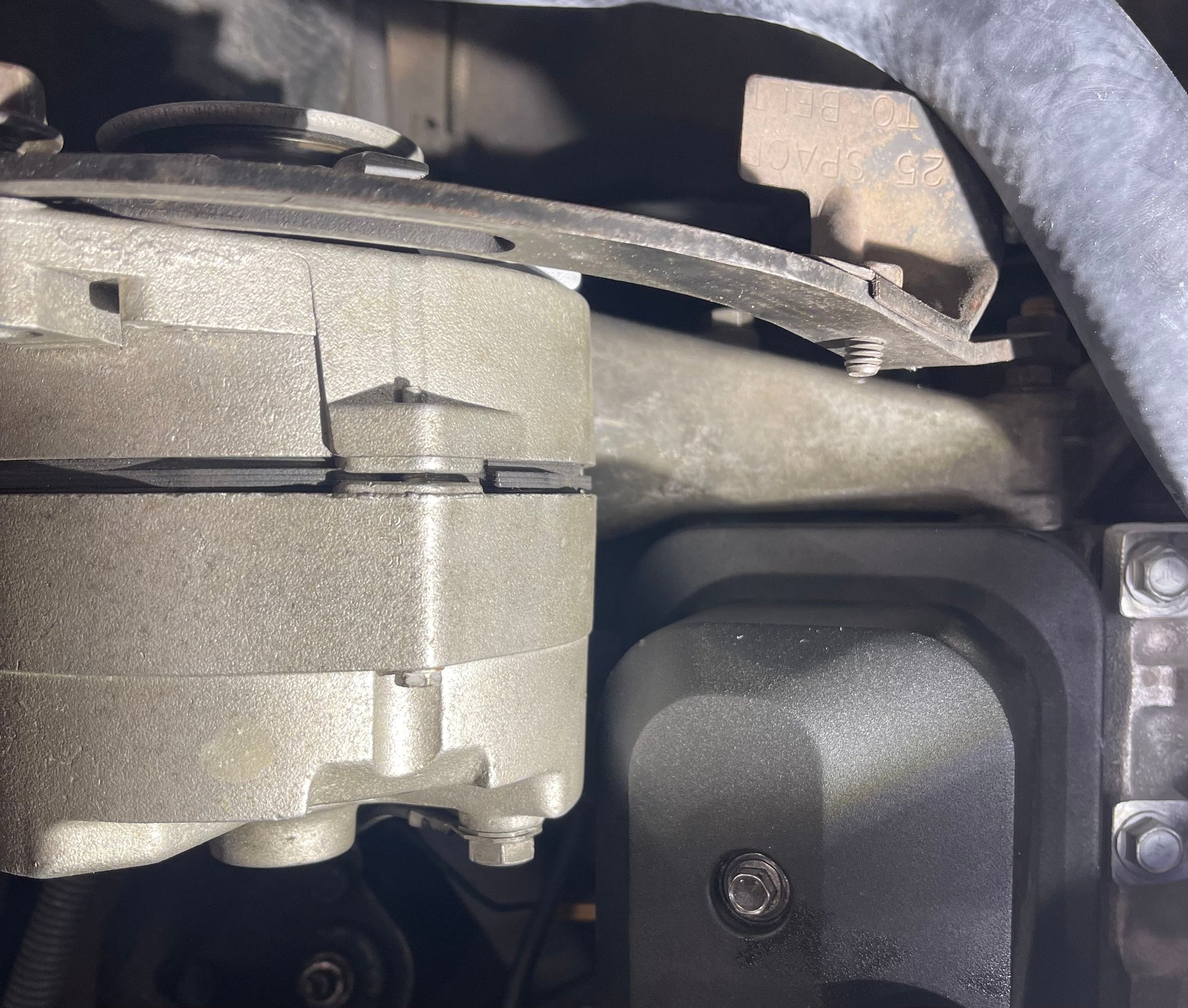

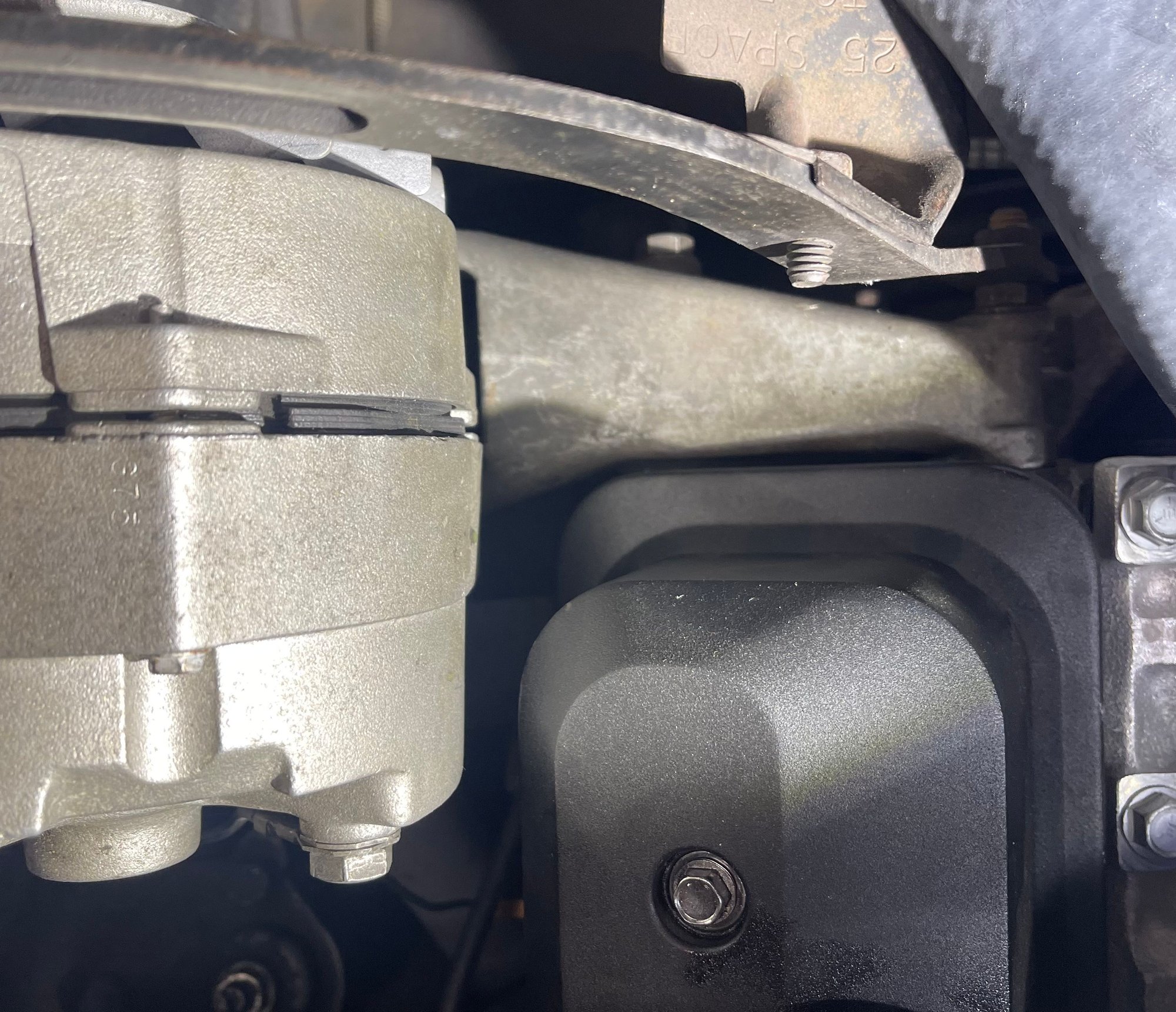

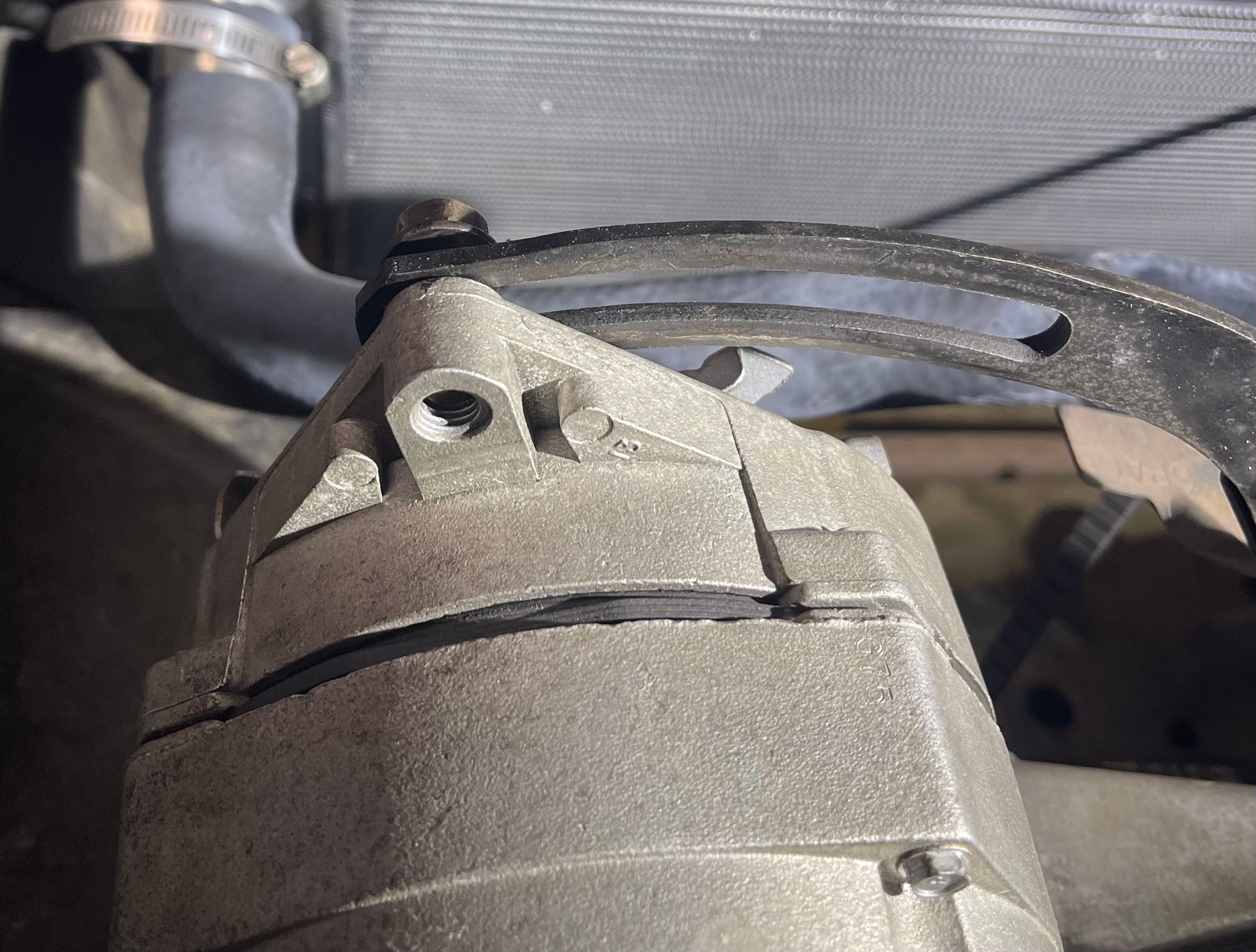

Edit: here are photos of how little room i have to play with
Just about to valve cover
Adjuster farthest in
Adjuster farthest out
Farthest out

Whelen1,
As wonderful looking as that billet unit is, I will tell you that when you start changing the design of the original GM ALT, bracket, etc it tends to alter the fan belt alignment.
Ever so slightly. Next thing you know, the belts are not tracking correctly.
Also note that some individuals mount the bracket behind the ALT housing "ear" instead of the front. The arch of the bracket can and will lay right over the arch of the ALT housing. Then the bolt is threaded in from the back, not the front. You may or may not have that option depending on where you have the other end of the bracket mounted at.

when looking at the belt track as it is now, its slightly to the motor side which is causing it to be too close for comfort to the PS pump. So thats something i need to address when i can get things back together. Speaking of belt tracking.
im not a fan of the billet l, i like black, BUT it seems as though its really my only choice to fix the tension issue which is causing an overheating issue.
if I could find out what the alt adapter bracket is actually called id keep everything except the oem tension unit and get an adjustment rod separately. But ive been looking for over an hour and cant seen to find the right search terms.
