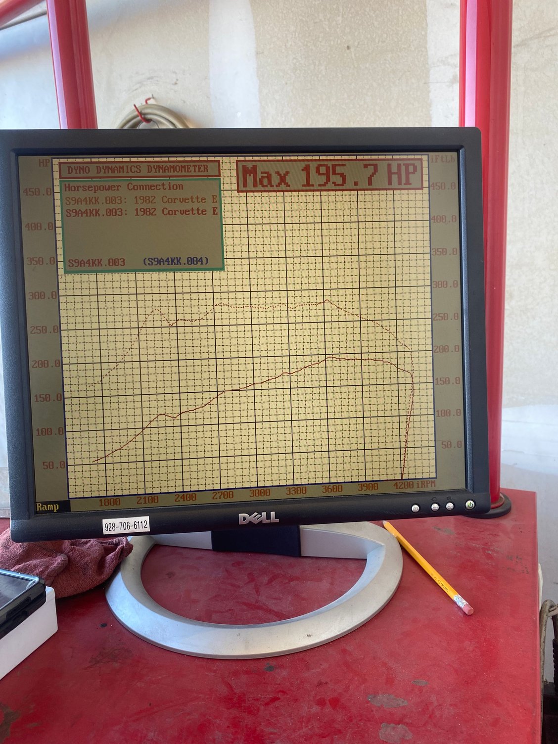

I am also looking to replace the heads on my stock 82 with crossfire injection. Runs good now. Just had a dyno run done at had 195.7 hp at the wheels! I am in the process of adding long tube headers and true dual exhaust. I am considering installing Brodix cylinder heads part # 1021002 with 70cc chambers and .040 Mr. Gasket hard gaskets. In addition I want to use 1/1.6 rockers. I am concerned about piston to valve clearance. Does anyone have any data on this subject? By the way am porting out the xfire manifold to port match the heads. Hoping to see 300+ hp at the wheels
very cool.. thanks for sharing dyno.. be great to see after too !

Look where you hp and torque peaked. 3700. you're gonna need a lot more cam, better heads, intake, and good exhaust to get anywhere close to 300 at the wheels. I'm not sure the current xfire system is even capable of 300 at the wheels ever without some significant mods to fuel delivery.

If it's a stock motor there is a good chance your pistons are already .025 below deck height. If it's been rebuilt, there is no knowing without measuring which you should do anyway. I would probably go 64cc heads and a thinner head gasket to get the compression up to 9:1 or so. Aluminum heads will handle a little more compression that iron heads without pre-detination. I highly doubt you will have any issues with 1.6 rockers, but always double check clearance with some clay.
