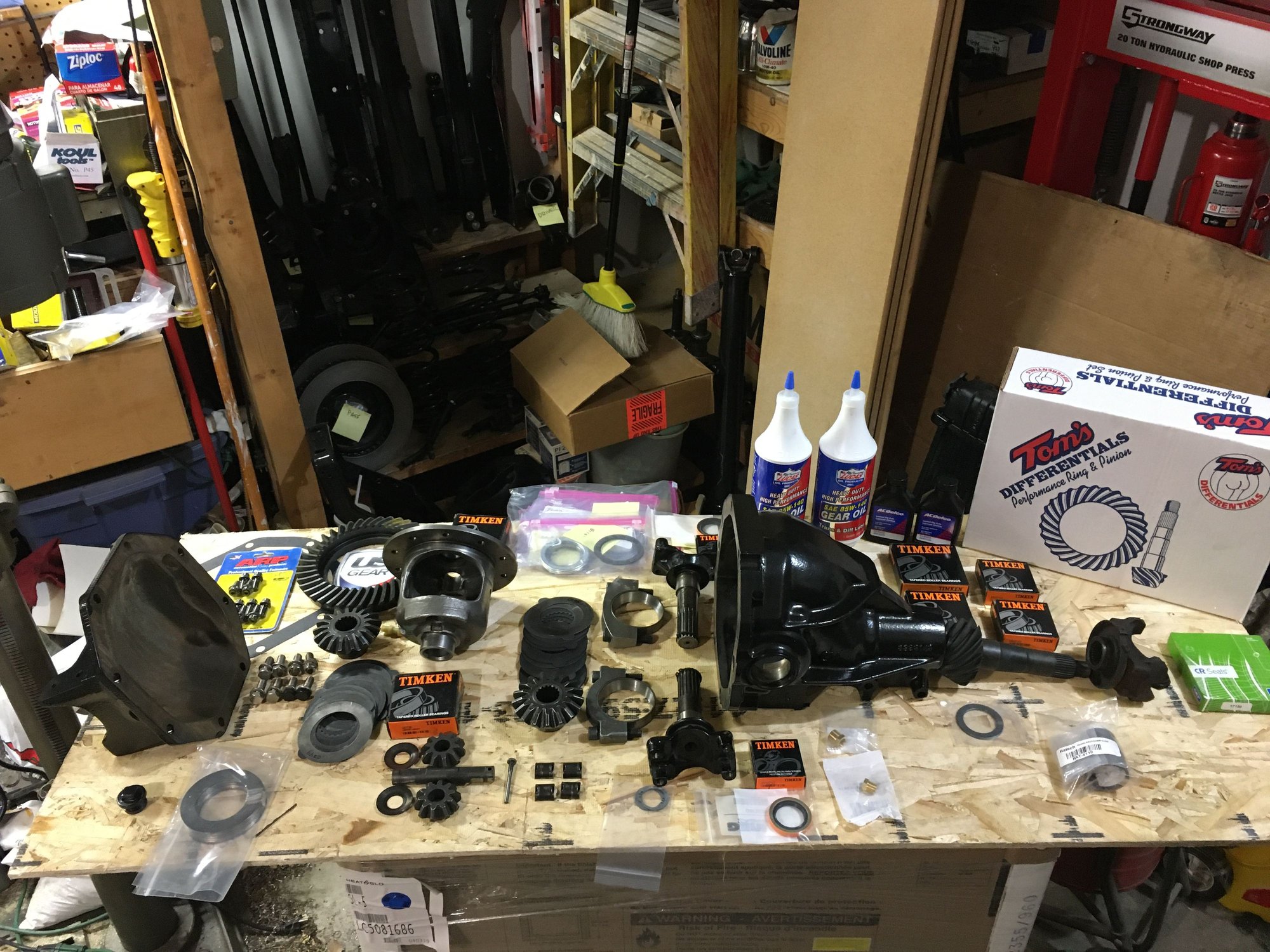

Search this forum and also Digitalcorvettes for posts by Gary Ramadei (GTR1999). Gary is the most knowledgeable person on the 63-79 differentials. I did a lot of research on the topic and a lot of the knowledge was obtained by reading Gary’s articles.
450 HP/450 lb-ft is about the limit for a unit that can be built using mostly stock components but you’d be advised to seek out a 3rd generation Eaton posi unit as it is beefier than what you have (2nd gen). You want to have solid steel clutch plates, the 17 tooth spiders (yours has 18 tooth if original) and “tune” the posi (look at the Tom’s Differentials YouTube video). Your axles may or may not be excessively worn so that is another area to examine closely.
That said, you can upgrade the unit with stronger axles (30 spline vs the stock 17), a steel bearing cap (on the left side), cryo treating the parts, REM polishing, and so on. The ultimate is converting to a 12 bolt R&P but now you are into 2nd mortgage territory.
Gary is great to deal with and has a long history of providing information and guidance. He’ll likely jump in on this thread as he is a Tech Contributor.
This was mine the day I began the assembly process a couple years ago.
