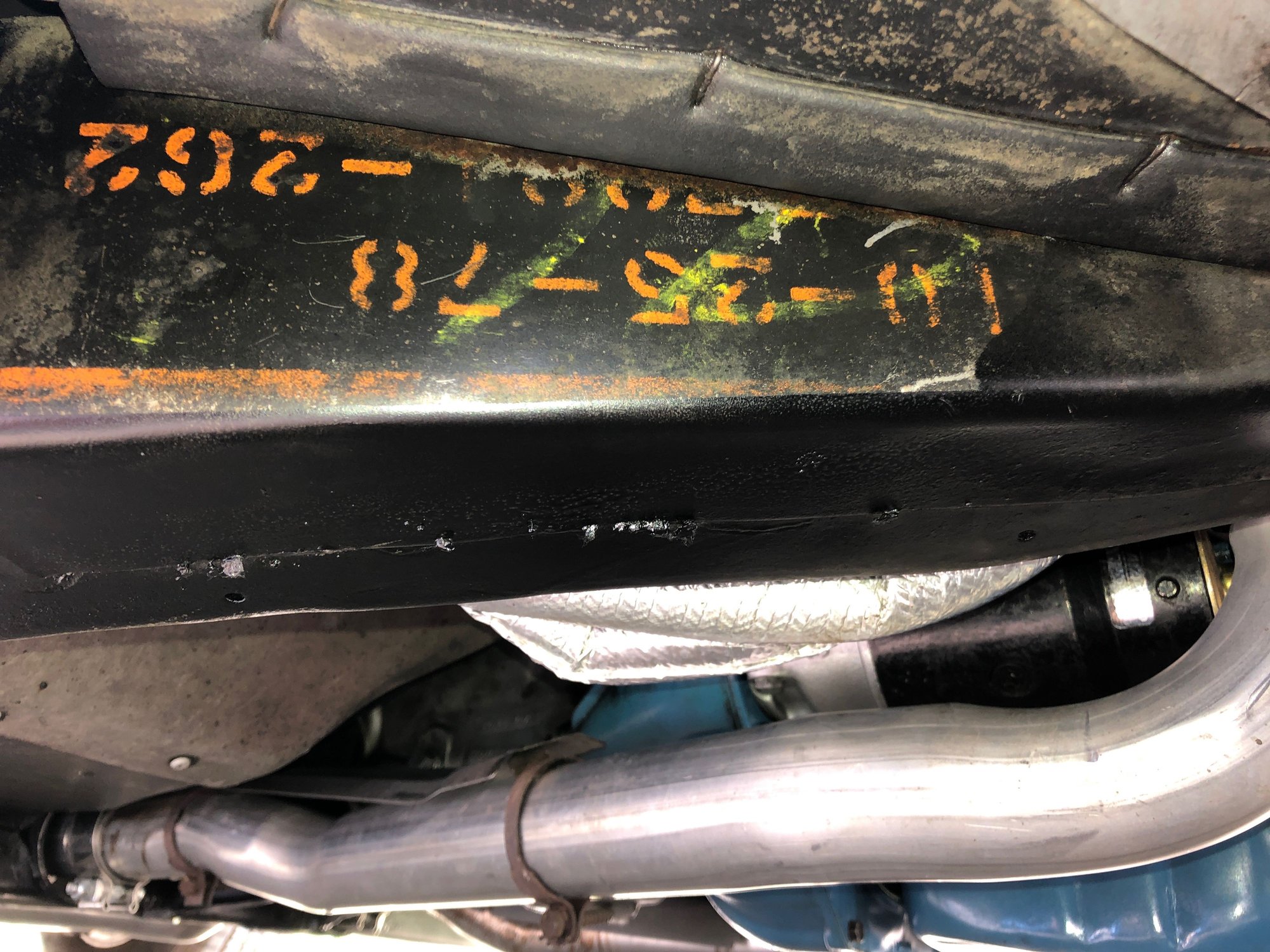

my early (11/78 build) 79 , 78 frame is orange, ?
spring tags green
With my frame stencil inventory, I track the trim tag date code (Cxx) along with VIN and transmission type...what's yours?Frame Date 10.25.78
14038288-262
RPO L82 M21
Trim tag date code Cxx

The judging manual states the stencil colors ranged from white in early 78 to yellow to orange-yellow by the end of 79 production. No dates mentioned about the change over.
14038288-262
RPO L82 M21
4sp
