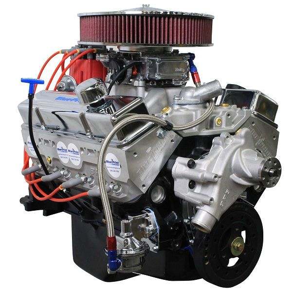

Get this CRATE with some headers and straight pipes and be done with all the confusion.
https://blueprintengines.com/product...m-carbureted-1
