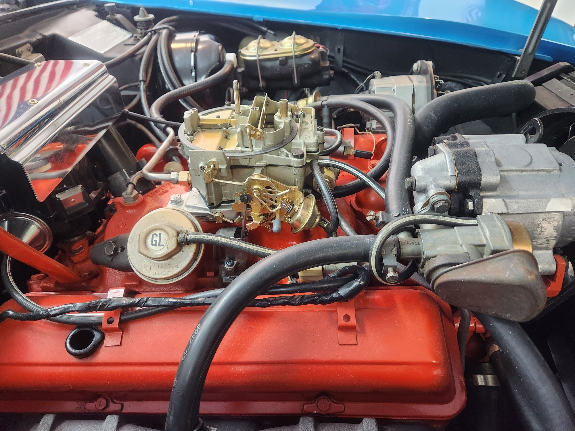

On my 73, slight leak at rear bottom corners. Driver side is easy but any suggestions on passenger side. I don't want to disconnect original tower clamps and hoses, NCRS car. Thinking best way to move smog pump / hoses to get valve cover off. See pic.
Tks. DRC
Will check covers base and bolt holes to be dead flat. Will glue cork / rubber gaskets to valve covers.

I have a 72 LT-1 and faced the same dilemma. I was able to remove the tower clamps and hoses without damaging anything. You might also be able to unbolt the diverter valve from the smog pump and raise the valve and hoses upward. I haven’t tried doing it that way though and there is a paper gasket involved that could be damaged in the process
