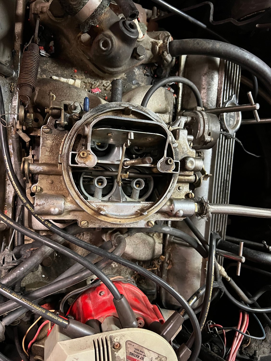

I'm not familiar with that carb but there should be a TUBE sticking up that you can poor an ounce of gas into.
See if it will run doing that.
You say you have a spark so see if the rotor is pointing at the #1 spark plug wire when the #1 cylinder is at TDC on the compression stroke.
How about a photo of the carb with the air cleaner off.

ok, i removed top of the carb. All clean, full of gas. When I press throttle I can see sprayers spraying fuel. I am definitely back to ignition timing idea. Here are some pics.

OK. I don't see a tube to pour gas into the carb and since when you move the throttle lever you see gas being sprayed into the primaries then you have gas in the carb.
Firing order 1 8 4 3 6 5 7 2. Double check that.
Remove the #1 spark plug and verify you are on the compression stroke. (Front plug on the left side).
At TDC does the pointer and the mark on the balancer line up?
Was the distributor ever removed?
Or was it turned?

Just that you see fuel when pumping the throttle is only telling you that the accerator pump is working. This car sat a long time. Most likely with fuel in the carb. The inside of that carb is likely all gummed up and fuel metering jets are plugged.
If carburetors are not your area of expertise. Then remove it. Taking lots of pictures as you go so you know what line goes where later.
take it to a known good rebuilder in your area or buy a new one.

Are you trying to start it with that bottom hose unplugged?

From your picture it looks like the ignition wires are wrong . See picture

Also that looks like an Edelbrock 1406 600 cfm carb . The number is on the passenger side , in front of the mounting stud.
