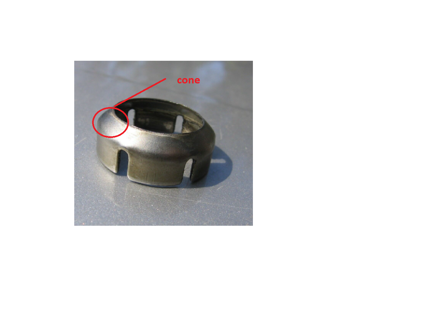

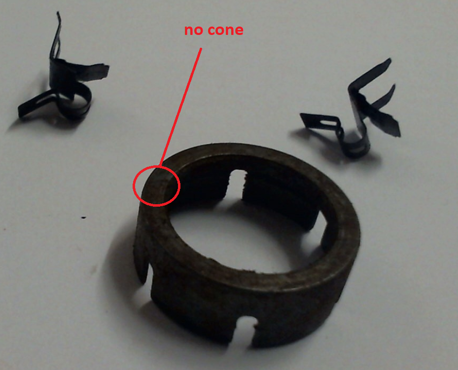

Hello!Question: Is this the upper bearing inner race seat for a 78 T&T steering?
I found other photos with an cone!?

I miss this part in my T&T and need an answer.

I have had tilt columns from every year disassembled and I have never seen that part in any one of them. There is a small ring that goes between the upper race and spring, but have never seen one that looks like that.
