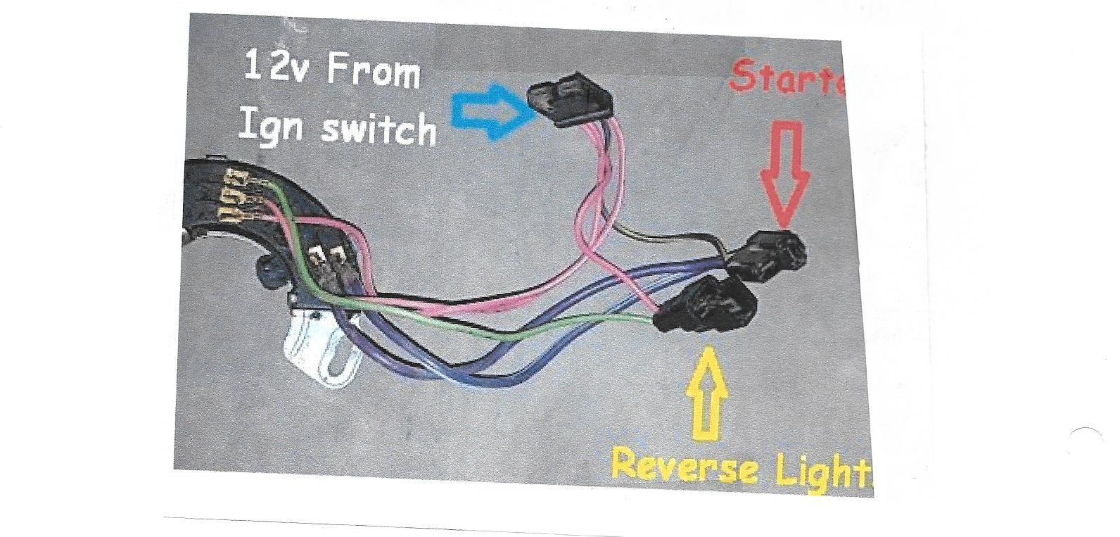

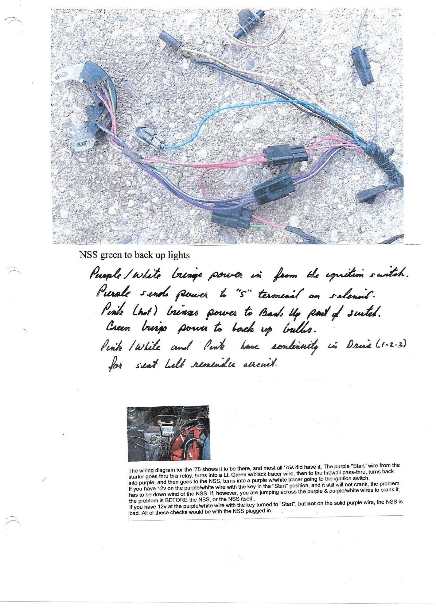

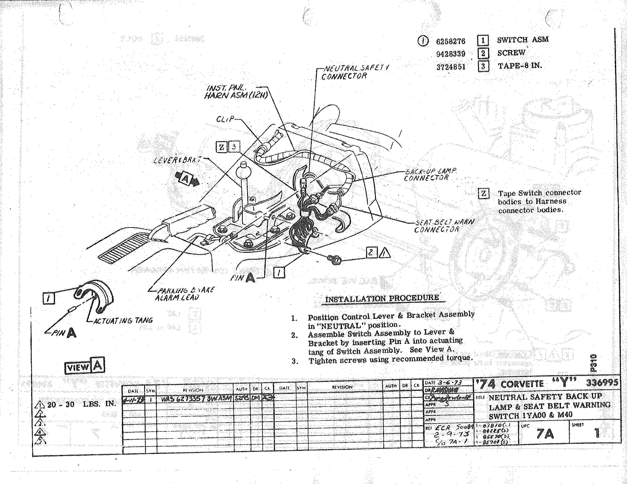

I was able to start the car without any problem today. I think it could be that the NSS has moved. I got the adjustment information off the Willcox site and will try that as soon as I have time.

After you clean the negative battery ground look at the adjustment of the NSS.
