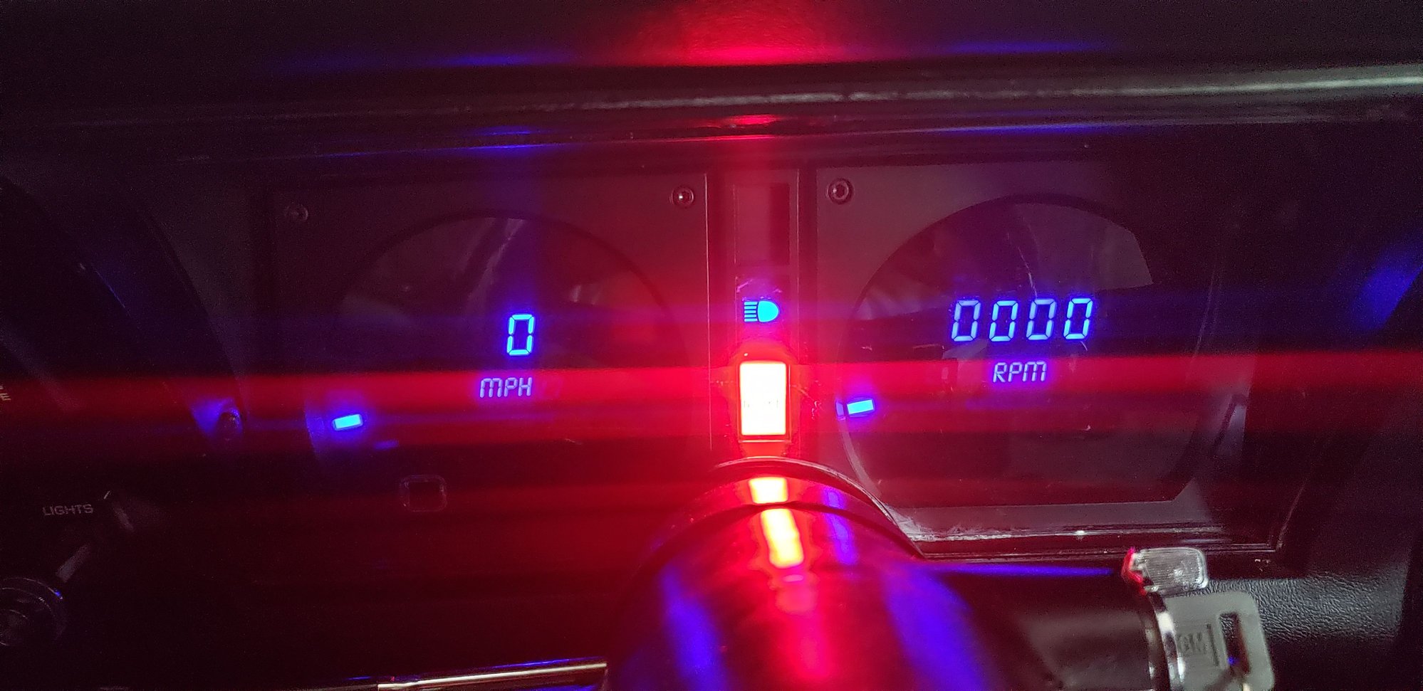

I have a 1977 Corvette that I am currently installing Intellitronix gauges in it. I will list the problems I am having and hopefully, someone will have come across it on their car:
1. The smoked lens does not fit into the gauge housing (blue metal) due to space. This concerns me because I do not want the gauges sitting directly on the lens plastic.
2. The smoked lens does not fit into the original interior bezel without interfering with the three tabs made for the stock lens (clear), this causes the new panel not to seat properly and I can't tighten everything up.
3. The speedometer screws and spacer kits they send you are too tight.
Can someone help me out with some pictures? The instructions are not clear as to which piece comes first, or where to put certain lens or panels. If I could just figure this out I can move on. It was quite enough just to get the dash apart. Really want to finish up this little project.
Hopefully others have had fitment issues with intellitronix...
Thanks.

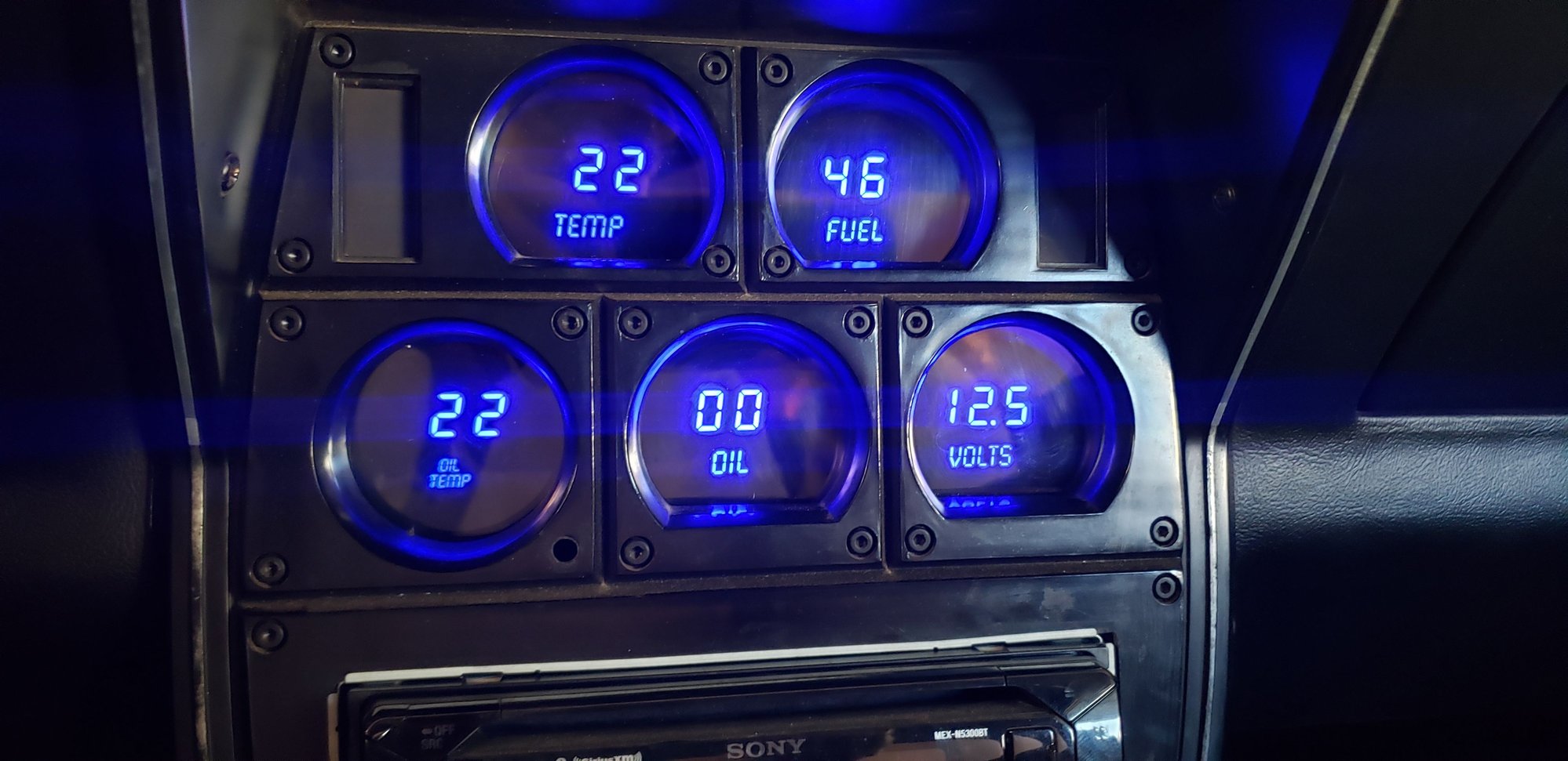

I am also currently installing my intellitronixs gauges on my 80. You have to use a solder gun or Dremel tool to make that slot a little bigger. I used a solder gun and melted those areas. Either way you have to be very careful, keep in mind car is very old and things are somewhat brittle.

I didn't use the spacers because they made everything too tight. Only used plastic washers in between cluster and guages. Trust me I tried everything and finally after taking and putting it together about 5 times I settled on only using plastic washers.

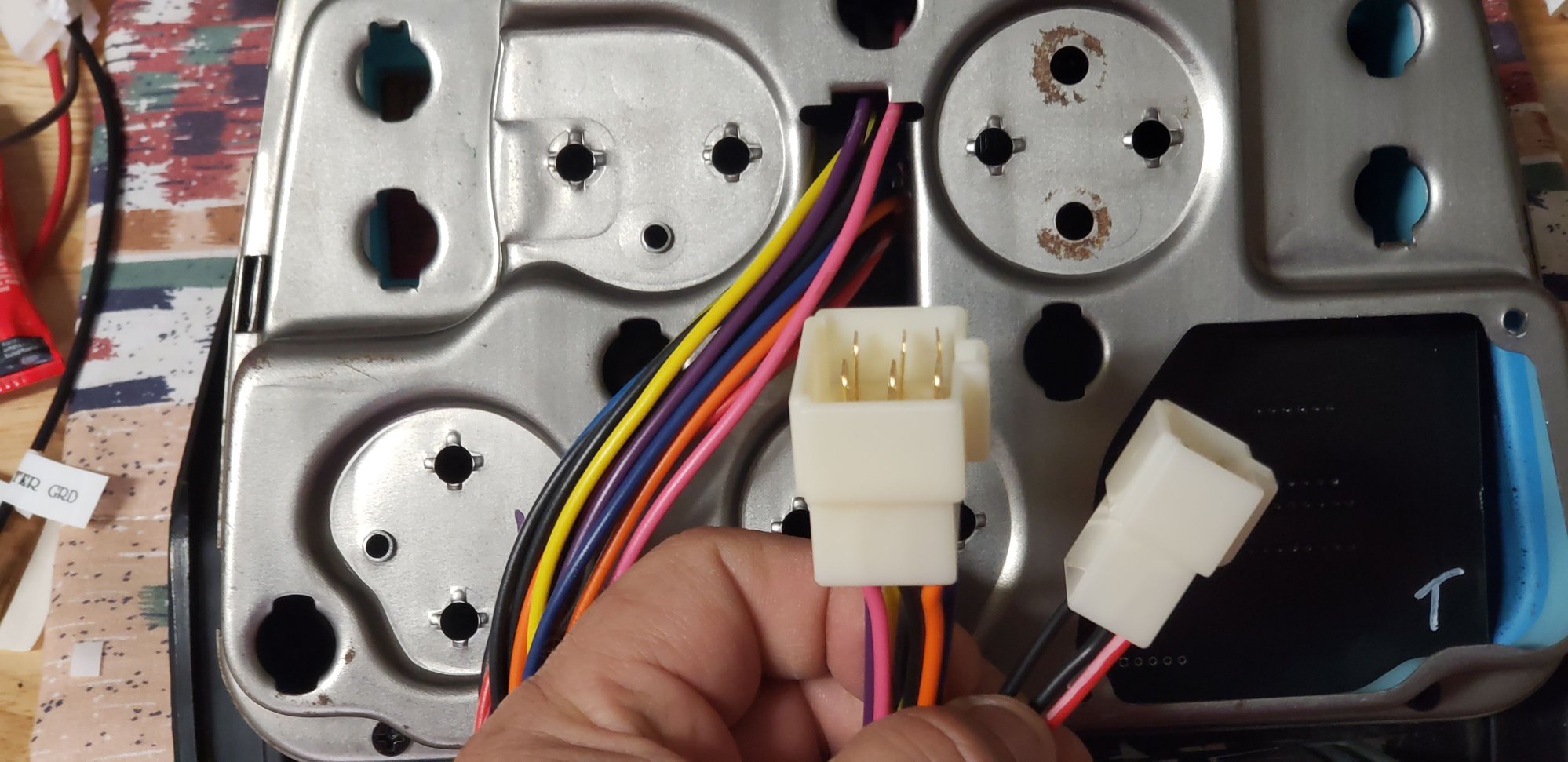

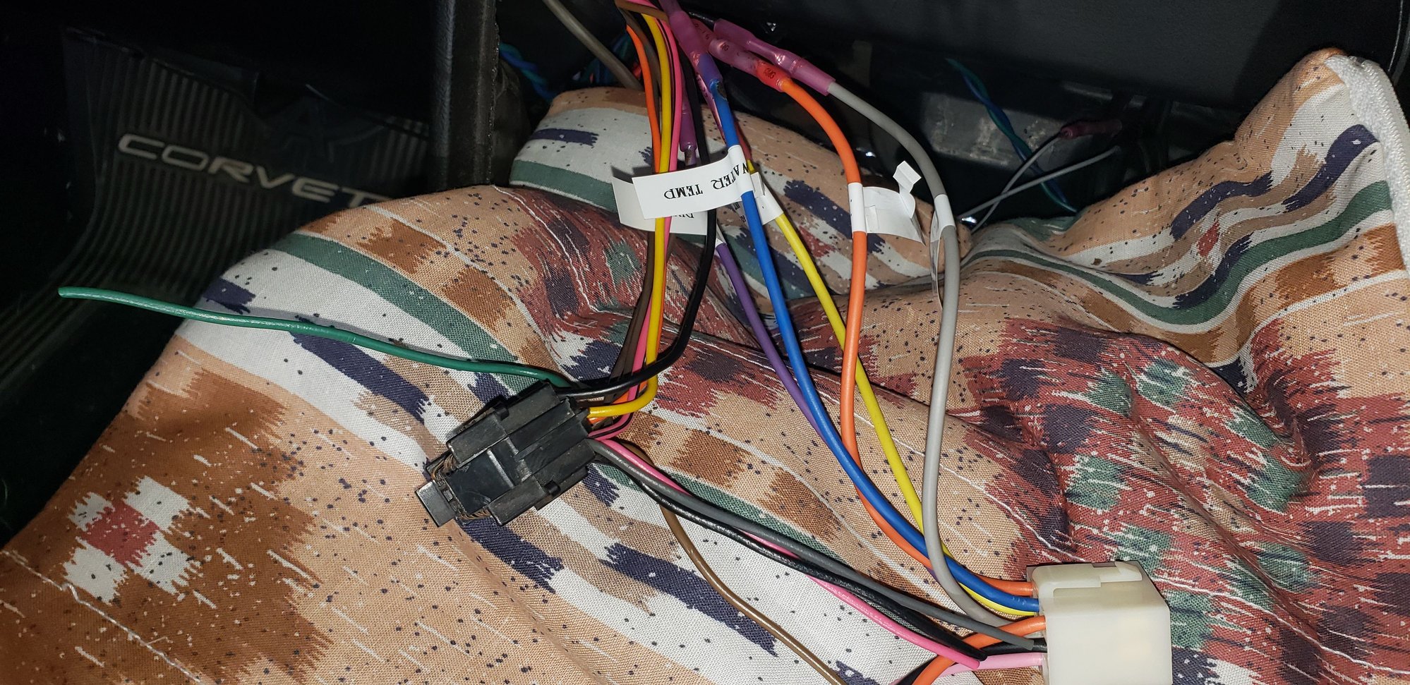

There is a guy on the forum r6n350, who does away with circuit board and runs wires directly after cutting plug harness in the back. I followed his setup and it looks to be like an OEM fit.
This makes it easy to remove in case you have to remove it later.

How did your setup end up? Any problems with temp guages? Mine came out pretty cool, color looks super bright blue. The only issue I had was the Water Temp Sensor, they sent me wrong one I believe because it cuts off midway while car is gradually warming up. I spoke to Intellitronixs and they are sending me different sending units.
Waiting on 2 new temp guages for water and oil.

Old Jan 16, 2023 | 10:27 PM
dmallen95's Avatar
dmallen95
Joined: Oct 2018
Posts: 77
From: North Carolina
So, I followed a guys thread on here for installing it. He retained both the clear and smoke lens. The smoke lens went into the metal casing. He added O-rings as spacers to prevent to much pressure on the cluster and lens. It worked. So that is together now, I’m hoping it doesn’t get hot on the face or alter the smoked lens over time. It went back together and didn’t feel tight so I’m going to leave it that way and move onto the speedo cluster.
thanks for the insight.
