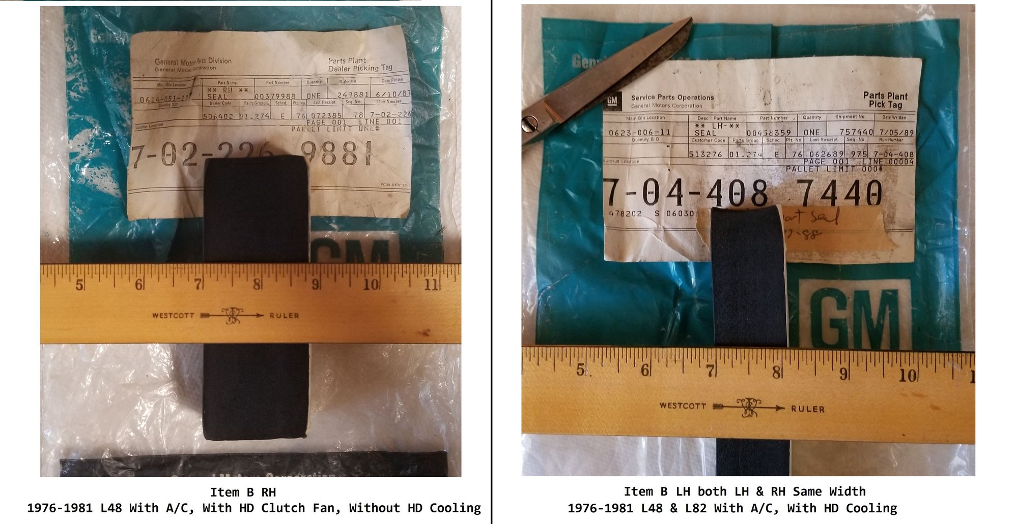

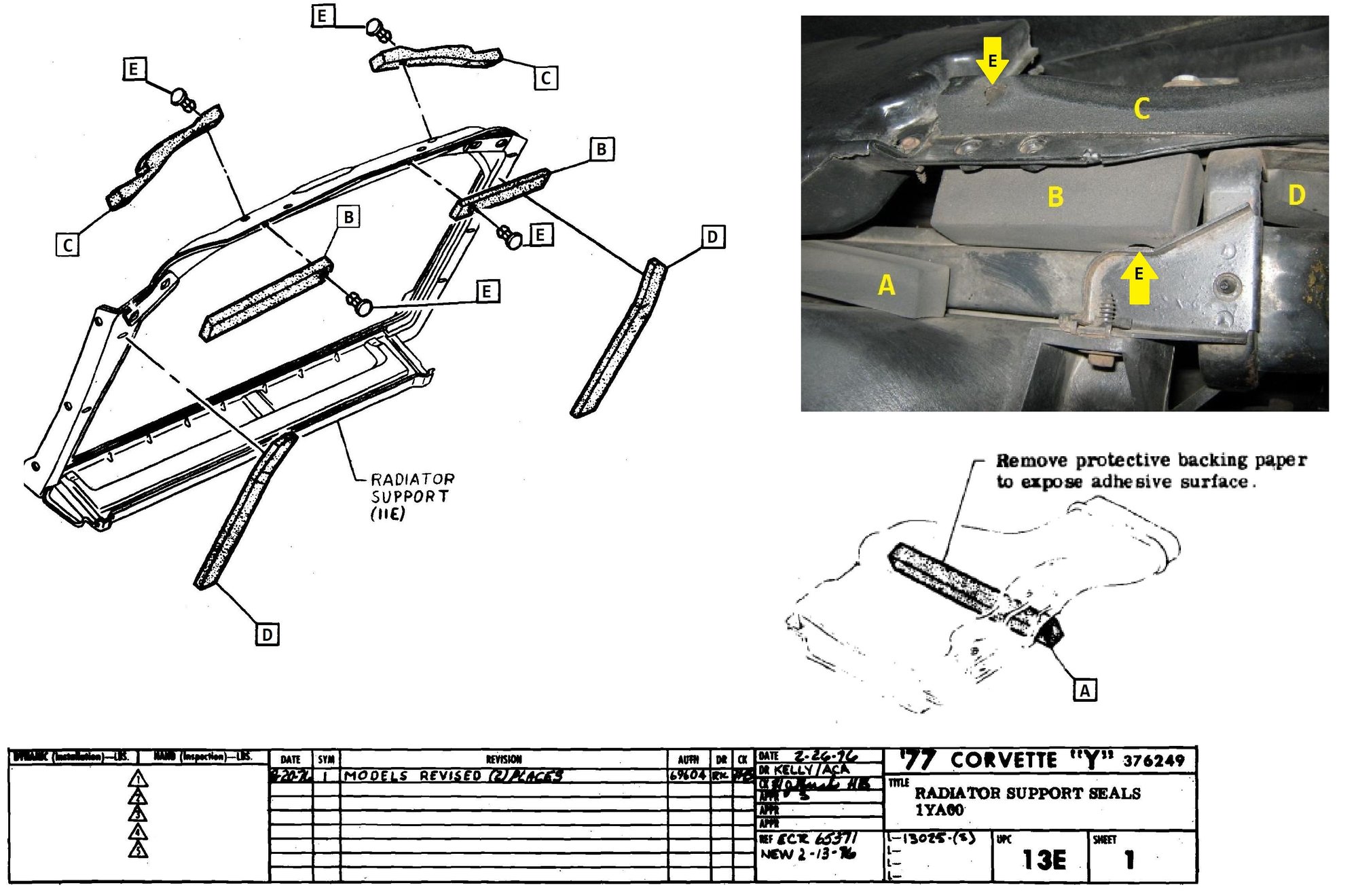

I agree completely, and for at least the 1977 it can be confusing as what seal kit to order.
I know the answer but what seals to order for the following,,, with A/C, without A/C but with HD cooling, or L48 with A/C but not HD cooling, the width of item B is different for each LH & RH
This photo below is the layout of a 1977 L48 with A/C, and with HD clutch fan but without HD cooling...
The differences in width of item B...

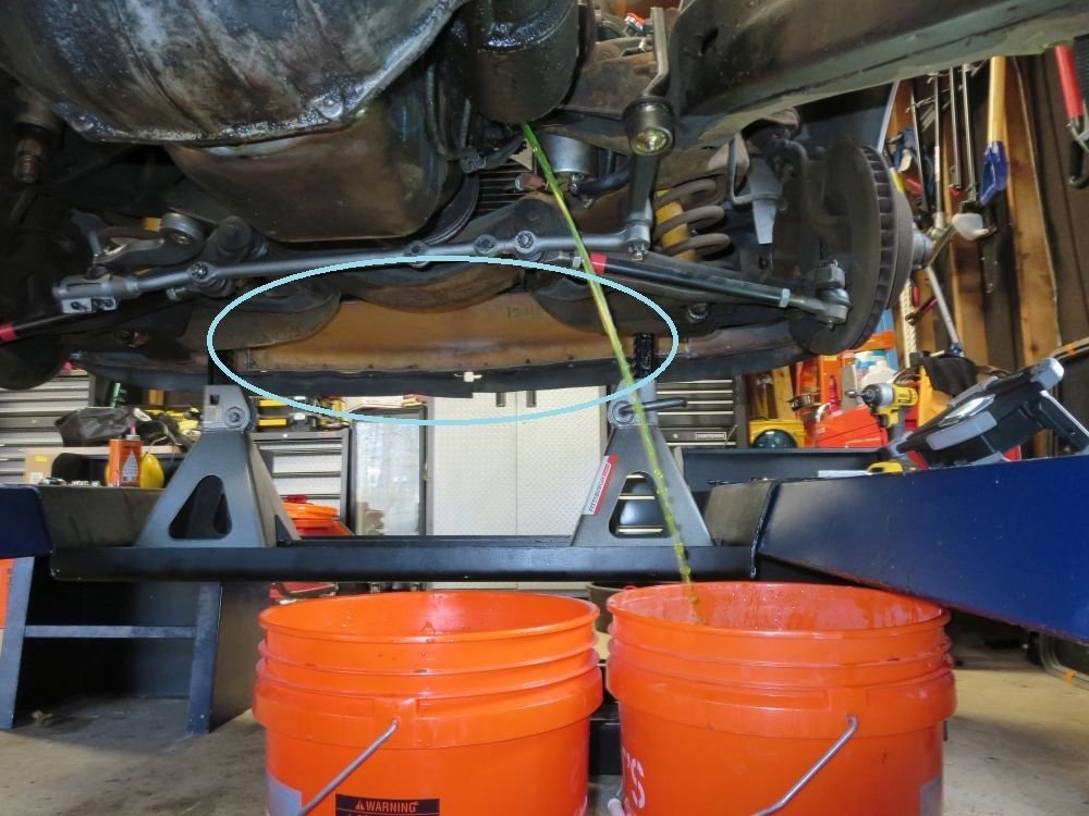

Bonus picture! OP, is this part intact and in place? If not, a lot of air will bypass your radiator. My otherwise mostly stock car came with a replacement piece in this location.
