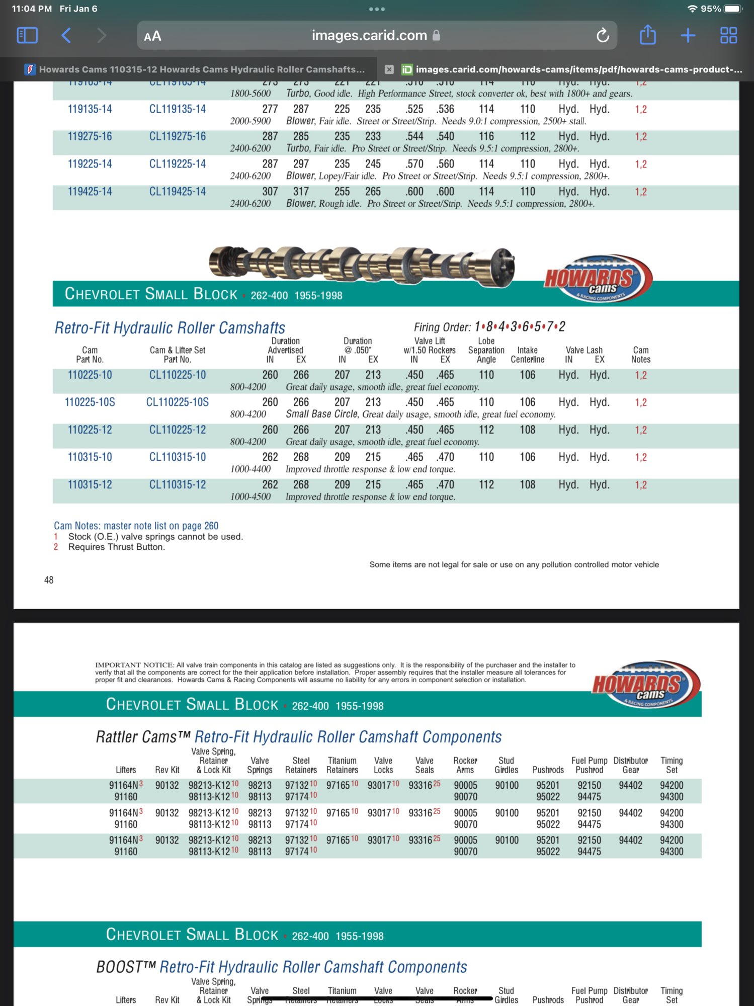

Well I appreciate all the input, seems like I should go with the smaller of the two to be better suited for the street and my setup. I'm close to pulling the trigger, unless there are better recommendations?

This one is in the same ballpark but might be a bit better mannered for the street
https://www.howardscams.com/hydrauli...cams-110245-14
Or this one for a step up
https://www.howardscams.com/hydrauli...cams-110255-12

I pulled the trigger on the Rattler (118005-09) : 227/235 525/530 @ 109LSA , got a good deal off eBay for a new one. And ordered some of the Engine Tech Retro Roller lifters that Auggie Doggie is always preaching about. so $600 all in for roller cam and lifters!

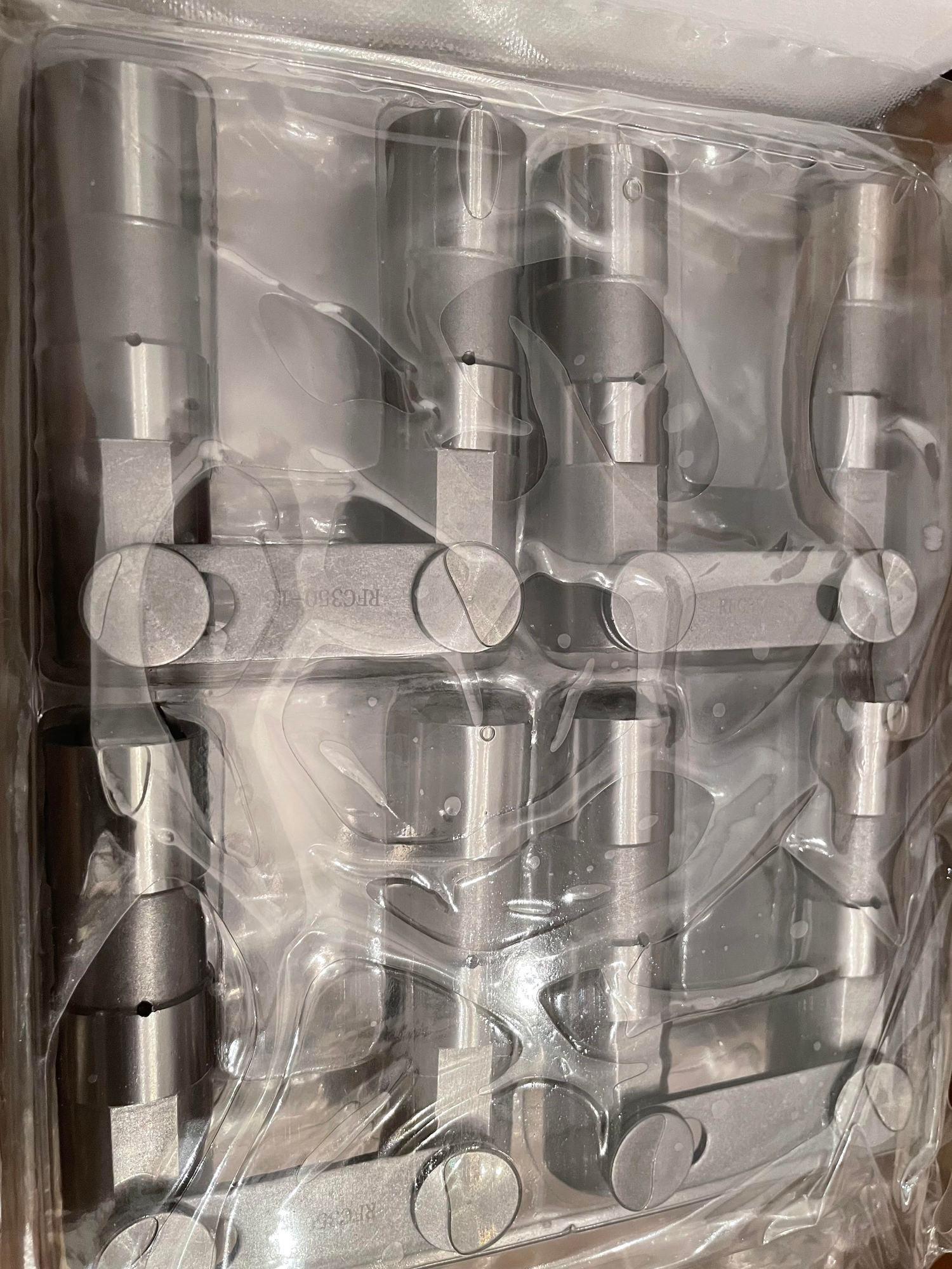

Cam and lifters delivered this week. Both look to be high quality and well made! Cam specs are posted below
