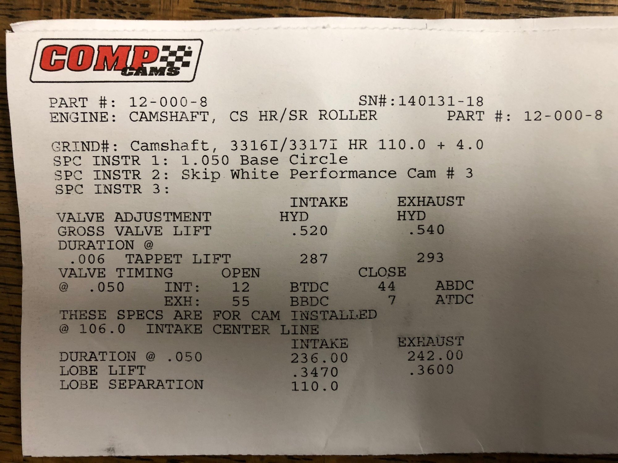

Skip White Magic Cam 327s-383s Truly Magic

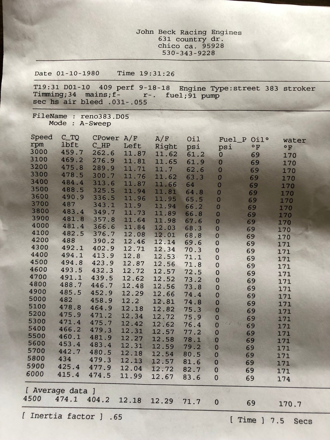

Old Jan 13, 2023 | 02:21 PM
reno stallion's Avatar
reno stallion
Joined: Apr 2013
Posts: 3,483
Likes: 1,823
From: McCloud CA
C2 of Year Finalist (appearance mods) 2019
Originally Posted by Arg0413
How's it drive? How's it perform? What's the characteristics?
Idles at 500 very nice sound. Drive's great pulls hard down low. make's very good power to 6200 in 327 and 5600 in my 383.
dyno 383 with cheap Chinese heads. And I know the date is wrong
Old Jan 13, 2023 | 02:37 PM
Arg0413's Avatar
Arg0413
Joined: Feb 2015
Posts: 1,440
Likes: 1,031
From: Baton Rouge Louisiana
Originally Posted by Jebbysan
The idle was pretty lumpy but not a "fairgrounds cam"........
The cam may be well rated but I would just go to a larger cam to get what you want as you potentially can improve airflow and the sound is just a byproduct.....
In your case....the larger cam makes sense as you have a 3.70 gear....you may also have a close ratio trans with a 2.20 low.....so really a compromise......the 3.36 with a 2.56 low is a better street combo........more usable rpm range....do you know what you have? To get MPH from the 3.70 you really have to turn the engine.......I think if this were mine....I would put a smallish Solid Roller in it......something in the upper 230's for .050 duration.......if you want to spin it up......depends on how you drive it I guess......
Jebby
Jebby, What other streetable larger grinds would you recommend? My LT-1 has an aftermarket Borg Warner Super T-10 in it (I don't know the story why) , and I don't know the ratios.. I have confirmed the 3.70 (cruise at 3200RPM at 70MPH)
I small solid roller would be cool in my opinion, because it pays homage to the solid FT that came in the LT-1. How are the manners of a 230ish solid roller? I like to rev my engine (I have a C4 ZR-1 too, and used to revving high lol) But I don't need to get my LT-1 to 7K, i'm good with 6K on a street car.
Arg0413's Avatar
Arg0413
Joined: Feb 2015
Posts: 1,440
Likes: 1,031
Wow! That's some impressive numbers!

First cam in this car was Comp 292 Magnum hydraulic, 245/245 @ .050, 110 LSA. It was, In a word, crap.
Use those numbers as a guide, keeping in mind you need to drop the duration to account for smaller displacement.
