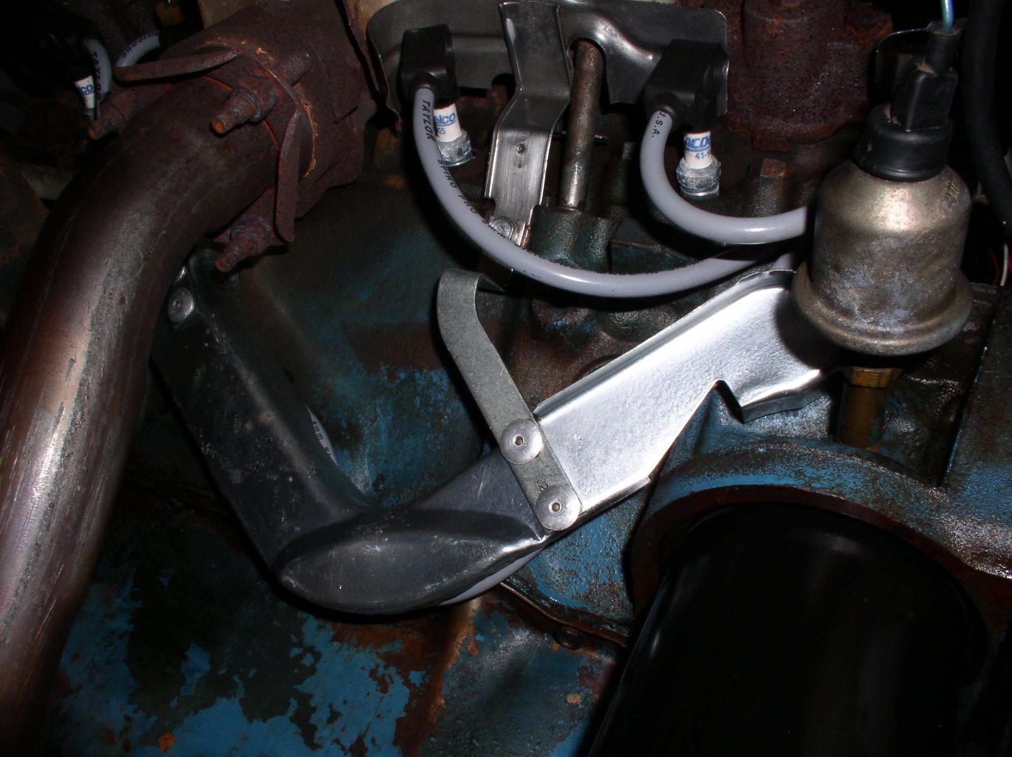

Without a picture of yours, hard to say, but guessing one of those bolt holes near the filter is for a clutch Z bar, maybe?
Most oil pressure holes, fittings, adaptors, lines, plugs, etc are NPT. That gets a little trickier when selecting diameters.

Thx for reply, the hole obove to the left probably clutch, upper right goes through to inside engine block and I will use it. Where your PSU is - mine has a snapped off 1/4 " wratchet exten broke off.
To Pressure Sending Unit
