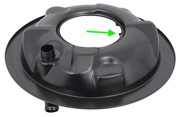

I would stay away from a drop air cleaner base as they take h.p. AWAY.

I don't think that's true if you stay with a 3" air filter. Plus, nobody uses a drop base for aesthetics. They do it out of necessity to address any hood clearance issues. Depending on the setup, you simply may not have a choice if you want to go with any performance intake with higher than stock profile, and the BB hood (non-l88) doesn't give a whole lot of extra clearance over the stock small block hood.
Maybe an inch, as the rise really happens toward the front of the (BB) hood - well past the carb area... I have both to compare side by side, and there ain't much of a rise where you need it.
The LT1 had a hi-rise intake, which necessitated the use of the BB hood in the first place. Easy enough to measure when the OP installs the set up that he wants and gently closes the hood - Some Playdough and a tape measure or ruler should fit the bill.

This is the OE GM drop air breather with the most drop and retains proper flow. Fits Holley and Quadrajet
