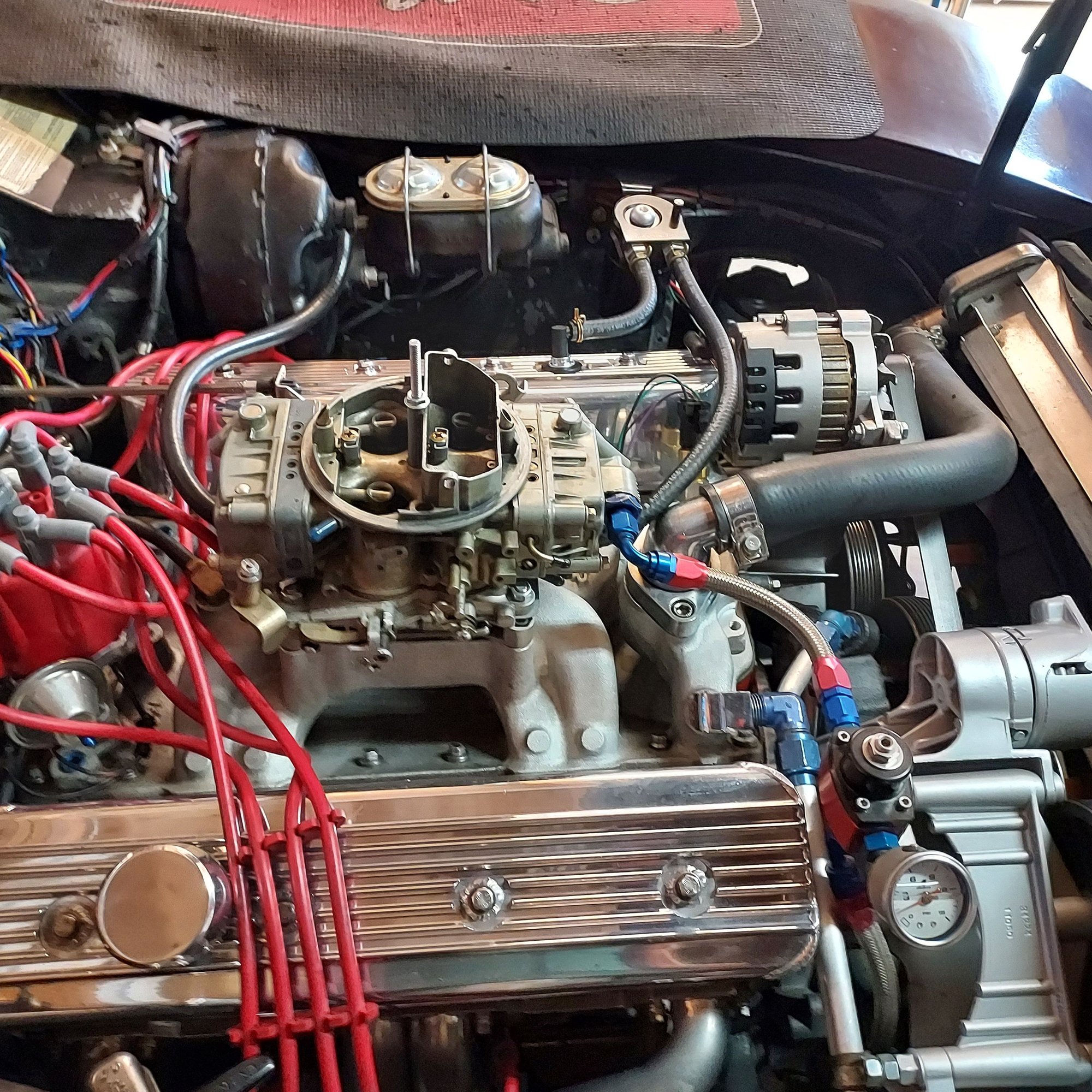

I had to give some thought to why my 650 Holley 4165 works so well on my mild 383 stroker. I believe it's because the 4165 is a Quadrajet style with the big secondaries. The secondaries are far bigger than the regular 4150 style Hollies. Being a mechanical secondary carb, when you put your foot into it and those big blades open, it feeds a whole lot of air and fuel into that motor. At least that's my experience. Pulls hard to 6 grand and above, no flat spots and neck snapping response. Your results may vary.
