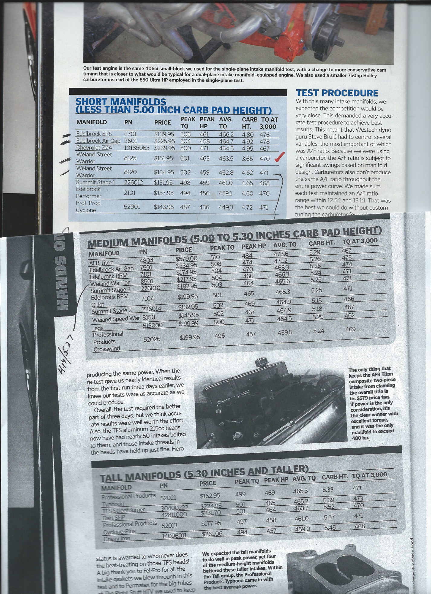

When I broke in and dynoed my 71's motor. ( forged steel crank - roller) The engine builder's dyno showed only a 2 to 3 HP difference between the Elde, the air gap and the Weiand.
He was amazed that the Weiand Street had a lot more Torque down low , which I wanted for a street motor. No other noticeable differences, he now is using them. I stated laughing. Holley now owns Weiand. (?)
Just as a note as a former Pontiac Guy, the Pontiac motors had "air Gap" manifolds from the factory with a valley pan.

It's because the Weiand keeps the divider intact and RPM air gap has the notch/cut-out. Why I want a Summit stage 3 for my truck project, when I have two RPM air-gaps and a few other air gap dual plane intakes. All mine have the cut divider.

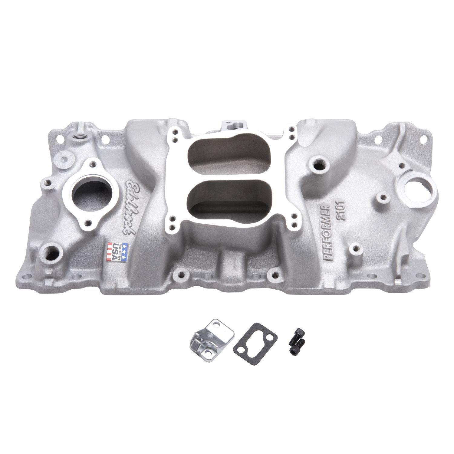

Edelbrock 2101 ( pictured below ) includes 8901 cover plate for divorced choke. You can reuse the divorced choke thermostat from your manifold. You will need to modify the choke rod length or purchase this https://www.edelbrock.com/automatic-...etor-9171.html
Edelbrock 7104 is .70" taller than #2101 ( as per edelbrock website) https://www.edelbrock.com/performer-...fold-7104.html

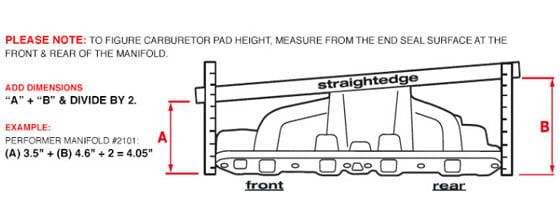

There have been numerous threads asking the same question over the years, and the discussions usually become just like this one, talking about performance and design.
In a couple of the older threads the members used straight edges laid across the hood lips in the engine bay and made measurements from the top of the oem intake carburetor pad to the straight edge to determine how much room they had to play with and then could determine how much higher the new intake carburetor pad could be.
If you plan to keep the QJet, it will limit your choice of intake models you’ll have to choose from.
If you want it to fit under an oem big block hood, purchase the intake with the lowest carburetor pad height, install your QJet and if needed find a drop base air filter to get it all under the hood.
If you want the best performing intake, for your QJet, that will fit under your hood, then ask someone like Jebby or Lars who work on C3’s, run QJet’s and could recommend the best combination.
You can also compare carburetor heights.
They are usually found on the manufacturer’s website.
A Holley or other brand name carburetor may give you more clearance do to a lower profile design and changing to a square bore carburetor would open up your choices of intakes.
You can always just built the engine for max performance and then plan to modify or replace the hood to fit everything underneath.
For example: My big block with an Air Gap, 1” spacer, flat base air filter and 3” element, may fit under my tall L88 aftermarket hood which is built 4” taller for clearance.
If not, I’ll have to run a drop base filter.
If I remember correctly, there is one model Edelbrock intake listed on their website that says it will fit a C3 Corvette.
If it says it will fit, then that could be the intake you need.

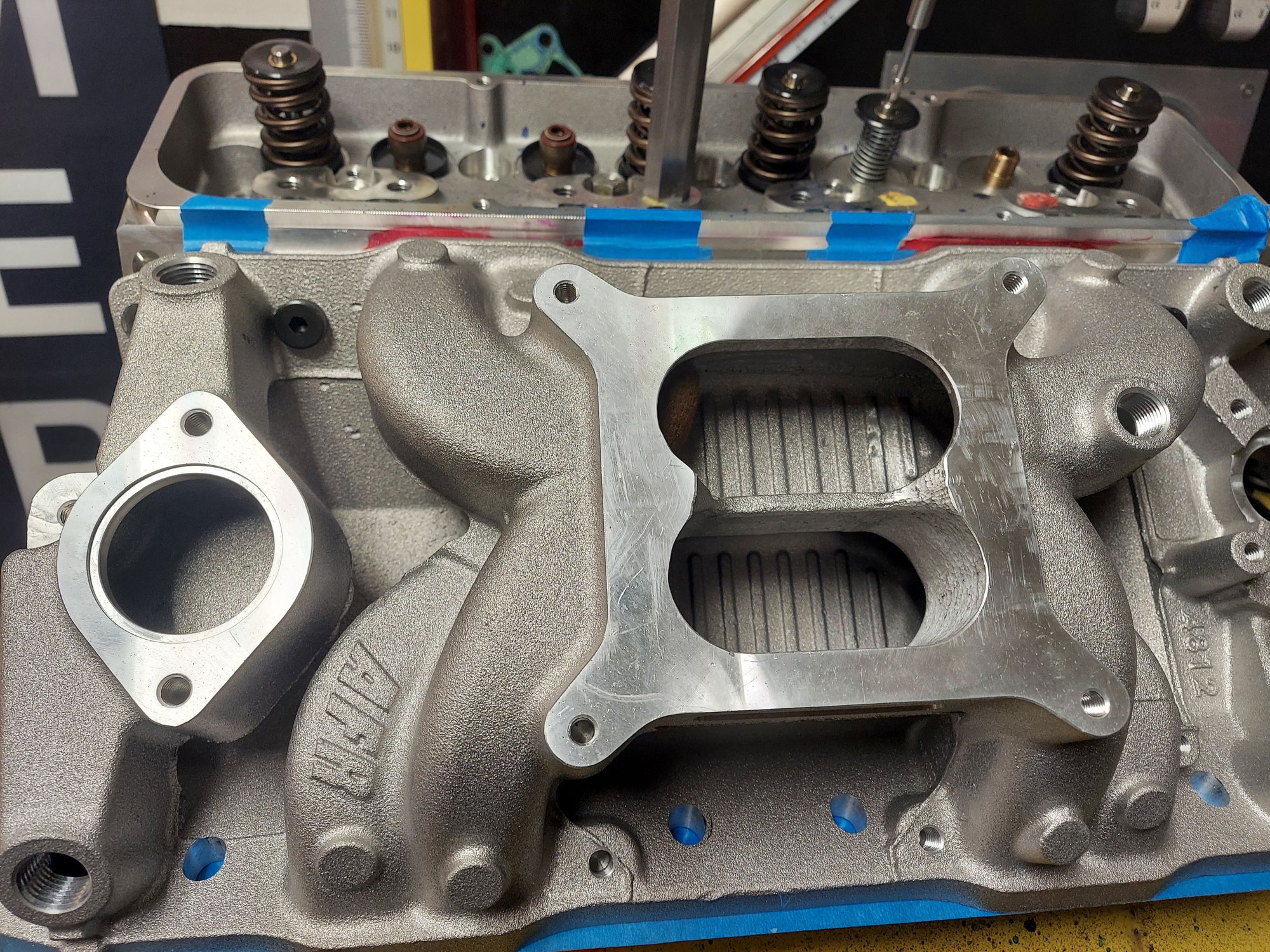

Probably any of the air gap intakes
weiands newer air gap may have bigger csa than edel. Idk. Holley list the exit size
Here is afr's on my flow bench.
I was kinda disappointed how the csa at the exit was all over the place out of the box.
unused ports are either taped up or foamed.
My cam lift is about 530 after figuring in some deflection.
It went 255cfm ported to a trimmed up 1205 that matches head exactly, at 530 lift on that runner. No intake 274 cfm or something. Not ported idk.
Csa from afr at exit was about 1.85ish
Heads are afr enforcers. Testing only the port, That one port in pic was high 250s max. before porting the head. Some ports where 270ish from afr. Now there all mid 280s
that how it goes. Especially with china heads. Obviously you want them all close to the same
These parts are going on my c3.
use to build bikes, so just using my tools I have for myself now
