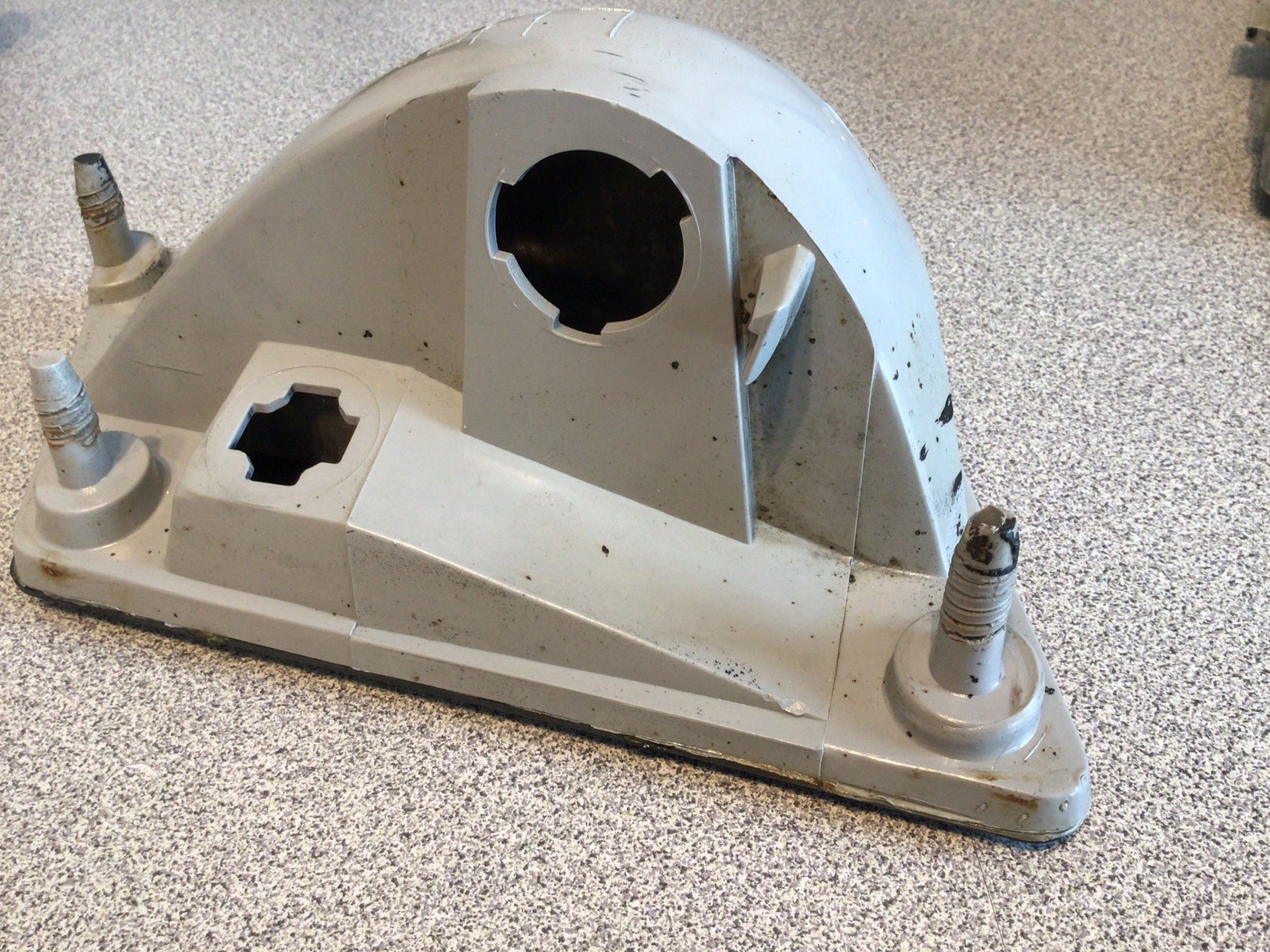

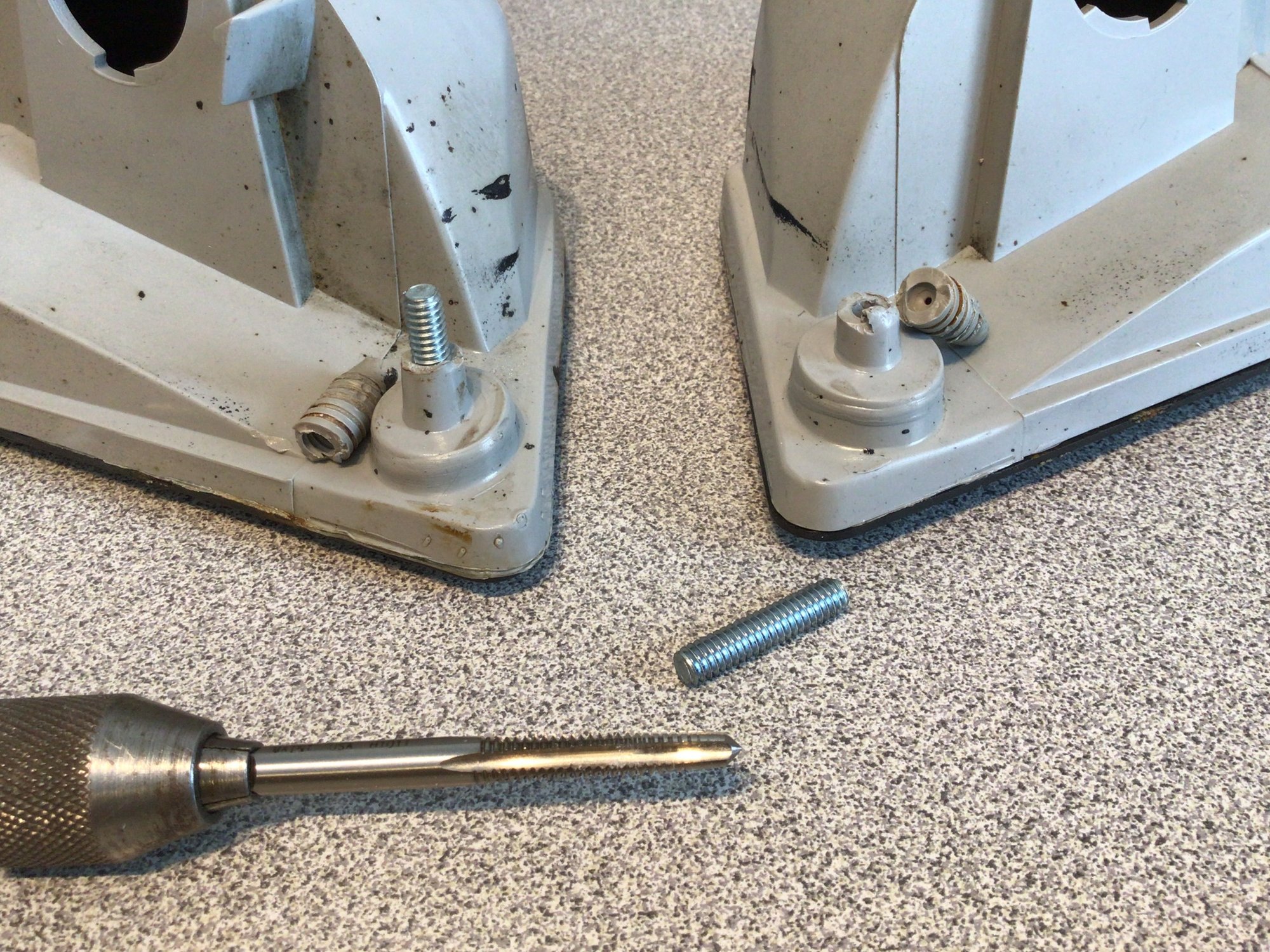

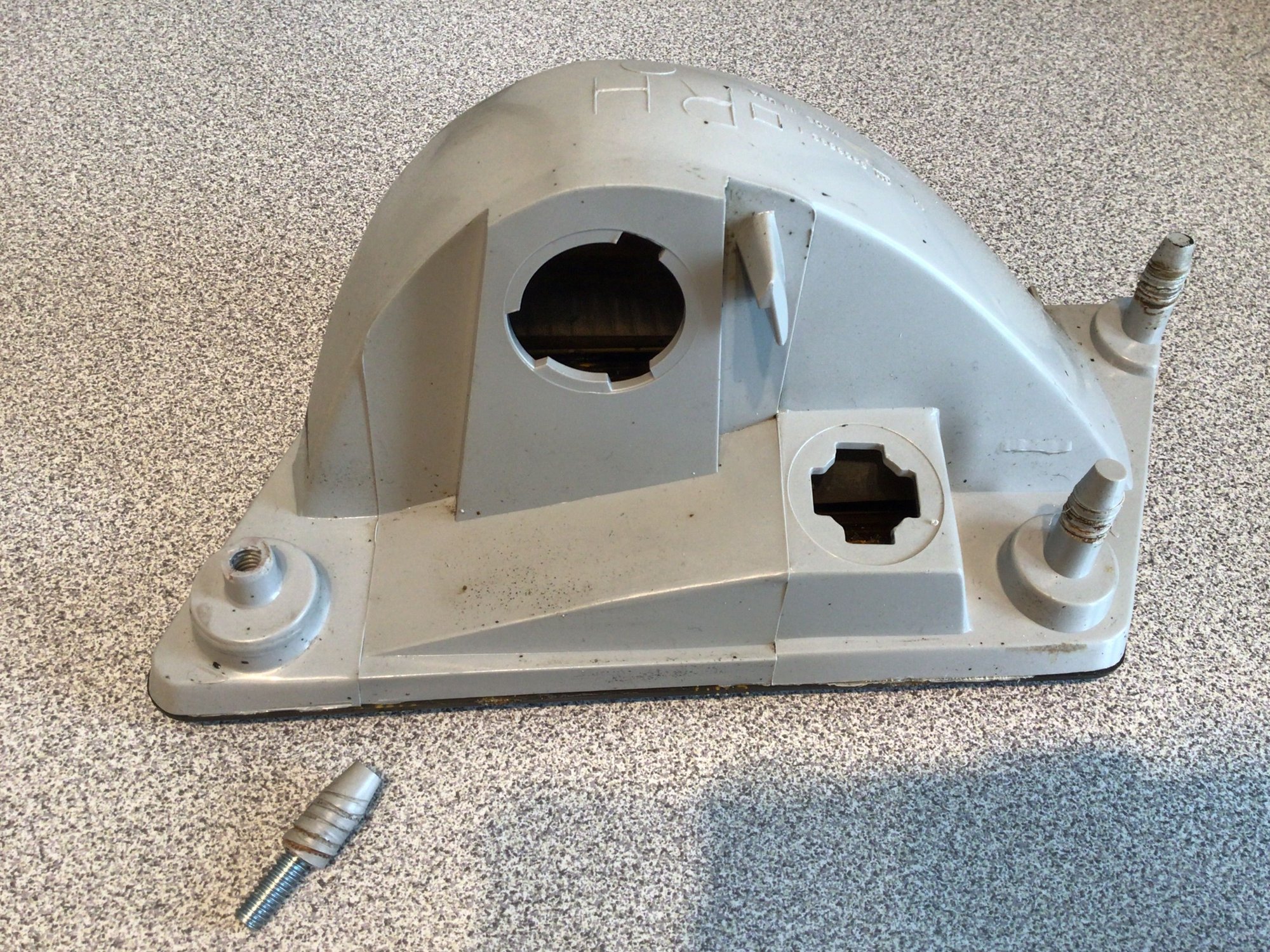

I repaired my front side marker lights instead of replacing them. One of the mounting posts on each light snapped in half upon disassembly. I purchased threaded studs 12-24-1” from McMaster-Carr. I then used a 12-24 tap to make threads in the plastic. I used a #14 drill to drill a hole in the center of the solid broken piece then tapped it for threads. I coated the threads with an adhesive then assembled/screwed the two halves back together. It’s now stronger then original.
