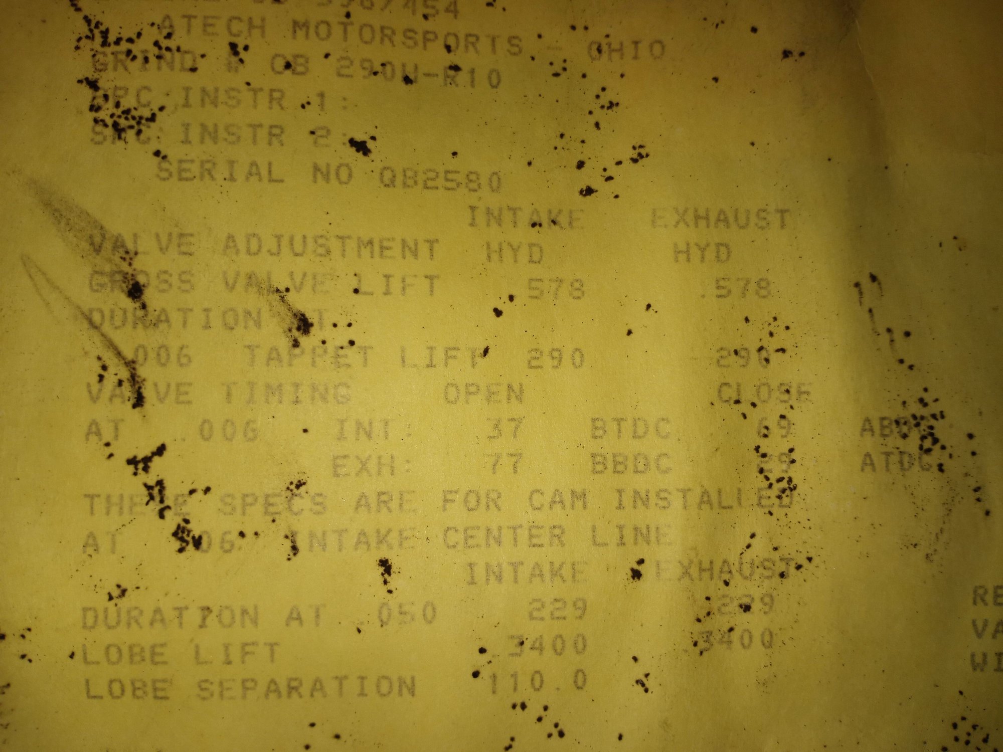

The cam card is a little hard to read. 074 heads also... not sure what the valve sizes are. Carb rebuilt about 8 yrs ago.

What you got there is a cam with 70* of overlap. And lots of lift.
A cam with that much overlap is going to want lots of timing and some bypass air to get it to idle. What Jebby and 79l82 are suggesting is what I believe you need to do on a Holley to get bypass air.. or drill the secondaries. On the timing jack that up to 36* or there abouts, maybe even more, with vacuum at idle. Adding bypass air and enough initial timing will clean up your idle issues.

Also, that 110 LSA cam is never going to run "clean" at idle... There's a really good reason that the factory performance cams are all in the 114-range. A 110 LSA cam needs lots of compression and a lot of timing.
Lars

With that cam whats the ideal initial and overall timing I should run?

Looking for about 18 initial and 36 total....vacuum unplugged. Ideally....the vacuum should pull about 10-12 itself.

I idle with 36* of initial timing including vacuum. Running 108 LSA. Engine likes that much advance for my overlap and altitude. CR is a big player here. How much you got?
Total timing is different. That's timing with mechanical fully advanced + initial, vacuum does not come into play for total timing.
For total timing it's gonna depend on the heads more than anything.
