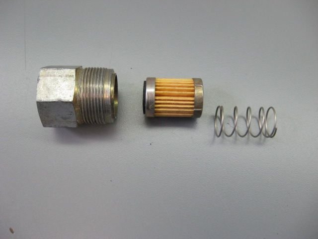

If you have a new filter correctly installed, you might want to check your fuel pressure. The hole in the center of the filter needs to be pointed towards the fuel inlet fitting:
Your fuel pressure needs to be over 4 psi but less than 7. But always check your ignition system and timing first before chasing carb problems.

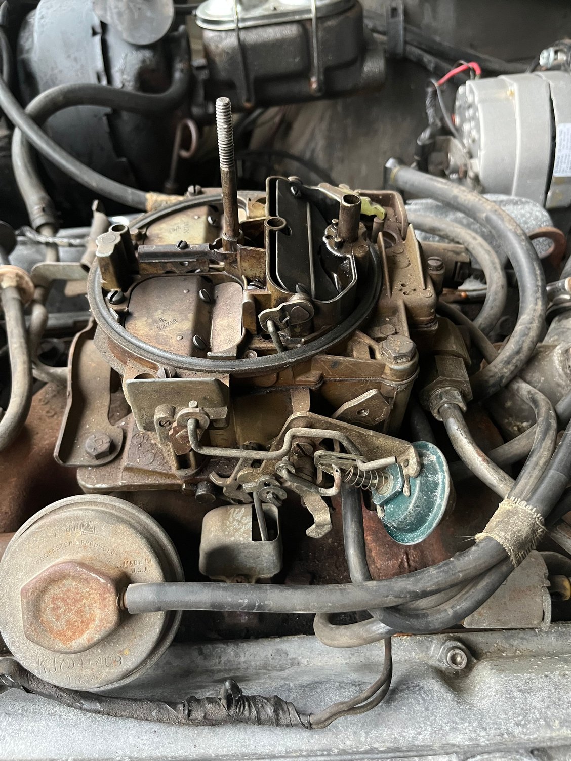

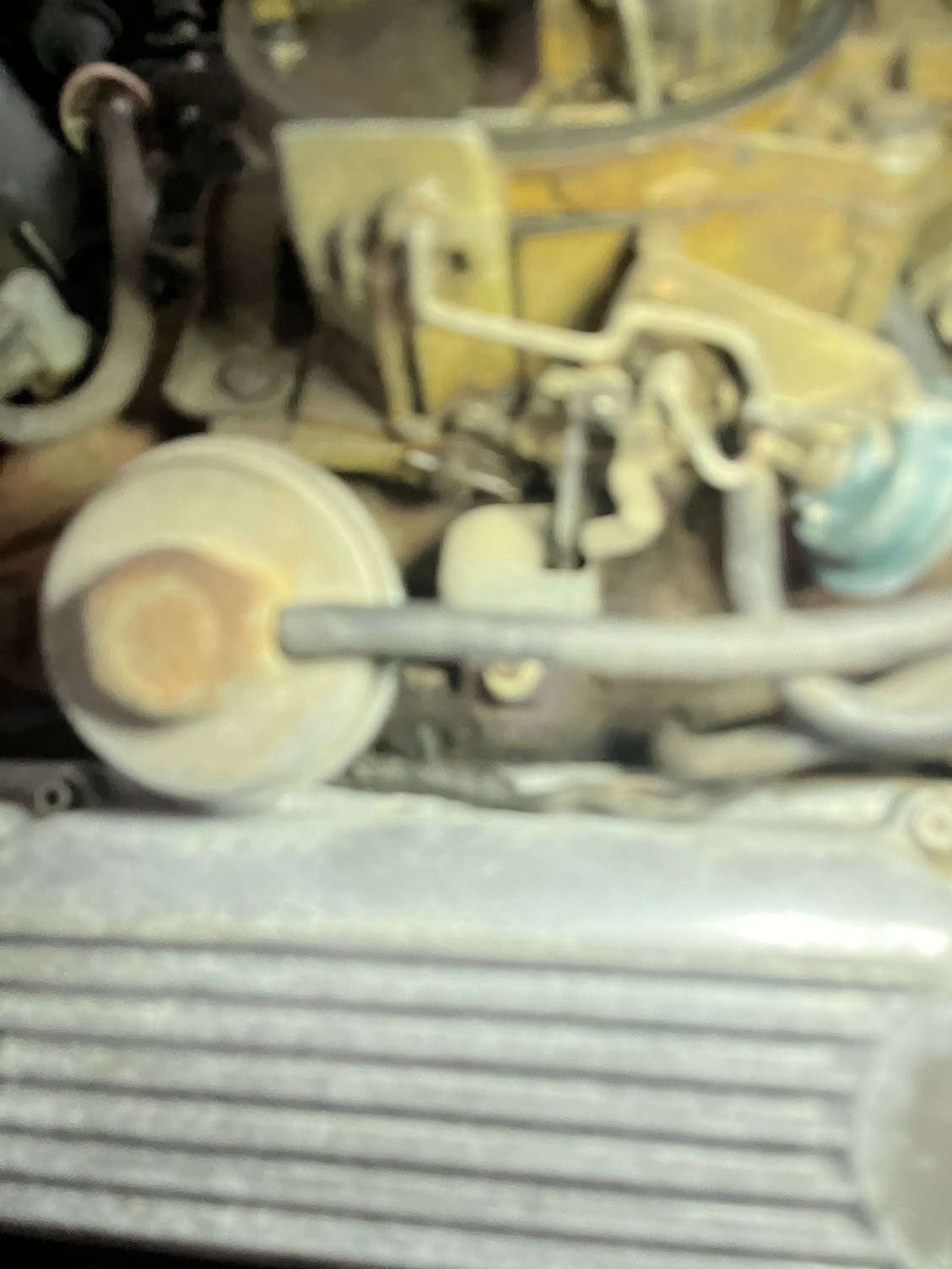

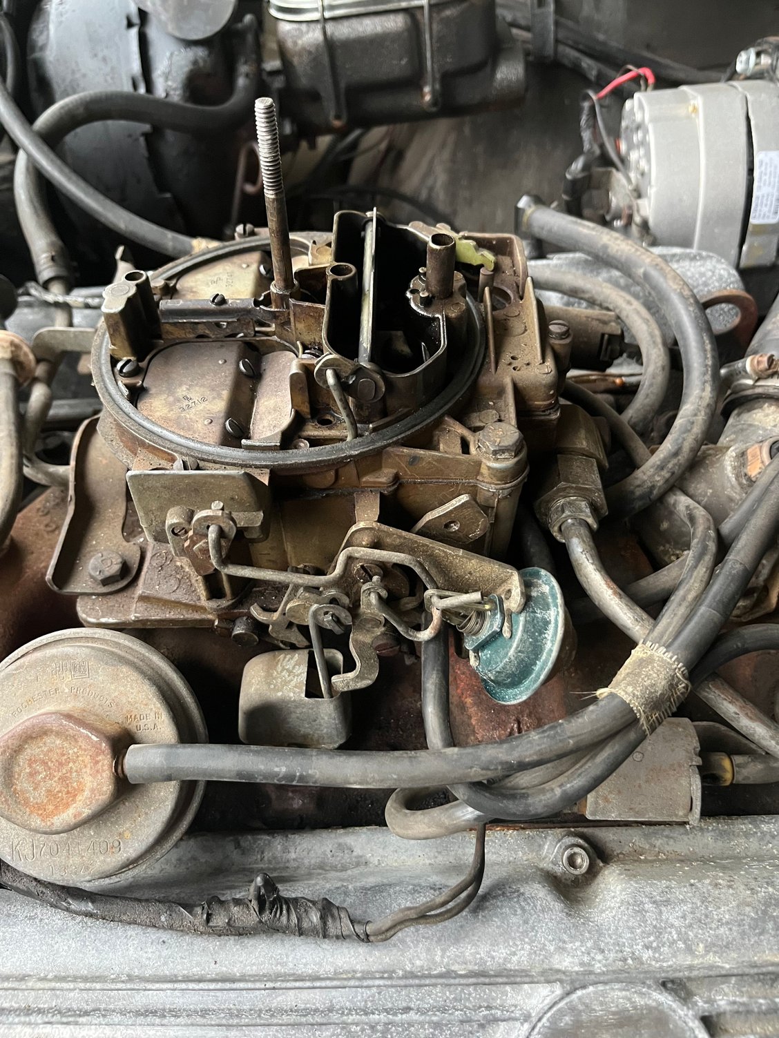

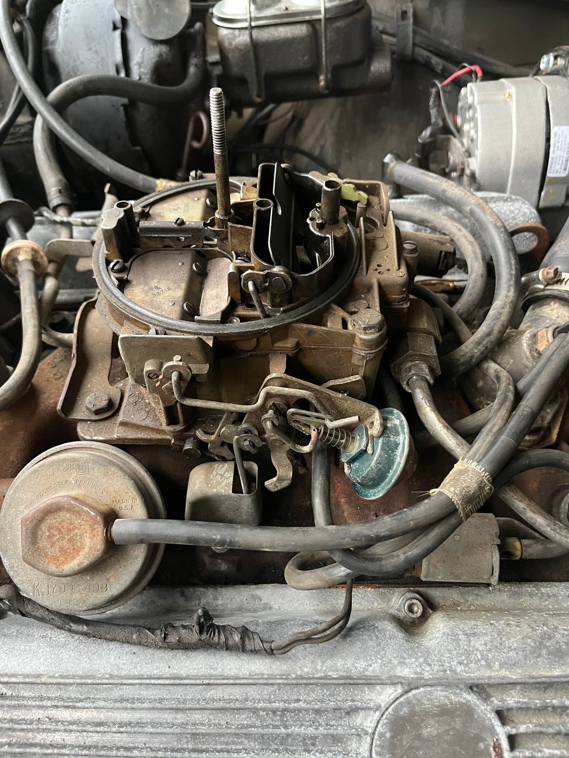

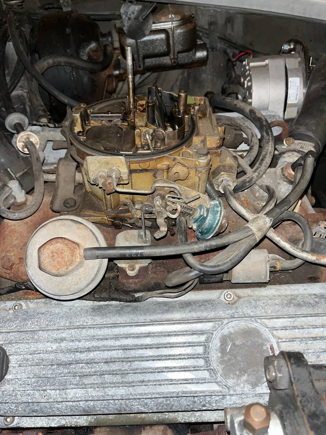

I’ll send pics of the stages
1. Took AF off and cold engine.
2. Pumped gas one time.
3. Cold start engine running.
4. Engine running after warmed up.
1.
2.
3.
4.
Old Jan 21, 2023 | 09:30 AM
MelWff's Avatar
MelWff
Posts: 18,737
Likes: 2,582
Assuming in 2nd picture engine is Not running and you stepped on the pedal once, the choke is not completely closed. How warm was the air temperature?

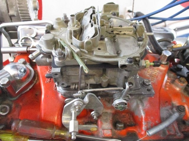

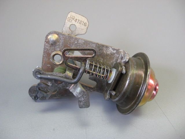

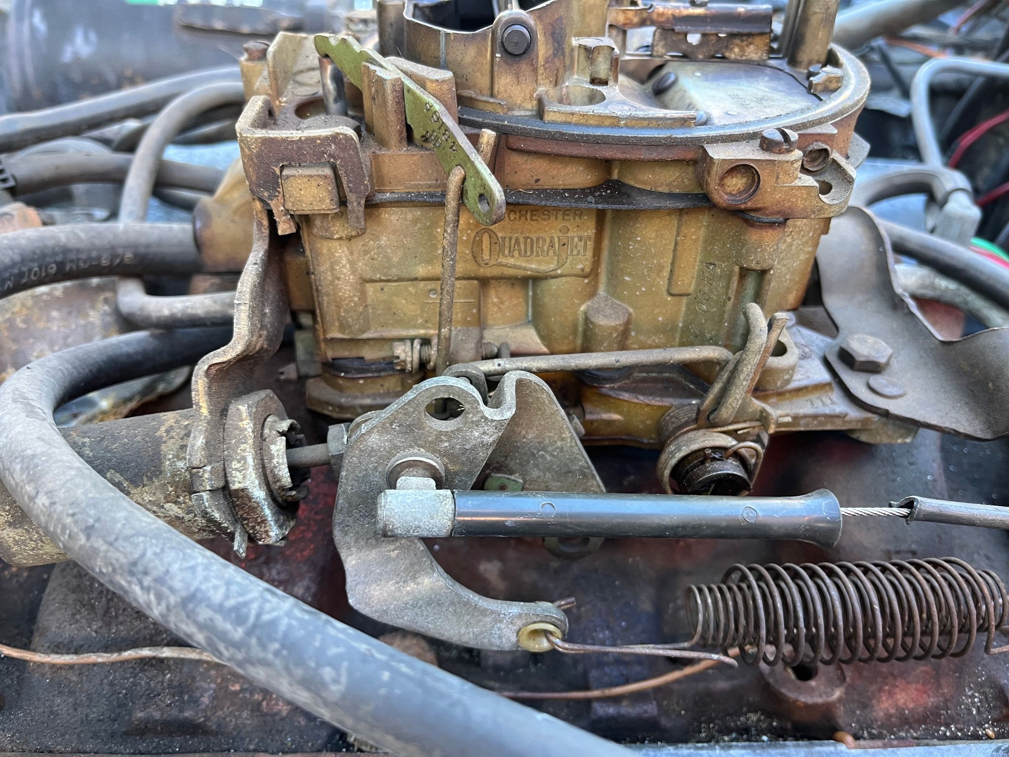

Your choke pulloff is adjusted completely wrong. Note the short pulloff link is almost folded over at a 270-degree angle to grossly shorten it. This is pulling your choke wide open upon cold start. Straighten that link out and repair it so it pulls the choke open 1/4" only.
The linkage should look like this:
When the engine starts cold, the choke pulloff should pull your choke open this far:
Lars
Lars
It was 50ish temperature that morning. I’ll adjust the linkage per photo and give y’all some feedback. Appreciate the help!

Holy smokes guys, bending that linkage did the trick!!!
1 pump start was right on AND it solved the issue of chocking out at 2500 rpms!!!!!
