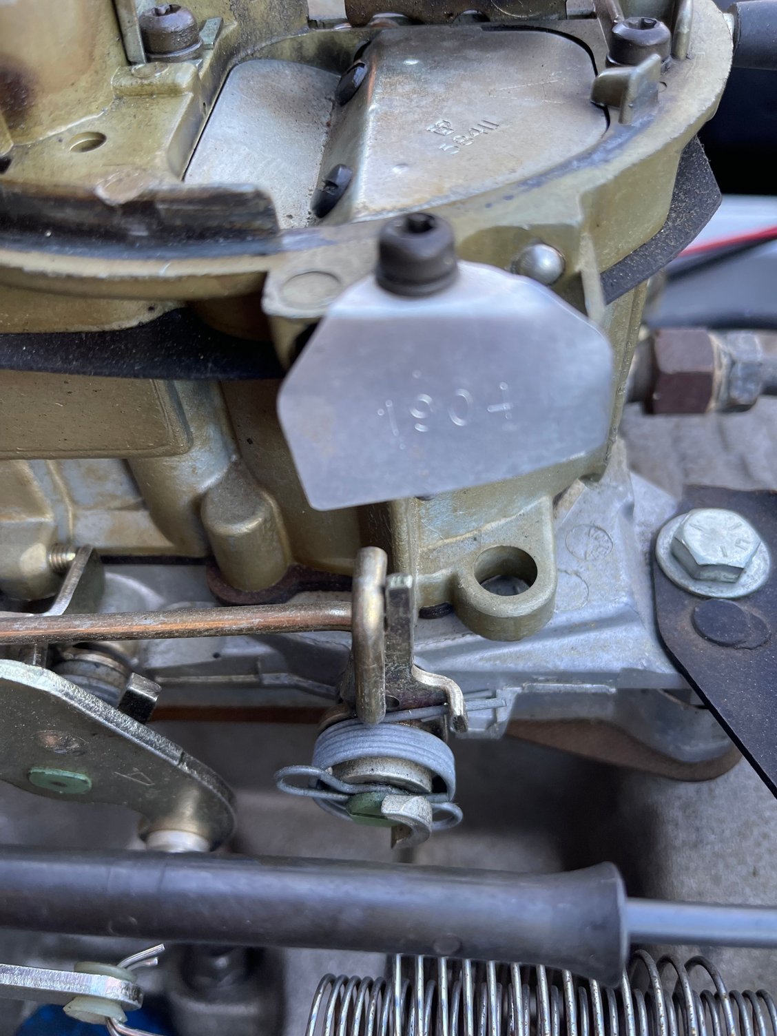

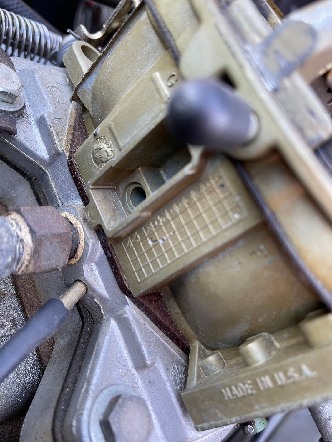

Hello there - I recently bought a very nice low-mileage 1979. Originally an L82, sometime before the last owner (I would be owner #3) obtained the car in the early nineties the L-82 was replaced by a ZZ3 crate motor. I was (not now) having starting issues with it so I pulled the air cleaner to figure out what kind of Edelbrock was on it to perhaps order a rebuild kit or send it out to be rebuilt. There are no identifying marks on the base of the carb where the Edelbrock site says to look, only a tab attached to one of bolts with "1904" on it. This would decode to a 500cfm manual choke unit intended to work as one of a dual-quad setup, so I don't think this is right (and 500cfm seems small for this engine). Any guesses? See anything really out of sorts so far on this engine other than it has no fan clutch?

It's an Edelbrock 1904, which is a 795 cfm Q-Jet M4M model based on a mid-'70s truck carb.

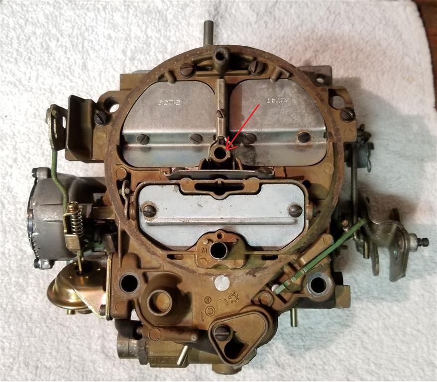

Years ago I purchased a brand new 1903 to use on my 77.
Similar carb except the 1903 is setup for the hot air choke not electric like the 1904.
Never could get it to run like I think it should run.
The port for the vacuum advance on the 1903 & 1904 is ported vacuum not full manifold vacuum.
You can see from this photo the 1903 on left and my original 77 carb base on the right the slot is not visible when the throttle plate is closed vs visible on the 17057204.

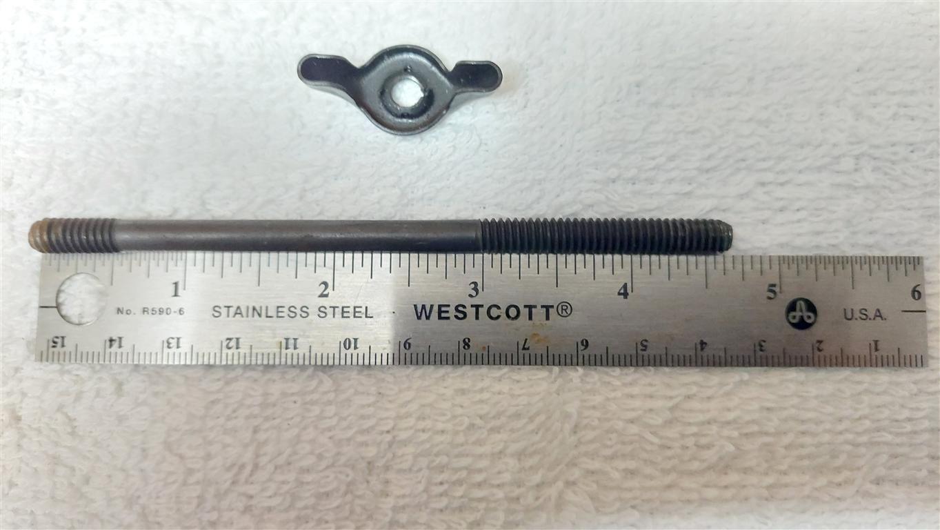

Thank you very much; I'll start with that. We've only had the car a week and we're still discovering all of her secrets. Here's a dumb one though - how do I attach an air cleaner to this thing? There's no central threaded rod to go through a 'standard' screw-down open element air cleaner.
Robert
I can't tell you the length you need for an open element air cleaner but I can give you this...
The original Air Cleaner stud for my 1977 Quadrajet (also worked on the 1903) has 1/4 X 20 threads both ends with a total length of 4 5/8"
The length of threads cut that go into the carburetor is 5/8"...
If you are going to thread a piece of round stock, I wouldn't cut the treads any deeper than 5/8" going into the carb...
Hope this helps...
