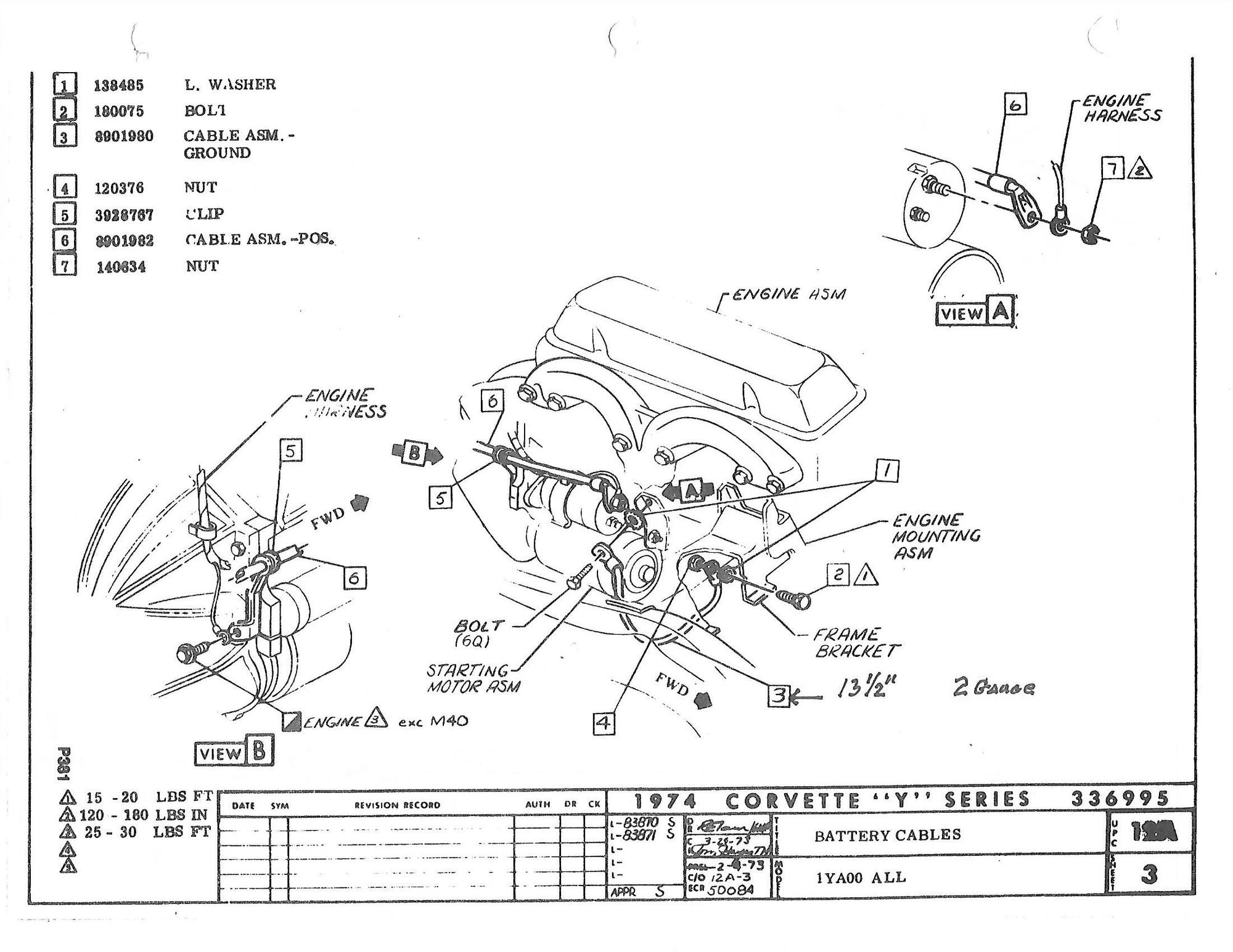

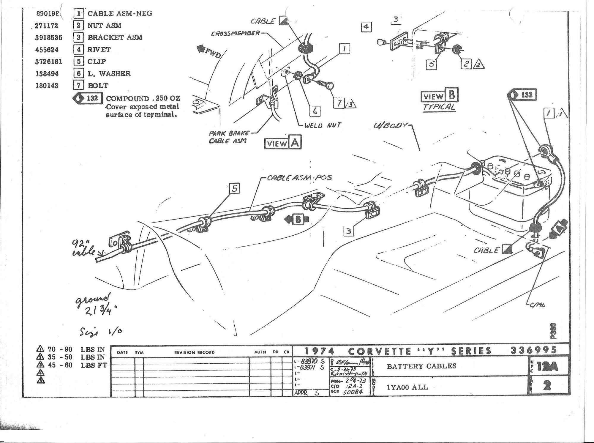

The negative cable is connected to the frame under the car.
Open the battery door behind the seats and follow the cable under the car.
See item #1
There is a starter to frame ground cable up front, check that one too.
See item #3
See item #1
See item #3
