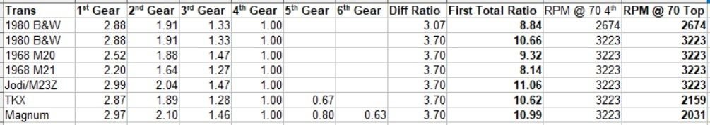

But anyway, here's the spreadsheet with some transmissions. The first line is a stock 80 L48 4-speed, the rest are the OP's diff ratio. This assumes a 27" wheel/tire diameter. With a 3.70:1 diff, he likely has an M21 Muncie? There are other TKX and Tremec Magnum options, I chose the options that have the TKX mirror the 80 B&T ST10 (plus a bonus overdrive), and the Magnum mirror the M23Z (plus TWO bonus overdrives, and likely some tunnel modifications). PM me for the editable version if anyone wants to play with the numbers themselves.
