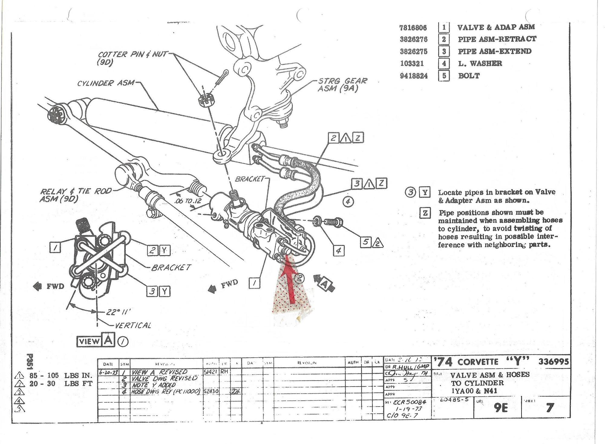

In a stock PS setup, you need to balance the PS control valve. There is a special friction nut under the round cap in the control valve for this purpose.

You can check the adjustment of the PS control valve by getting the front wheels off the ground and starting the engine. Even 1/8 turn of the adjuster screw off center will make the steering move without touching the wheel.
