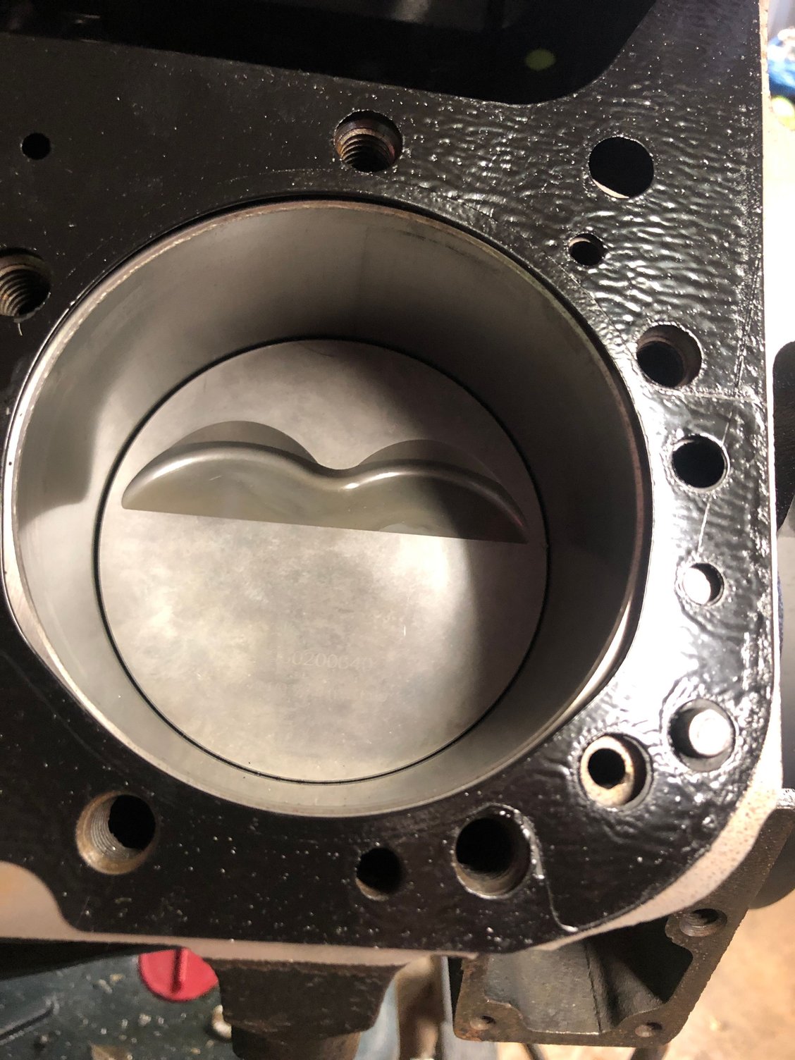

I need an odd thickness head gasket to get my quench thickness in the ballpark. Best thickness would be .057 compressed. I can get copper exact thickness. MLS come in .060 and .050 compressed. Heads and deck have a plain old machine shop finish.
Which ones do you guys suggest, as I can't get composition gaskets other than .039 or so compressed.

The thickness needed is frim measurements. The block has been decked and align bored so much that the pistons are .017 above the deck at TDC. I'm running. 039 composition gaskets with .025 copper shims. They work, but they're not the best setup and that puts the quench thickness at .047, also not the best.
Overall what I'm running is ok. I'm looking for a way to trim it up a bit. If there isn't, I'll live with the motor as it is.
