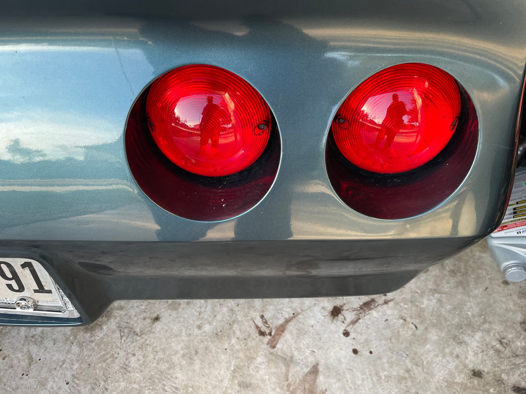

Had anybody changed out the rear Tail light to led on a 81?
The left side is plug and play, the middle left side I had to buy a new socket to match the one next to it so both leds Tail lights blink and brake at the same time. The leds has the two prong plug on all four so the middle leds would not work with the original socket. So I bought a new socket for the middle ones and just spliced into the other one by it and just matched the color wires. I also bought a led blinker. Everything was working fine until I realized with the head lights on the blinkers start to blinking slower and slower until it’s just stops blinking. Turn the lights off and they start blinking fine. Both sides do this. Again with the headlights off everything work great. Has anyone experienced this? Picture is attached for the ones I purchased. They are nice lit up and want to figure it out. Thanks for any input!!

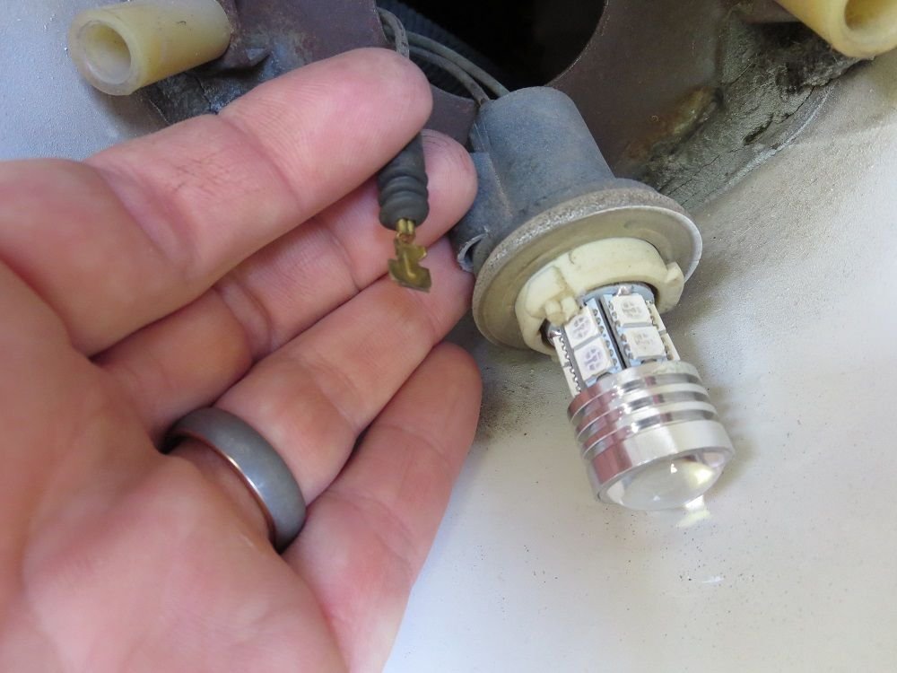

Check your grounds, and don't trust old sockets. I found a detached ground inside one of the sockets. And did you replace the flasher units under the dash with 3-wire LED capable units, and properly ground the third wire?

It is possible that both flashers worked correctly, but one just needed the base flipped around. The flasher I used (in my thread) comes with a base to reverse the orientation.
Here's a bonus photo of one of the sockets that used to be in my 80. It had failed internally, intermittently. Fun to diagnose.

All good with new led Tail lights. After putting everything back together I ran a new ground wire by the rear tail lights. Also found my battery terminals a little corroded. Don’t know if it was the better ground or the cleaner battery terminals but working great now! Now onto to led headlights, I’ll see how fun that is. Thanks for everyone’s help!
