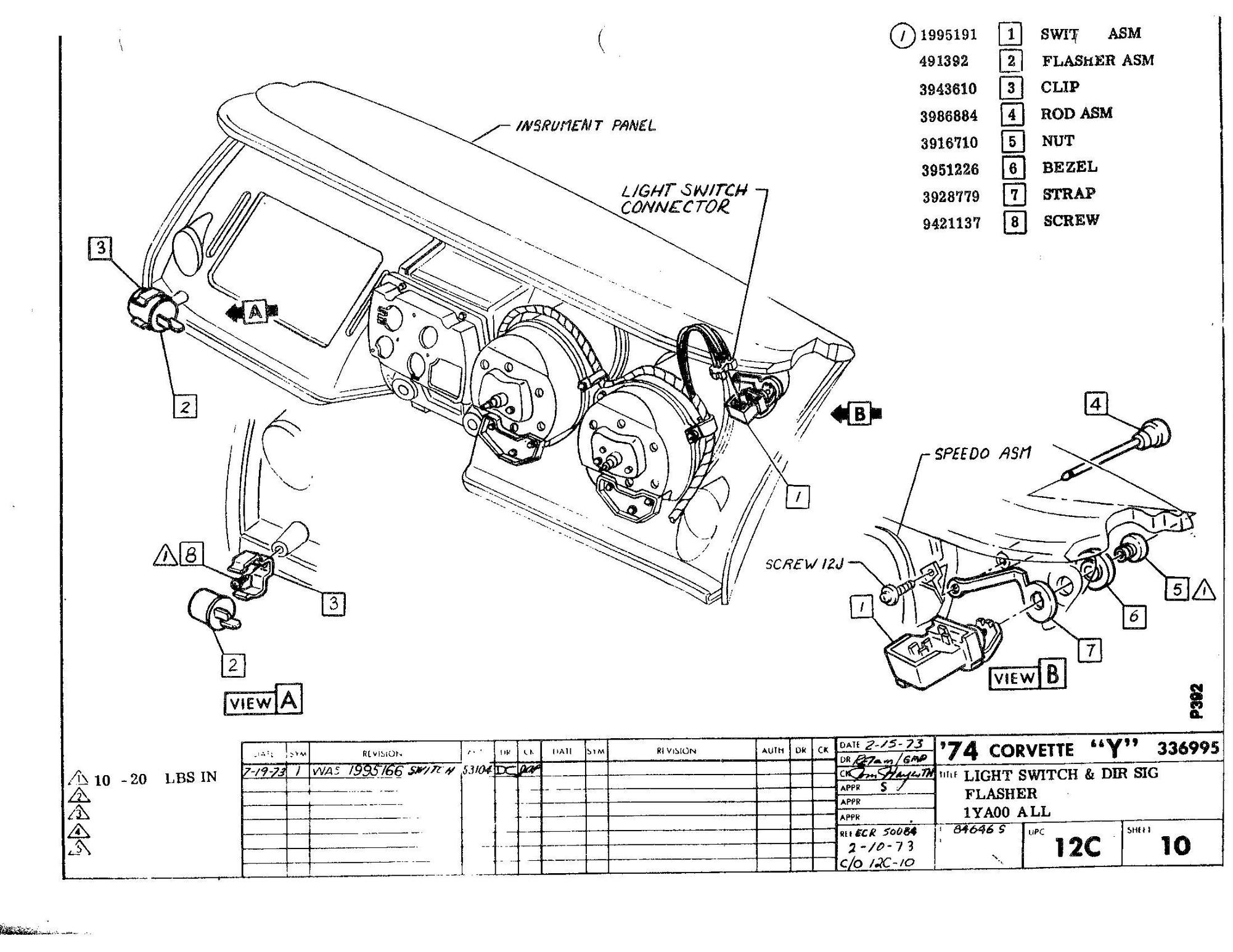

In '74 the flasher is under the right side dash:
See #2
If your interlock system is intact then you need to buckle up for the light to go out.

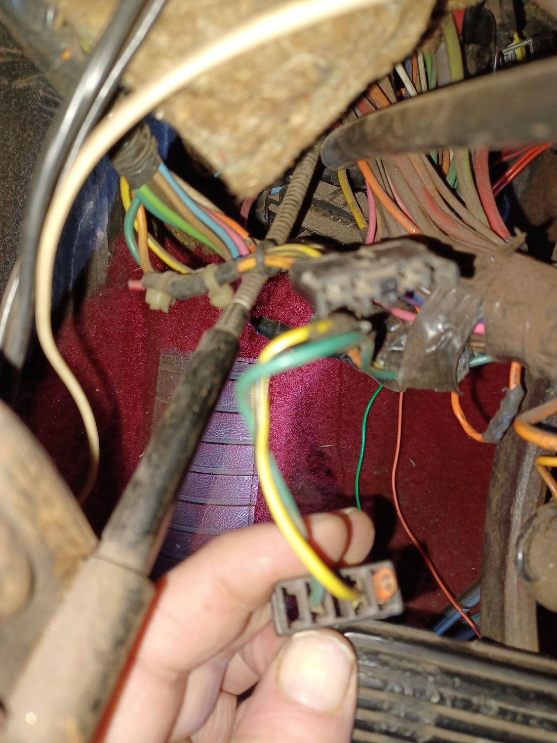

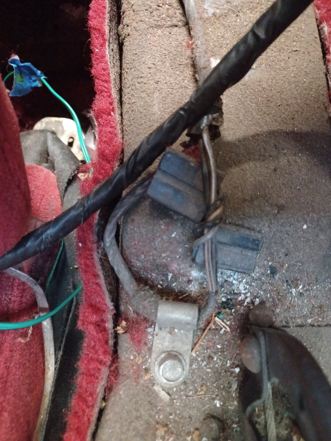

Yes I do see that flasher.. I probably need to replace it as the flashers never worked.. I found 2 connectors that were not hooked up, one is next to the hood latch handle, and the other is where the console was, at the very rear.. I have no clue why they are disconnected or what they are for.

also, it looks like a red or orange wire was snipped from it.
