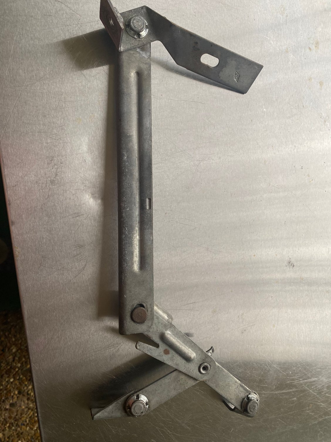

I am wanting to powder coat the hinges for the hood. Do these clips come off, and if so are they reusable?

I just power coated mine on my 70 and you don't have to take it apart I did mine all black

i drilled those rivets out and sandblasted, powder coated mine satin clear, looks good, replaced the rivets with new ones from Zip. i just wanted to make sure i got in all the nooks and crannies

Did mine in powder coat and never took it apart and I'd do it that way again

Did mine all together as well. Any time I'm doing something like these that moves I usually coat it, put it in the over long enough to just set the coating and then remove it, move it to a different position and re-spray that area and then back it complete
The white here is just some lithium grease

I’ll try that approach, thanks!
