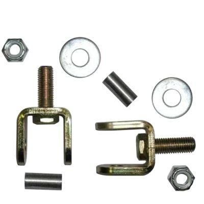

The Vansteel setup I am looking at uses a similar bracket with a bit more length. That way no enlargement of the tower opening is needed. I assume it would mean shorter coilover bodies are needed.
