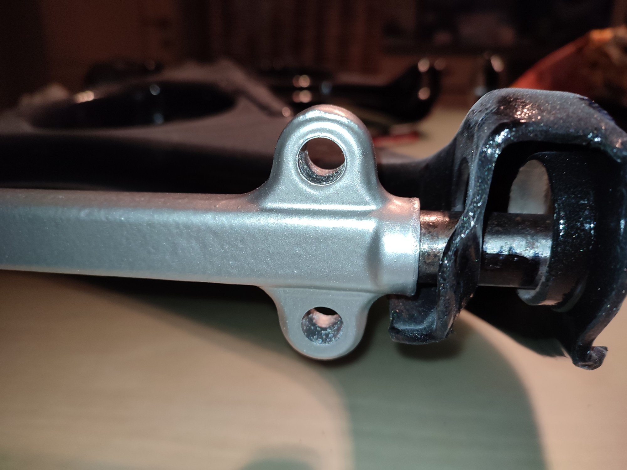

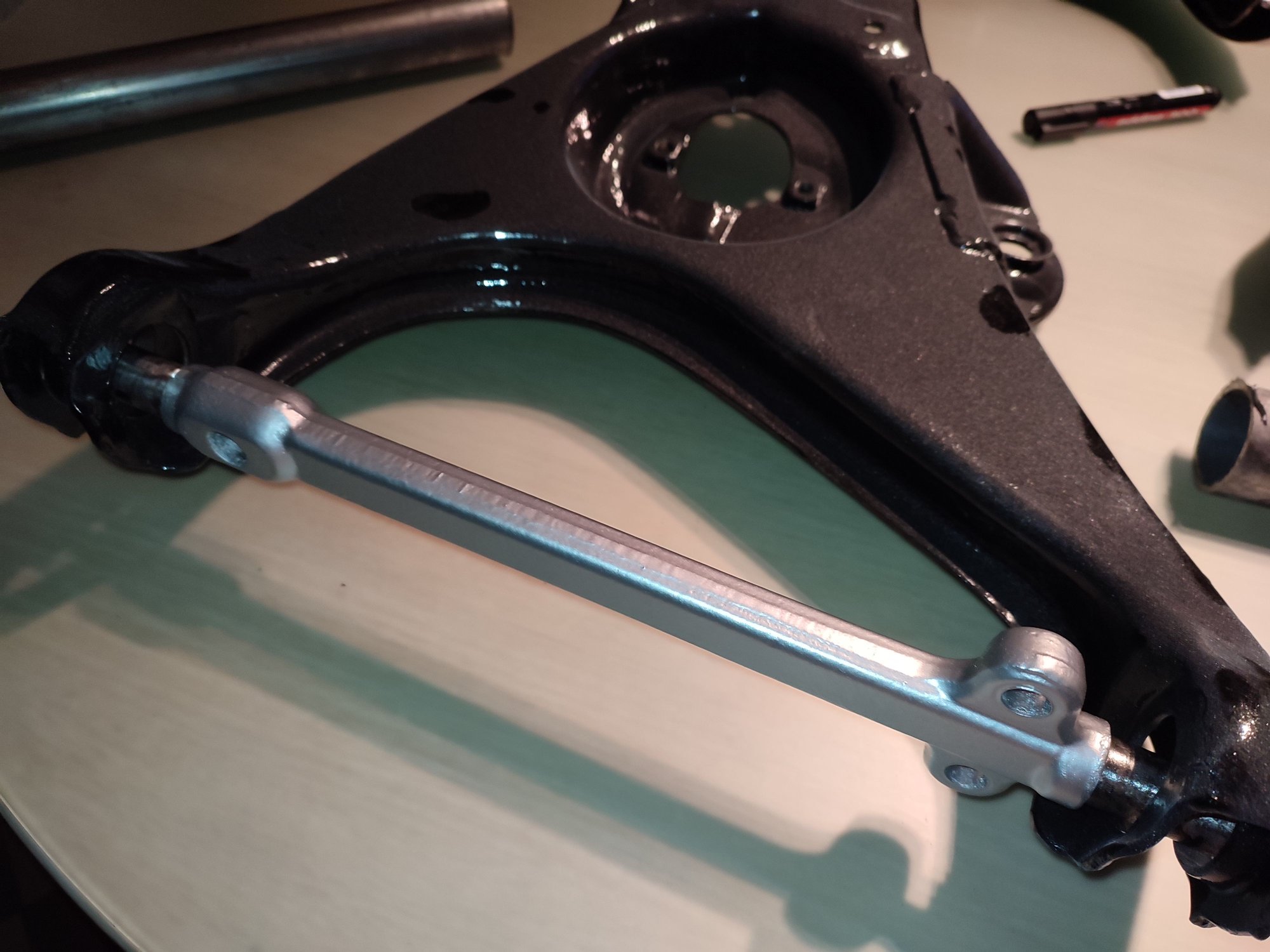

Hi everyone
Which side will install against the frame:
1: With part number against the frame?
2: With part number pointing to the ground?
1
1
2
2

The numbers should face the frame . If you look you can see that the shoulders , at the bolt holes , would have the shaft sit flat against the frame . If you flipped the shaft over , the bolt flanges , would not sit flat against the frame . To me that is what it looks like from your pics.

Thank you!
Now I can continue with the more 'nerve-wracking' job: installing the poly bushings in the A-arms...
