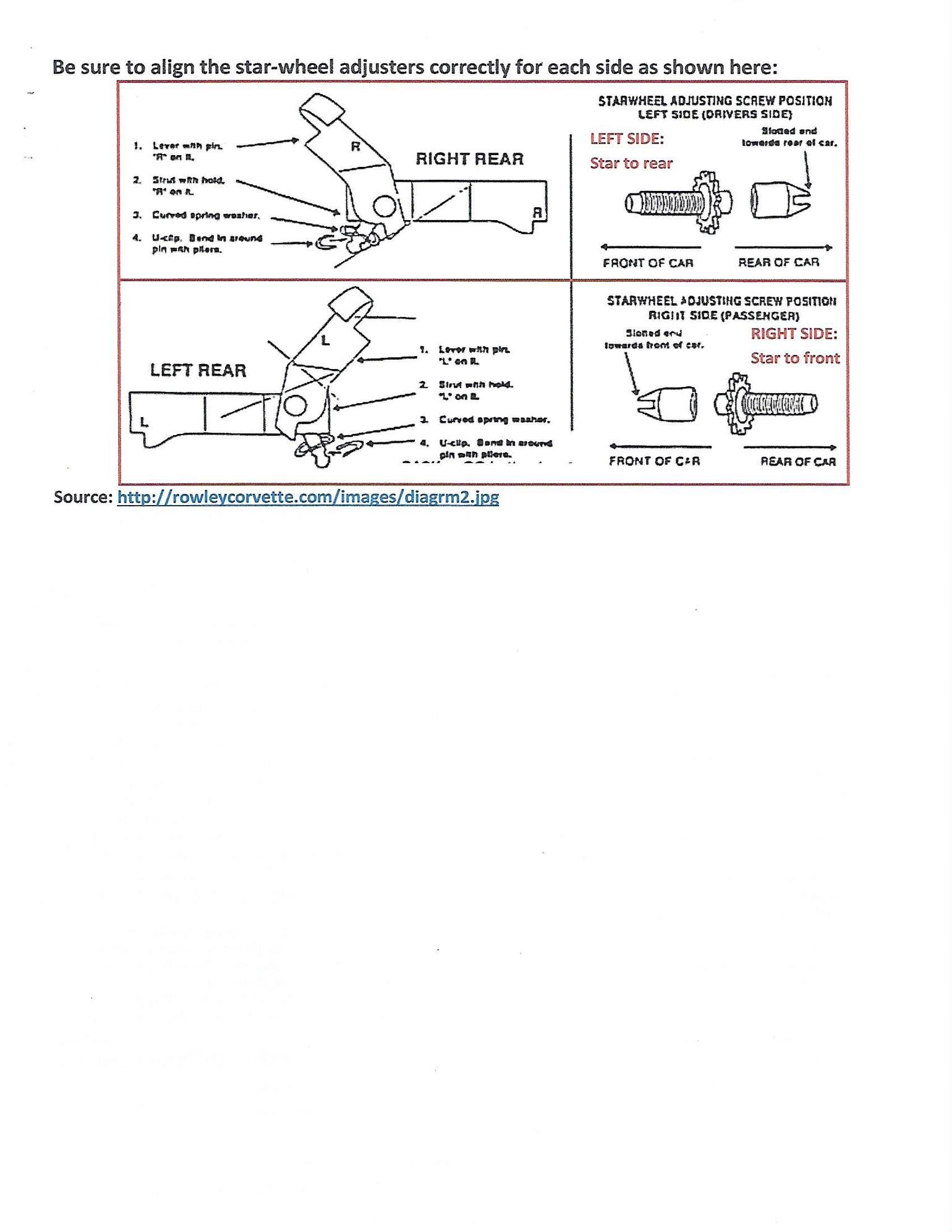

There is a shoe adjustment for each wheel. It's accessed through a small hole in the rotor when the wheel is removed. Check out this video and then do further searches:
PS. Any instructions you find for cars from '65 to '82 are applicable to your '72. They all used the same design.

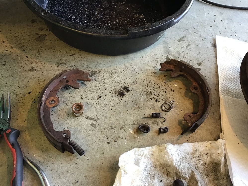

2- You made adjustment on the cable without positive results. This most likely is because the parking brake star wheels are seized, springs may be broken, or someone removed them years ago. Also, if intact, the cables are most likely stretched out.

  • Since the rotors were probably replaced at some point they will come off and then you can see if the shoes are snug, if they pull out easy one of the springs is broken. You can try to move the star wheel, maybe spray the threads and see if it moves. If it moves work it in and out until you can see the shoe position change, then you can adjust them but that may be wishful thinking.
  • Look at the inside of the rotor hat for grooves, they can be trued in a lathe but unless you have a lathe, the cost outweighs the cost of new rotors.
  • If you go with new SS PB hardware, check the parts close. There's only a couple of suppliers yet all the vendors sell them. I NEVER use new SS hardware without modifying the parts.
  • You can replace most of the parts on the car with patience and a screwdriver with some slots cut in it for a spring tool. You won't get the anchor lock, or one hold down pin changed since they are captured.
