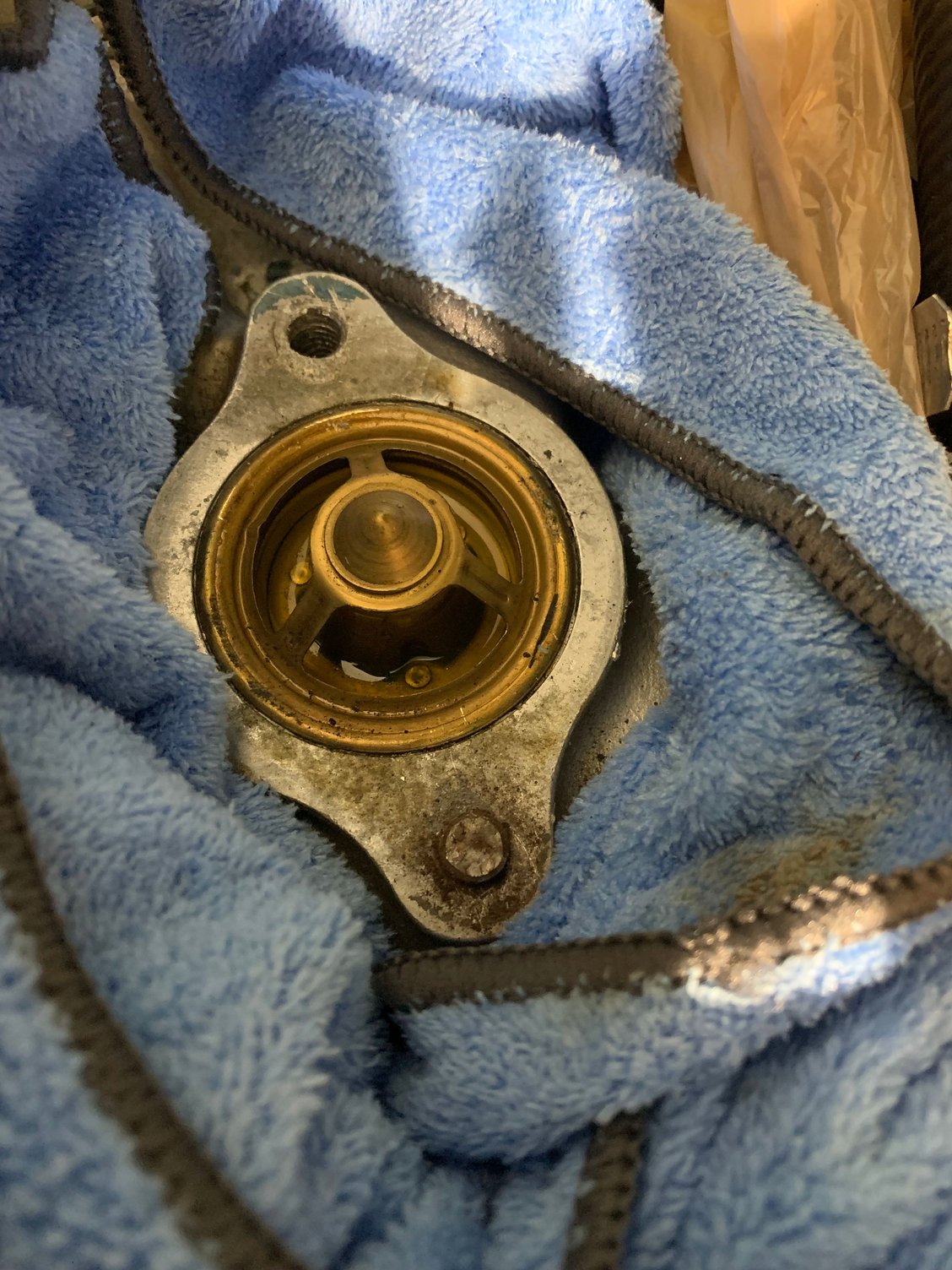

Hello!
I broke one of the bolts to the thermostat housing while trying to replace the thermostat.
I've tried using locking pliers to hold on to the piece sticking out, but that is not working.
What is the best way to remove this broken bolt?

From another post KFO has this:

The broken fastener appears to be in an aluminum intake. Spray a little penetrating lubricant and let it sit. Take out the T-stat and draw down some coolant if you need to so that you can tape off the hole and effectively get heat around the bolt. Clean the manifold surface and tape off the hole. Center punch the old bolt and drill it for an easy-out (the set may suggest a drill size). Clean up, pull the tape and heat the manifold around the bolt and go for it. Worst case you reseal the opening, upsize the drill and replace the threads. Worst, worst, case you pull the intake and send it to Wilson in Florida and it will come back as good as new.
