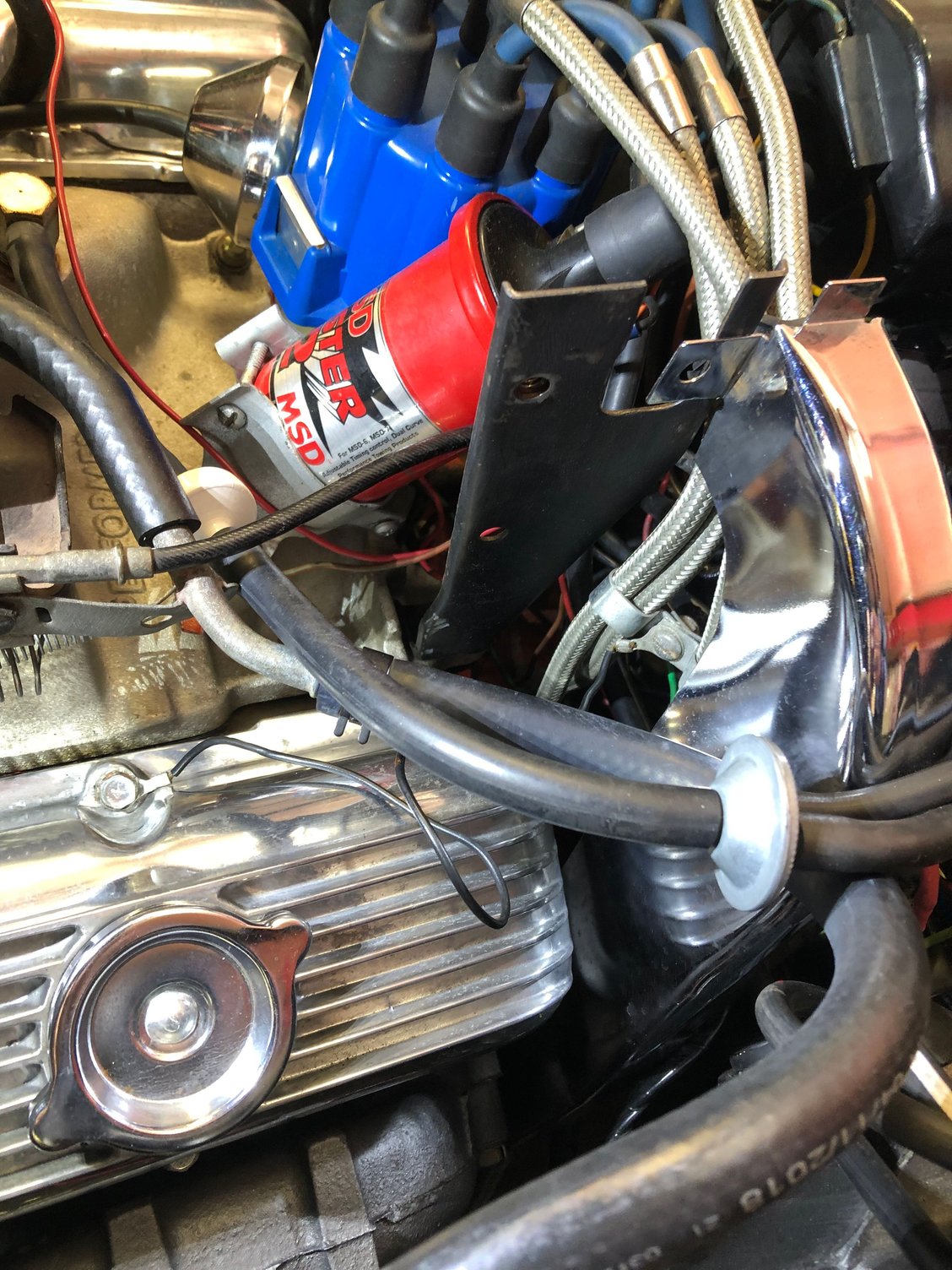

I have a 1973 350 SB engine and will be replacing the Edelbrock Carb and intake manifold. Through strange circumstances, I acquired the OEM manifold and Quad, which Lars has restored for me. My question is which Intake Manifold Bolt is used to hold the Brackets. I have tried Google, AIM, and all the vendor catalogs, but none shows which bolt secures the Top Shield Bracket. I would really appreciate a close up photo that shows the bolt used for the passenger and driver Brackets. I believe that the brackets are the same for 70-74 SB Engines. Thanks for helping.
Passenger bracket is second bolt from firewall on Edelbrock Manifold
Driver bracket is the first bolt from the firewall on Edelbrock Manifold

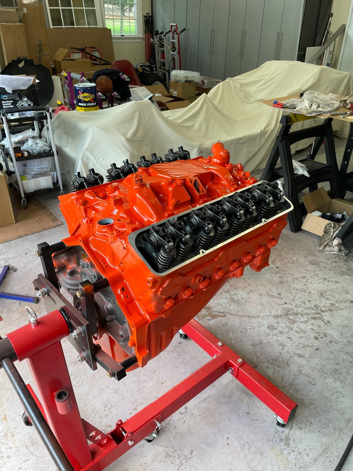

Back on topic. I believe what changes after '74 is the bracket itself, not the attachment point. The brackets change because the distributor shielding adjusts for the HEI distributors. I am doing a '76 and a family member is doing a '72 and we just put both motors together.

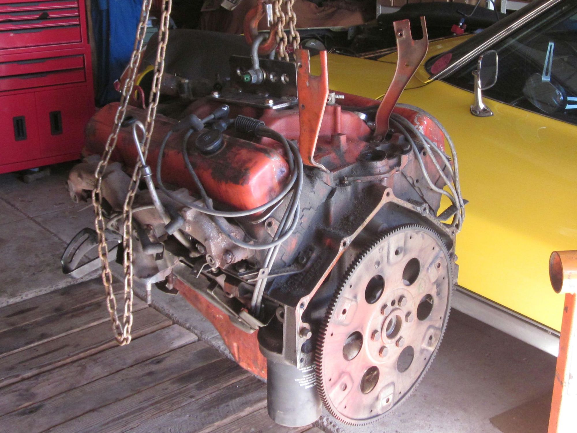

My '72 when I removed it back in late 2013.

I STAND CORRECTED! Left side is one bolt forward of the '76 mounting point.

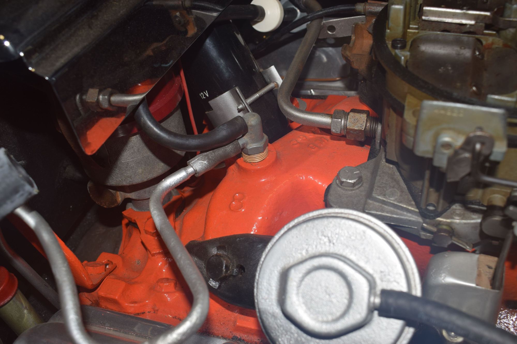

This is the best photo that I have of my 73 bracket mounting, hope it helps you.
Donnie

The photo of the removed engine confirms that the brackets are attached with the same intake bolt locations. The driver side uses the bolt closest to the firewall, and the passenger bracket is attached with the second bolt from the firewall. Thanks also to Donnie for your photo.
