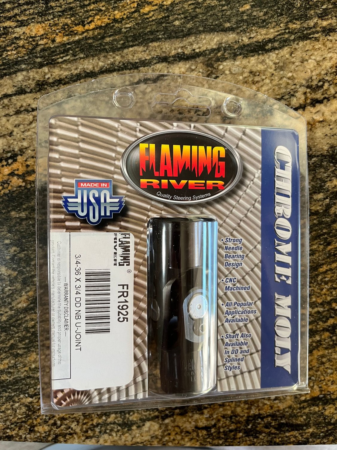

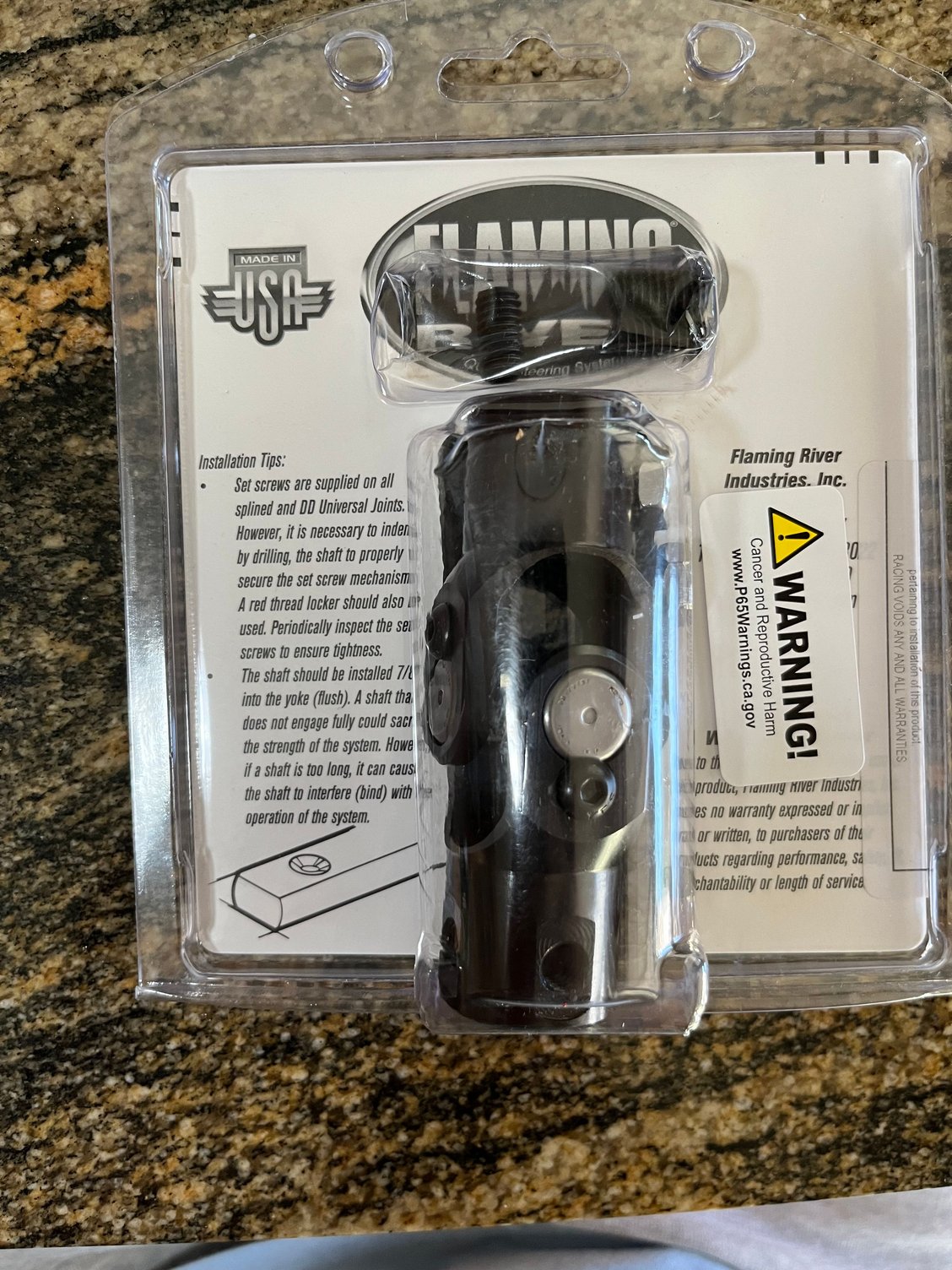

Here is the Flaming River chrome moly steering u joint I just purchased for my 73 from Summit Racing.
Gary rebuilt my steering box, but I replaced my oem steering column with a Ididit Retrofit steering column so if you are using an oem steering column the part number you need will be different.
