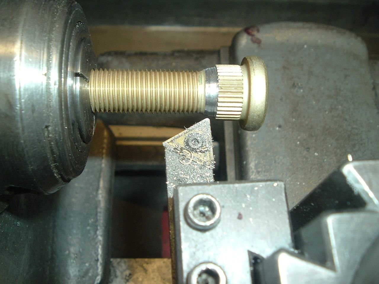

I machine ARP studs to size including the flange thickness to knurl. I don't know if you will find exactly what you want.

NOTE- these are 1/2-20 studs which I use in the 31 spline HD axles. Same procedure though for 7/16 studs
