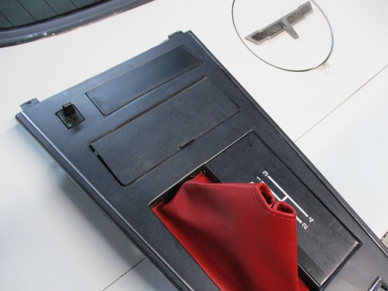

If you just want a button, that's easy. What do you want the button to do?
The function of a modern car with keyless entry and 1-button engine start is nigh impossible on a stock C3. You need an ECM to run the starter for the correct amount of time (modern cars do this even if you have a keyed ignition), and you'd need fuel injection instead of a carb with a choke.
The keys unlock the steering column Would you leave that unlocked, or still use a key to turn the car "ON'. At which point, you can put a button under the ash-tray flip-up, run it to a relay and power the starter solenoid that way. You'd still have to turn the car off with the key, unless you had a separate switch for IGN ON.
You can replace the 12V socket with a round switch, or the ash-tray with a rectangle that would take several switches/buttons. I've put a charge port in my car, and deleted the HVAC controls with a 3D-printed plate (no switches yet, but there's room for them). A stepped drill bit makes short work of plastic.
