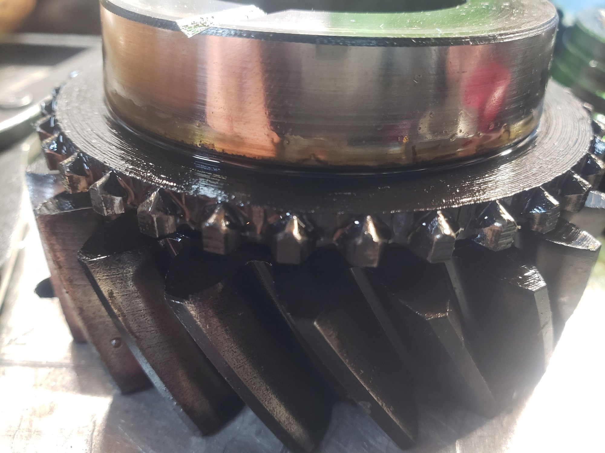

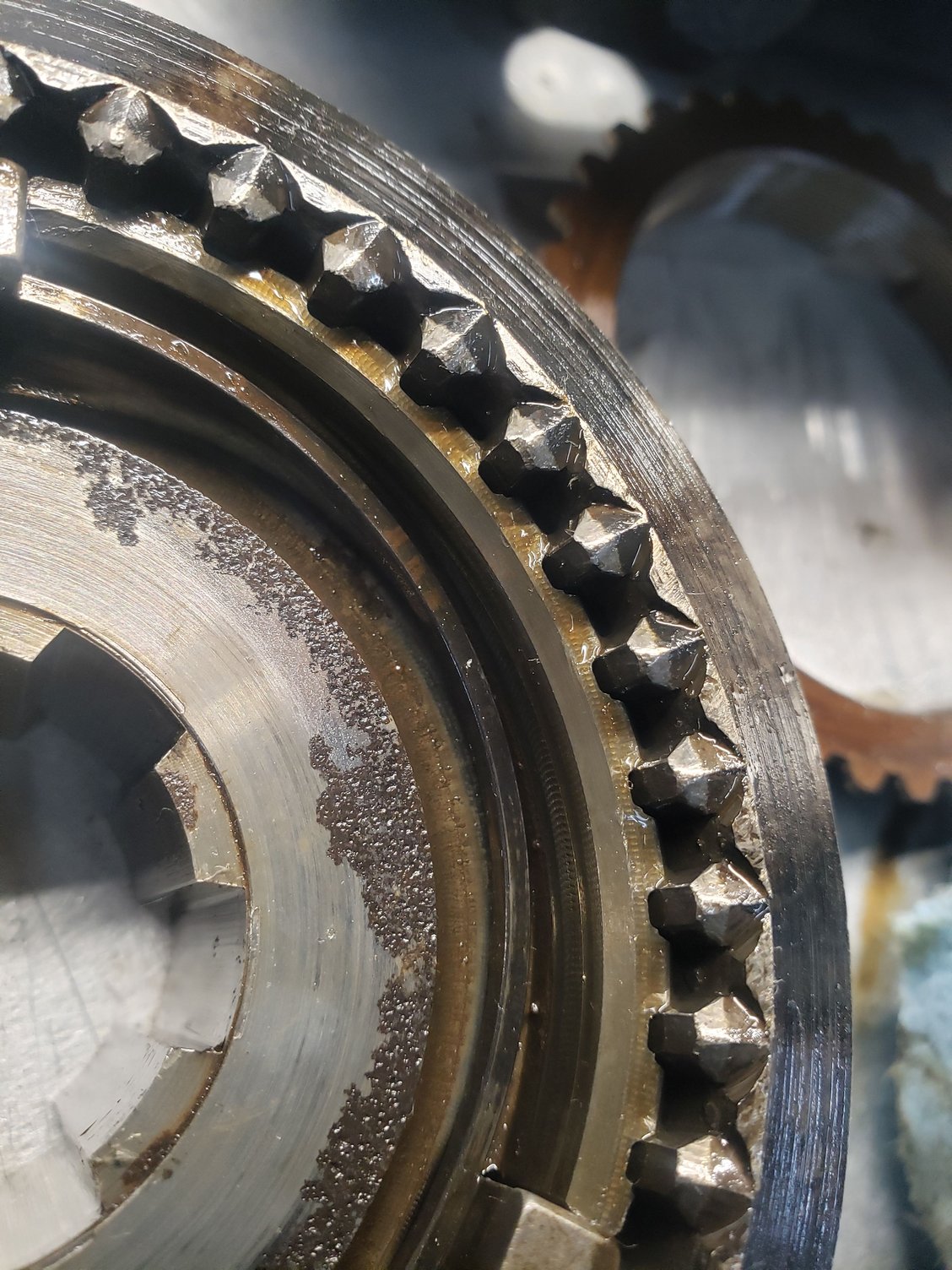

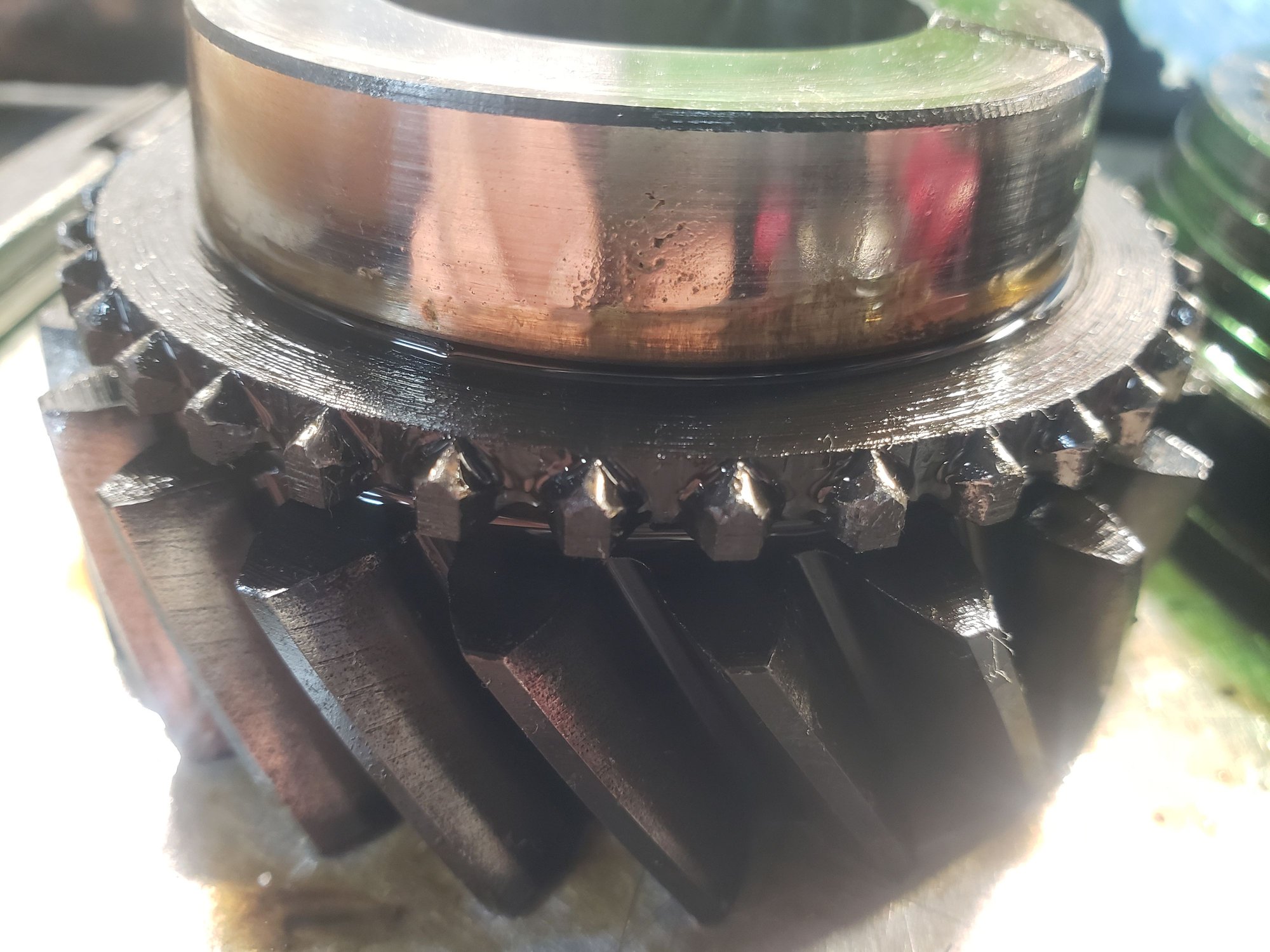

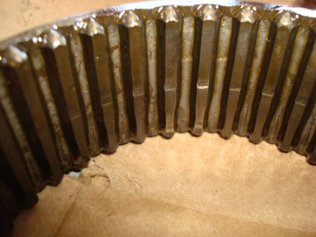

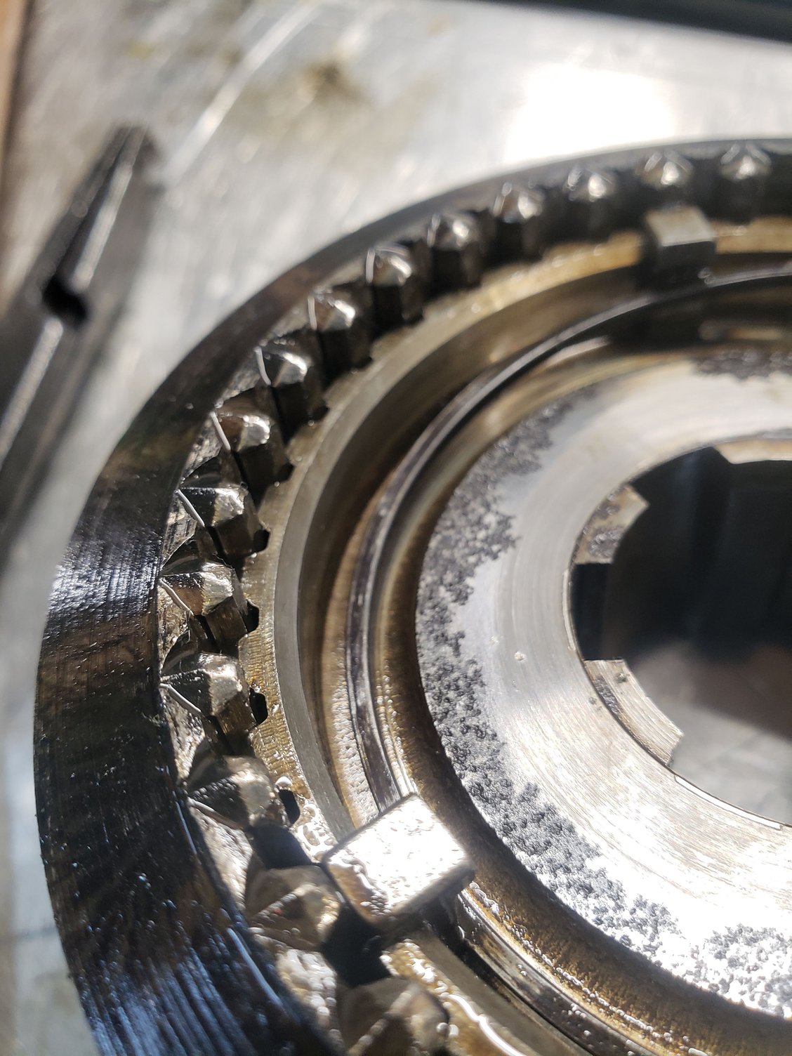

Here's some pics of my '75 L82's third gear and synchronizer hub. I was feeling sort of silly for tearing it apart until I saw these corners. Should I replace these parts, polish/ stone them down, or throw it back together like this?

Very worn slider. Splines are worn narrow on lower half. Causes popping out of gear when going on-off throttle, especially so in second gear.
You might want to examine the inside of the sliders especially the 1-2 (rearward) slider. If you see narrowing of the splines, you probably need to replace that piece. That said, your gears show normal expected wear. Probably not popping out of gear. No significant chipping on the clutch teeth. I would not replace that gear.

Gear and engagement teeth looks good to me too, make sure the synchro's don't turn when you apply pressure while trying to turn the synchro on/to the gear, they should grip the gear under pressure so the teeth can line up for a gear change , if they don't they will grind during a gear change , I've had some new synchros that were bad so always check , even new parts

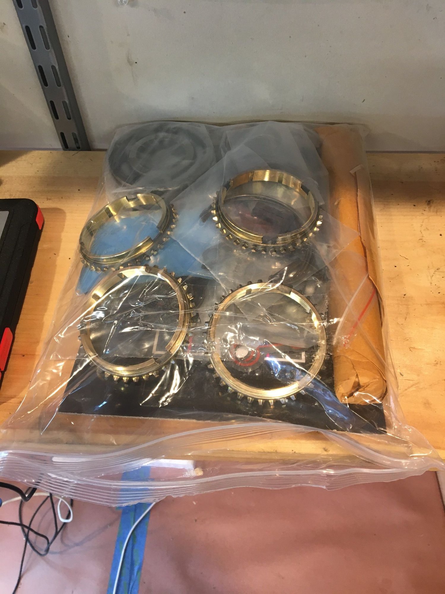

Alright, got 'er all torn down, Got some neato stuff on order, due here Thursday. I've got a few tasks lined out, including chamfering the edge of the gears and all the other neat stuff that @5speeds has in his videos, fitting synchronizers, burnishing them in (I presume that involves valve grinding compound..), I'll be drilling the mid plate for ventilation, etc. Now I'm looking at the synchro hubs and wondering if it's worth another $160 to replace them so it's never an issue, or am I overthinking this? I'm a machinist that works on a tiny little world, and I sometimes don't know if I'm overkilling it. I'm planning on "bulletproof", but I'm also a very occasional doofus with the gears, and an aspiring road racer (Corvette museum / track is about an hour away). Looking for experienced opinions with longevity on these hubs; in the past, I would have just drained and refilled this trans. Thanks again, guys.

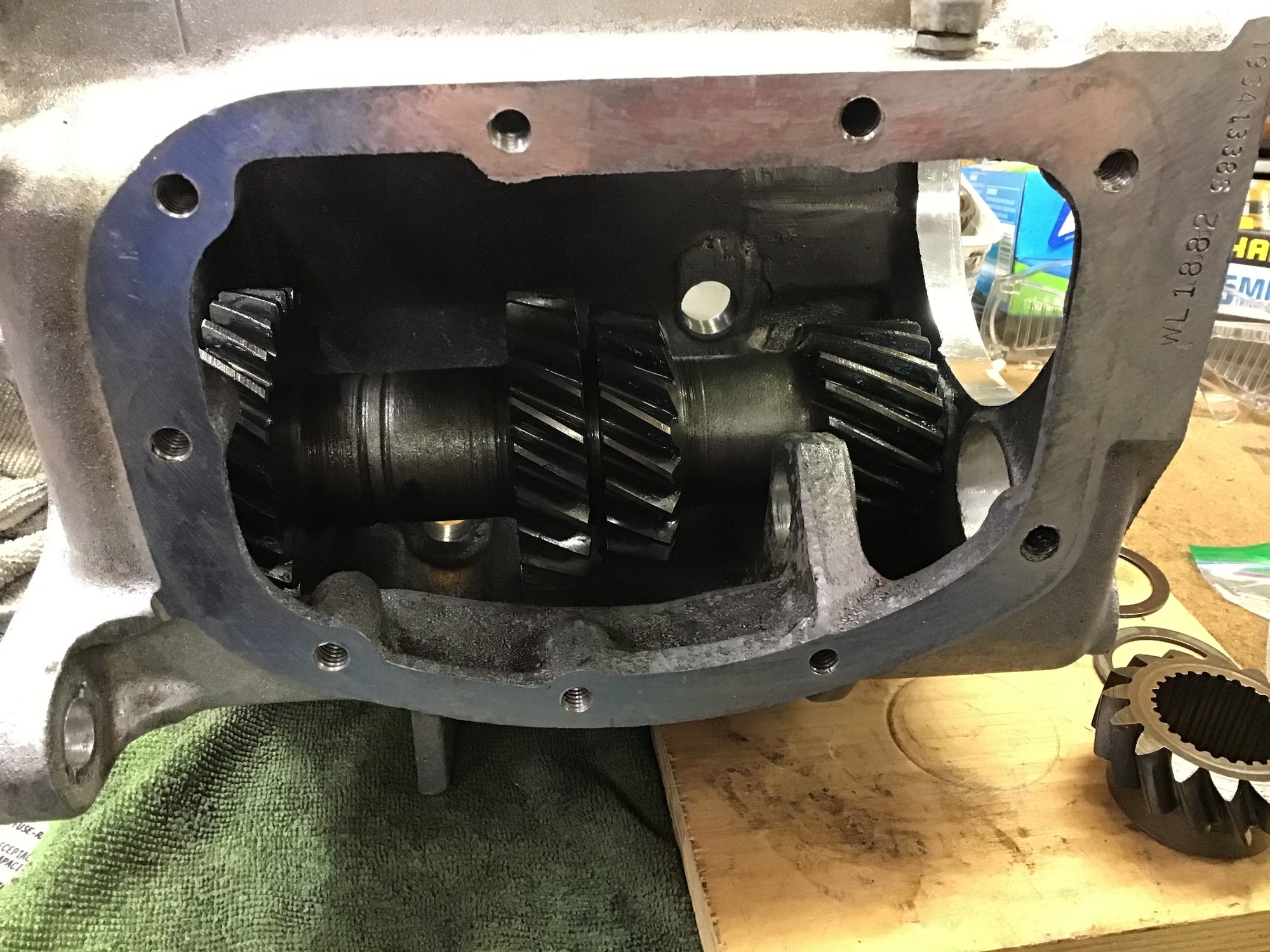

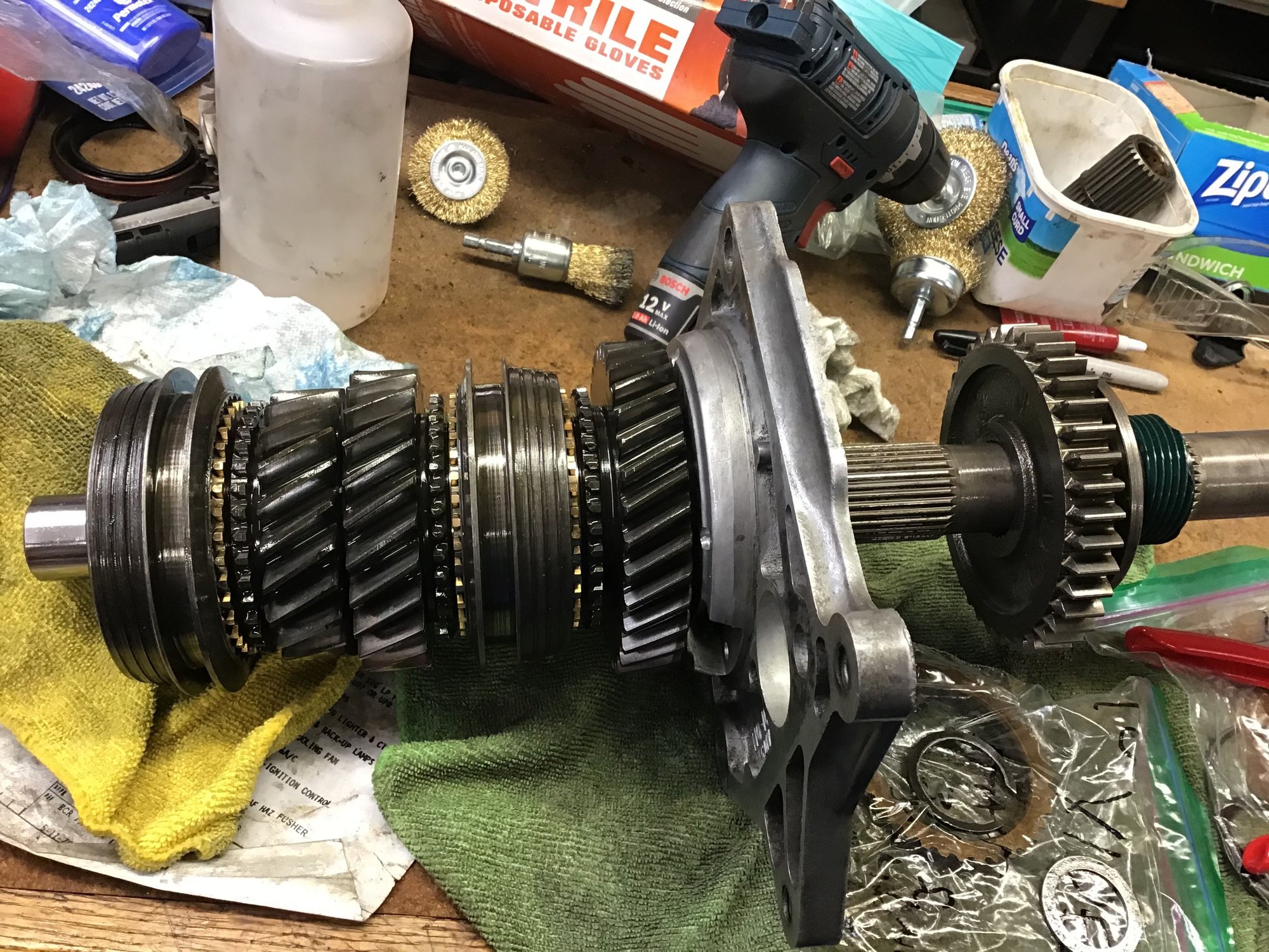

Don Elliot's T10 video is awesome as well! Some great info...you can never have too much information.
Made a quick tool to install the side cover seals:
Here's the idea. Not too complicated. I hate putting these seals in, I used to tear one up about every time.
And, there you have it:
Ground flats on the first gear bushing for oil flow:
Torque lock sliders from The Gear Box:
Billet mid plate (wasn't able to find a steel one) with vent holes drilled and sealed bearing installed:
Packing needled bearings in the counter gear. Dan Elliot recommends Vaseline to pack these so it breaks down instead of causing the oil flow to be clogged up:
All the stuff together:
Money shot:
Everything seems to work..turns quieter and much smoother than before. Some things to note, I had to run the thicker thrust washer on the reverse idler gear in the tail shaft end or it was going to hit 1st gear. Also, had to run two gaskets on the aftermarket front bearing retainer or it bound the transmission up. Besides that, everything went pretty well. Next up, replacing the clutch, pressure plate and flywheel.
