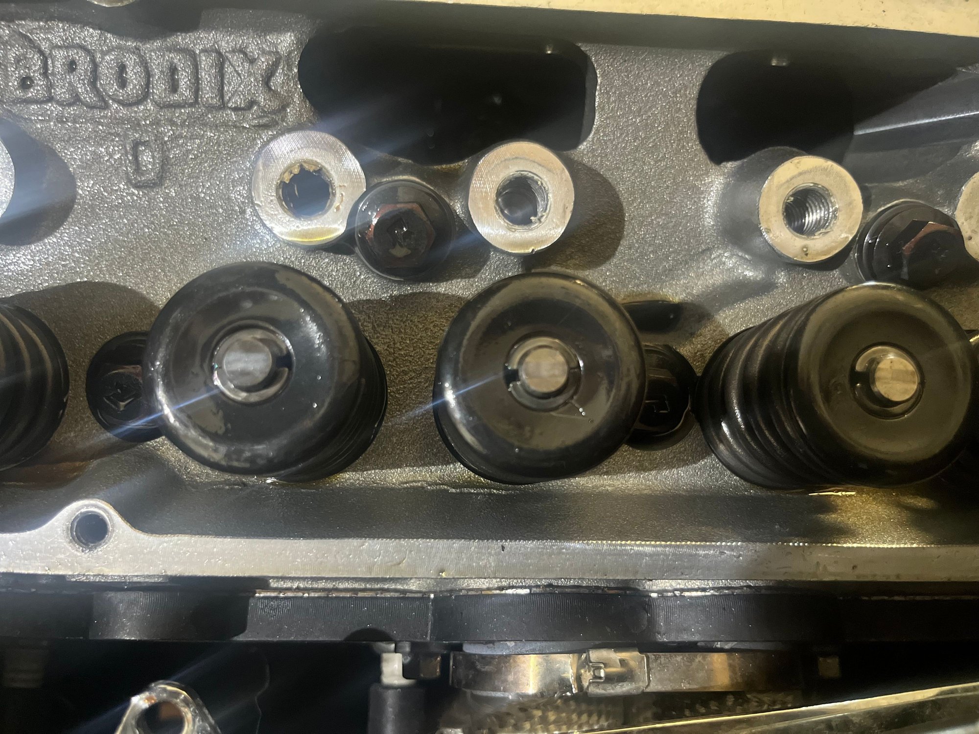

How about a pic of the valve stem tips. Would be good to see the wear pattern.
Here is a pic of the wear pattern. Looks like it's centered.

I agree. The wear pattern looks good. Perhaps new pushrods and rocker arms will fix it.

Your ware pattern is nice. But do you know if the springs are made to do the additional lift od the 1.6 ratio? They do make hardened tip push rods

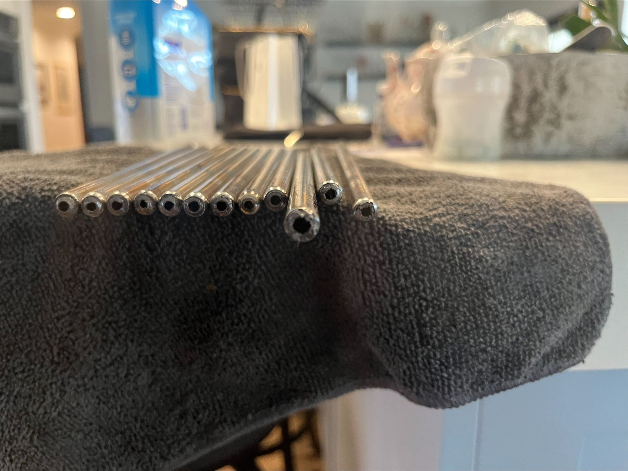

That wasnt making a clattering noise?......it looks like you snapped the ball ends off all the rods, they look so jagged. If you havent ordered new rockers yet consider 1.6 rockers since you need new rods anyway, just measure everything first with a rod checker and checking springs.
Any pics of good rods...both ends

My rockers were 1.6 so that is probably why the stock push rods were the correct length since the wear pattern on valve stems looks like its right in the center.

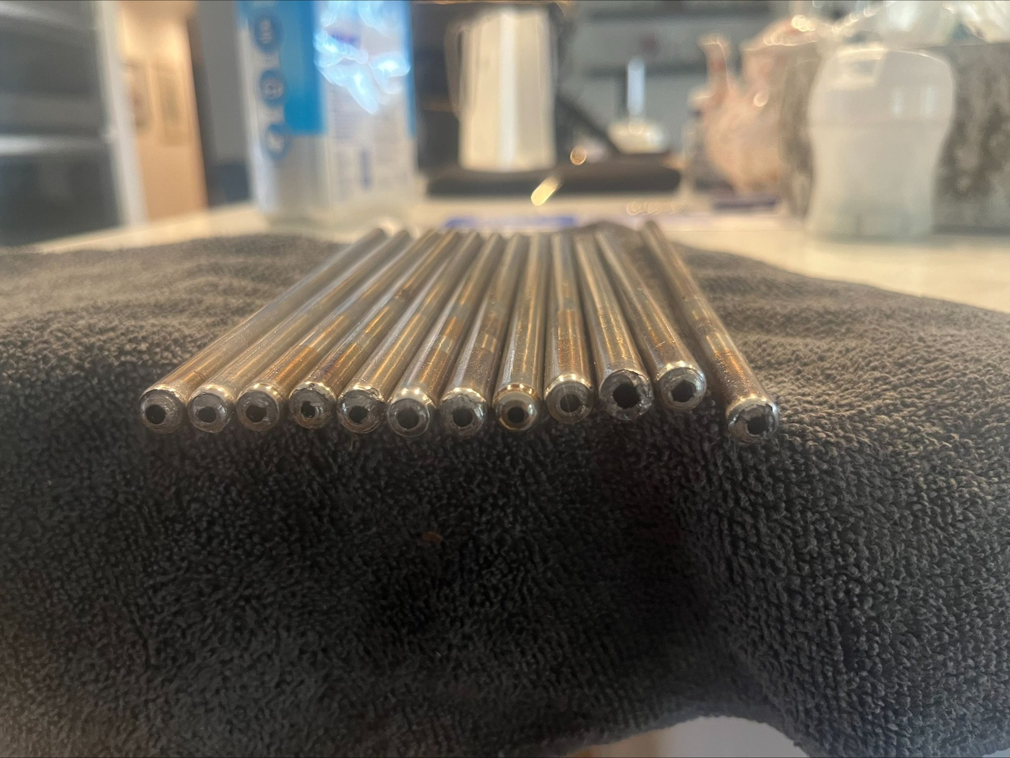

The pushrod damage occured on the rocker side of the rods but I do see the lifter ends of the pushrods are also starting to show wear.
I don't think the stock pushrods were able to put up with the pressure of springs. The springs that came with the heads were CC981's. They have 100 lb Closed, 300 lb Open with 1.850 Installed Height, and .525 Maximum Lift. My lift with the 268H cam is .512 (with 1.6 ratio rocker) so I think CC told me by open pressure was around 280lbs. That may have been too much for the stock pushrods, especially since they aren't hardened. The rocker cups are pretty beat up as well so those are going to be replaced by full rockers. I had roller tips,.

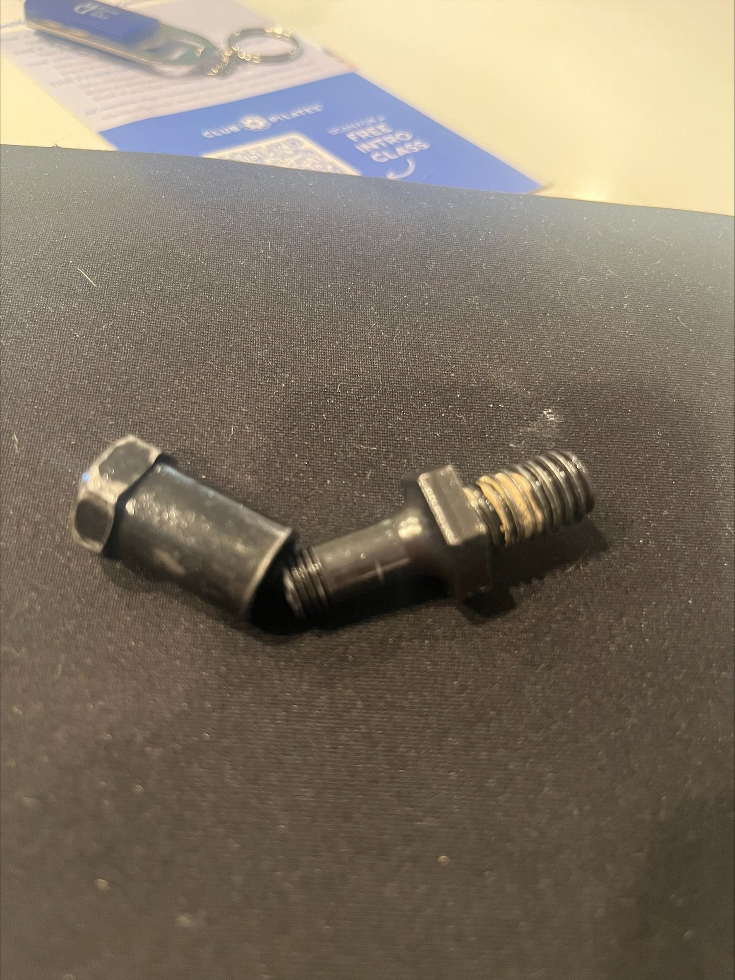

The strange thing is I discovered this issue when one of my rocker studs snapped off causing engine not to run well probably becuase rocker came off vave as a result of the pushrod damage. A minute before that rocker stud broke the engine was running perfectly and I assume the damage to the pushrods was already there.
I'm adding picture of the lifter end of the rods, the rocker cup and busted stud as an example.
Here is busted stud. It broke where the rocker pivoted. I assuming the ROD was damaged causing the lash to increase to the point where the roker tip came off the valve putting sideways pressure on that stud.
If you zoom in you can see the damage to the rocker cup
The rods ends on the lifter side show that they are starting to fail as well but no where near as bad on opposite end that was pushing rockers.
