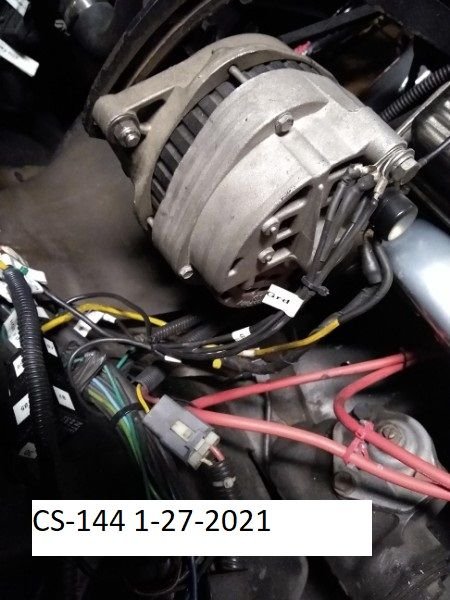

Show us a picture. I have a 140-amp cs-144 on my 68 but I also have heads with forward facing holes.
