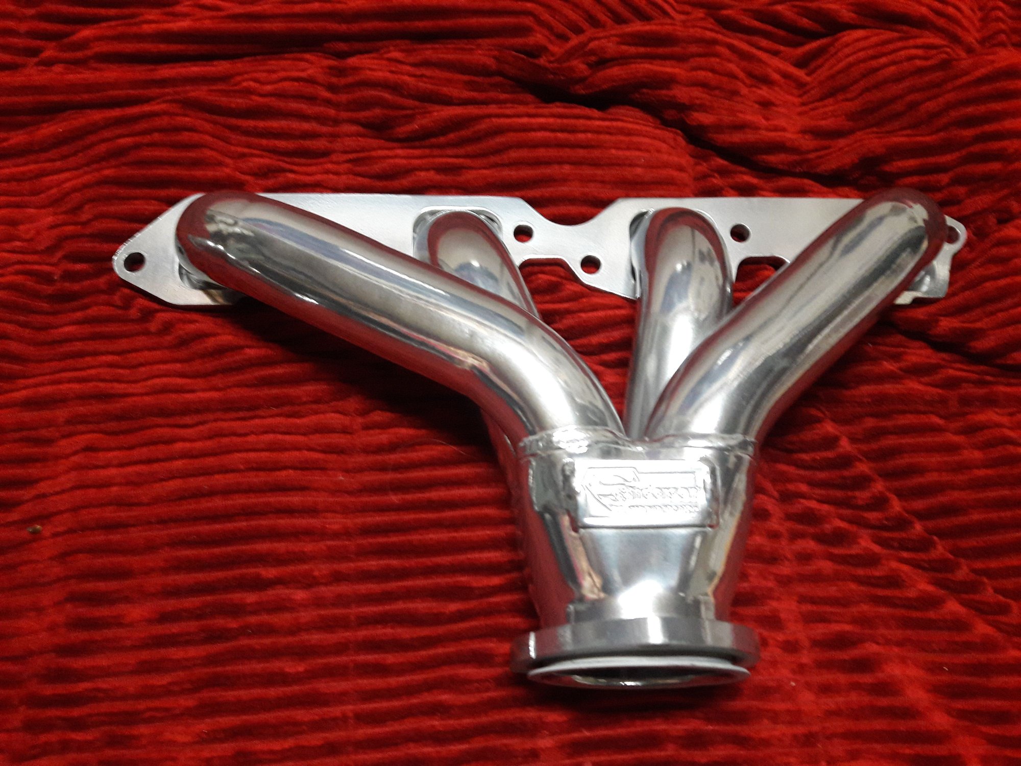

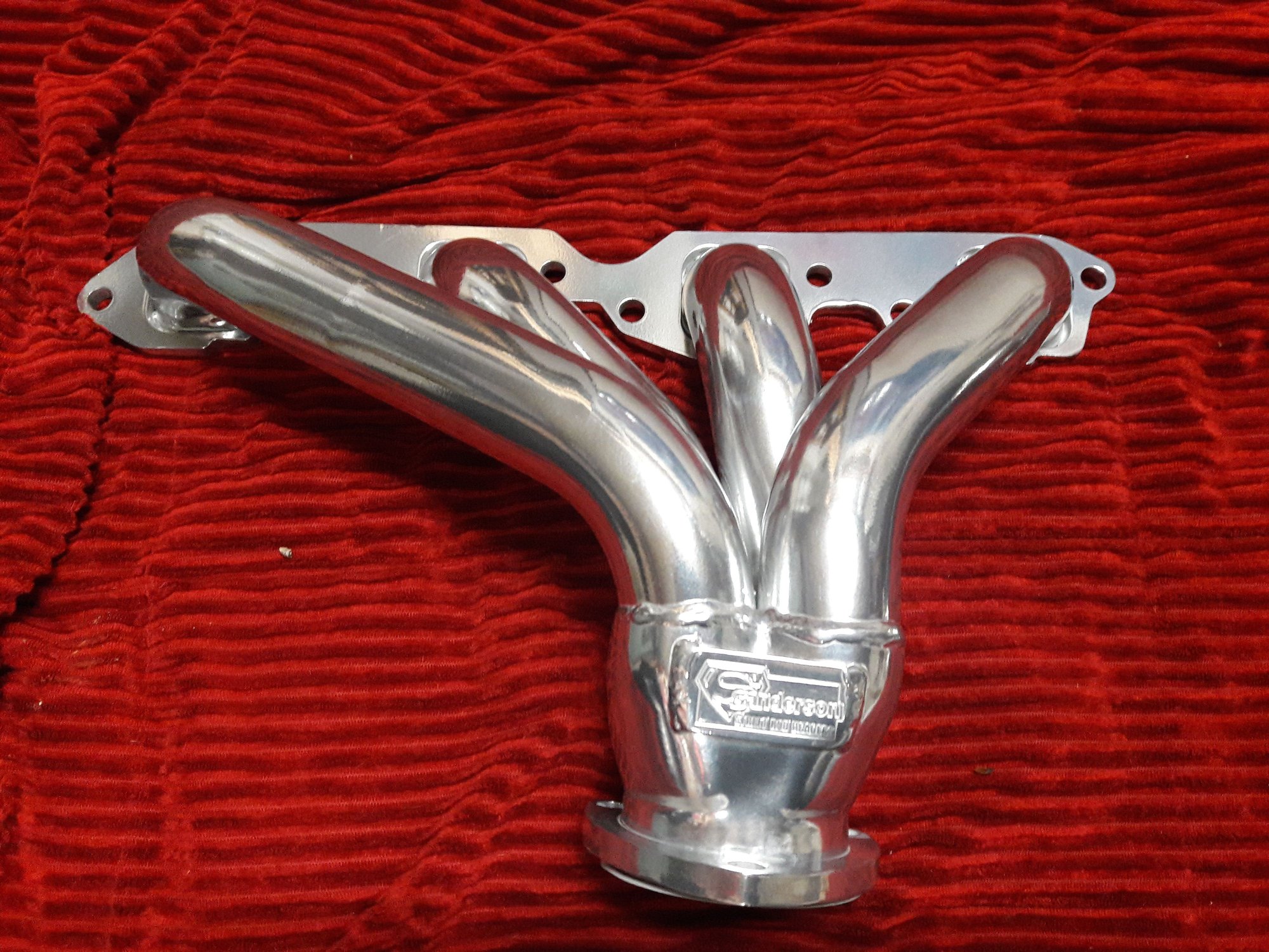

Here is the dyno run sheet performed by Chevy Action Magazine where they compared their short tube headers to long tube headers on the same 433 cu in big block engine.
You would be surprised at the results from 3000 to around 5000 rpm.
To read more look at there Header Tech section of their web site.
Sanderson’s have been one of the best quality headers on the market for the past 50 years.
I would run them on your big block over the stock manifolds in a nano second.
They will perform better, sound better, look 100% better and save a ton of weight, being that they only weigh 16 lbs.
There will always be some people who disagree, but are they providing dyno sheets as proof or just talking trash.
The Sanderson Short Tube headers I purchased for my 496.
