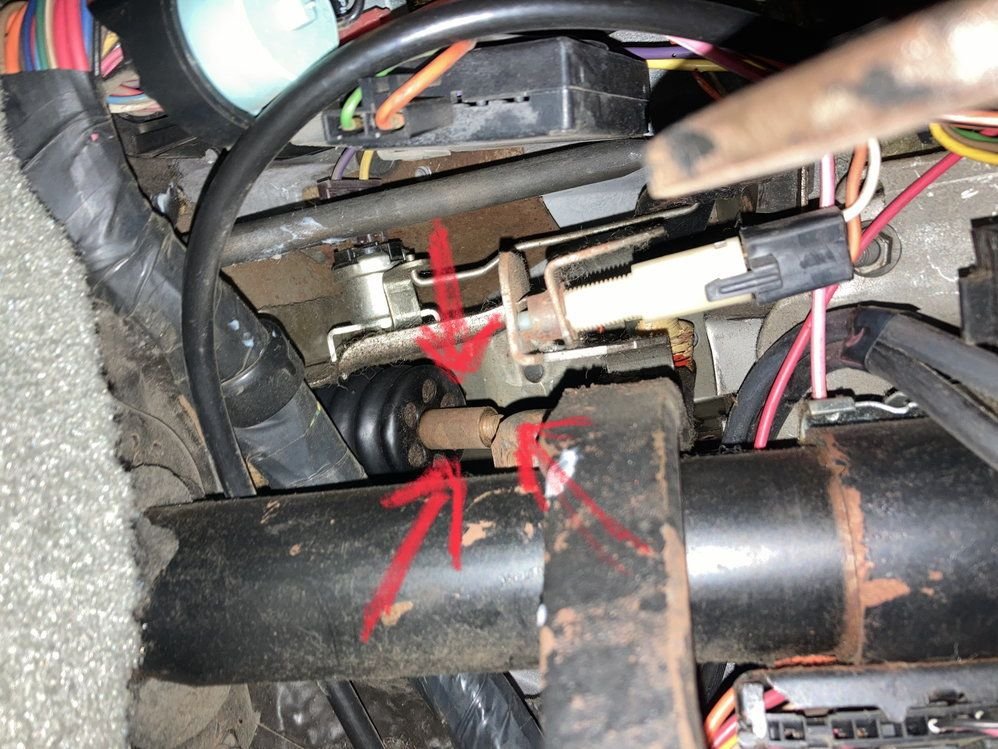

OP…while waiting look and check carefully on a 79 at brake clevis so this does not happen in link below… shocking how that was designed.
https://www.corvetteforum.com/forums...ying-79-a.html

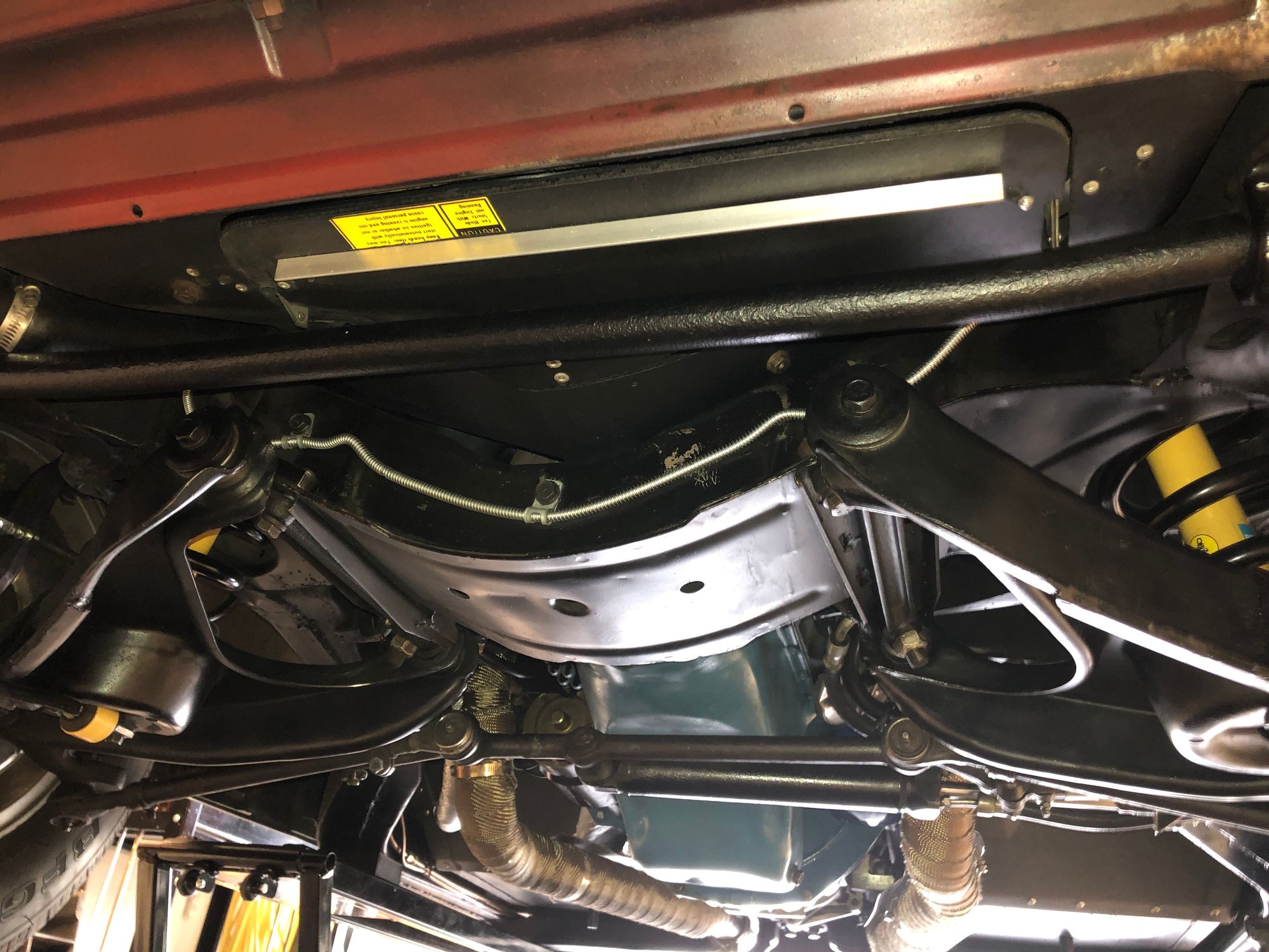

i also had to replace my front line, they leak if you remove and install many times.
A chance to clean up when replacing brake line. I got steel from vendor zip..great fit with coils too.
